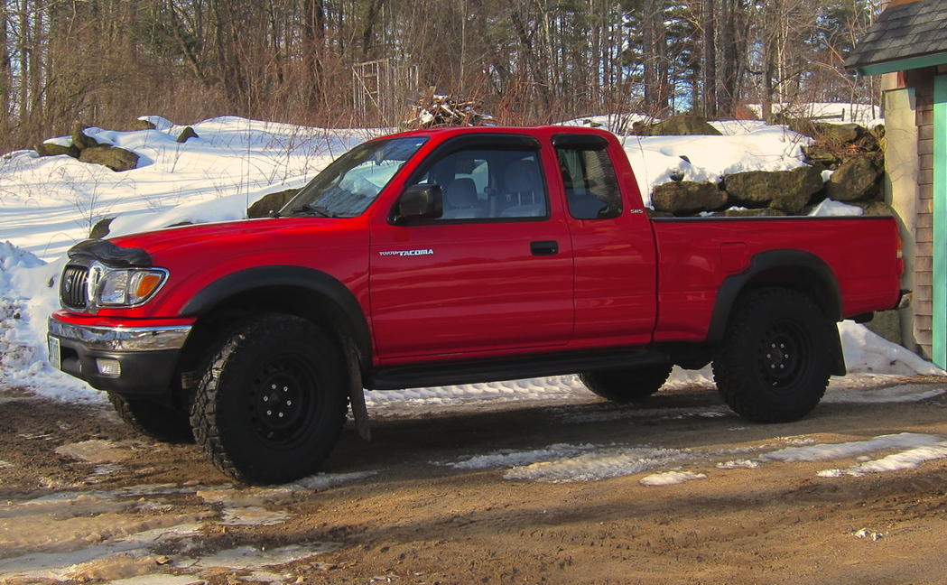

latest mod ...
Complete new set of lug nuts ! :bigok:
