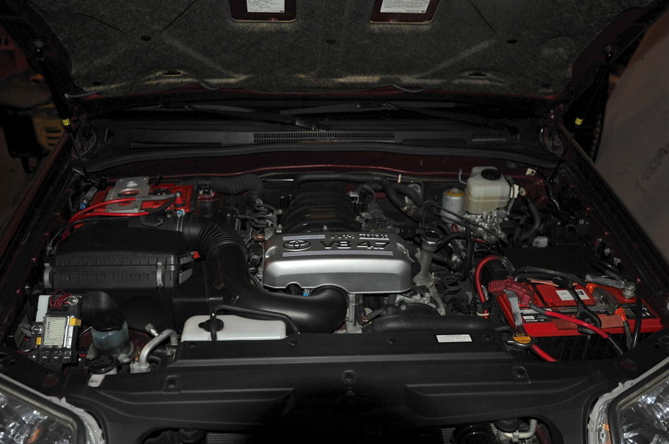

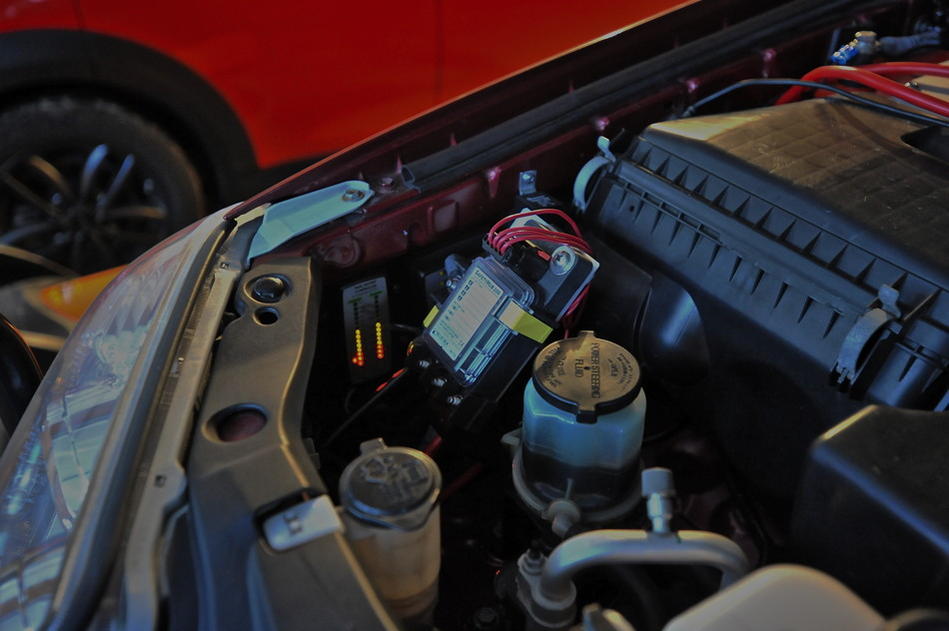

Dual Battery set-up using a National Luna Isolation controller. I swapped the 85 amp solenoid for a 200 amp. The solenoid is behind the fuse box in the picture, just to the right of the battery monitor display. Installed a high output alternator to handle the load of the winch at near full draw. The winch draws over 400 amps at full load, the alternator will put out ~ 170 amps at idle and ~ 300 amps hot at 2000 rpm. I think I got the electrical part of this covered ...

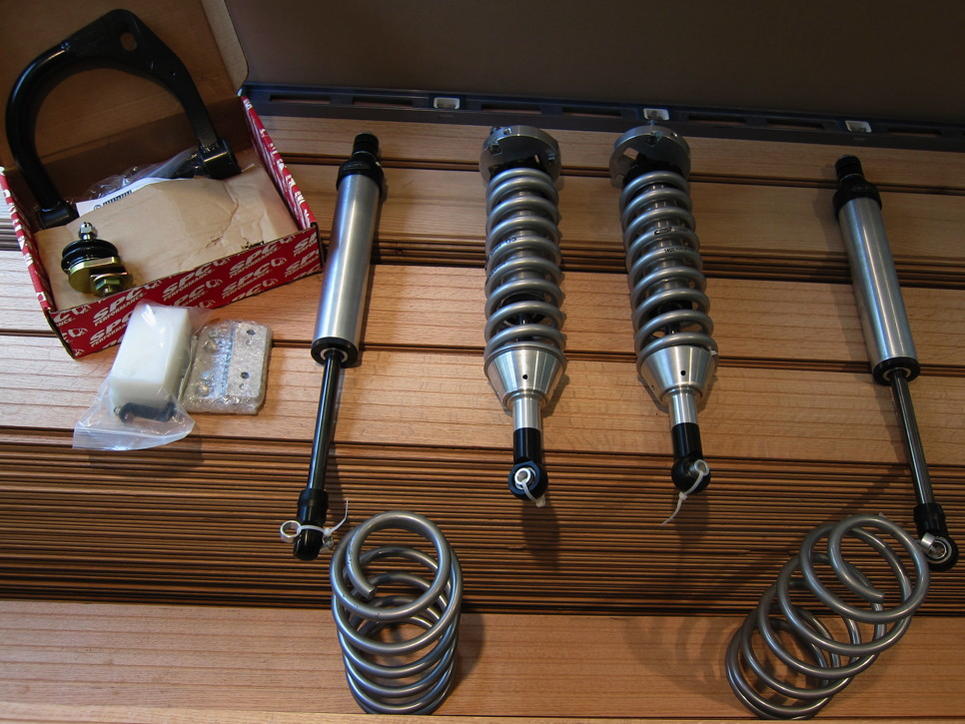

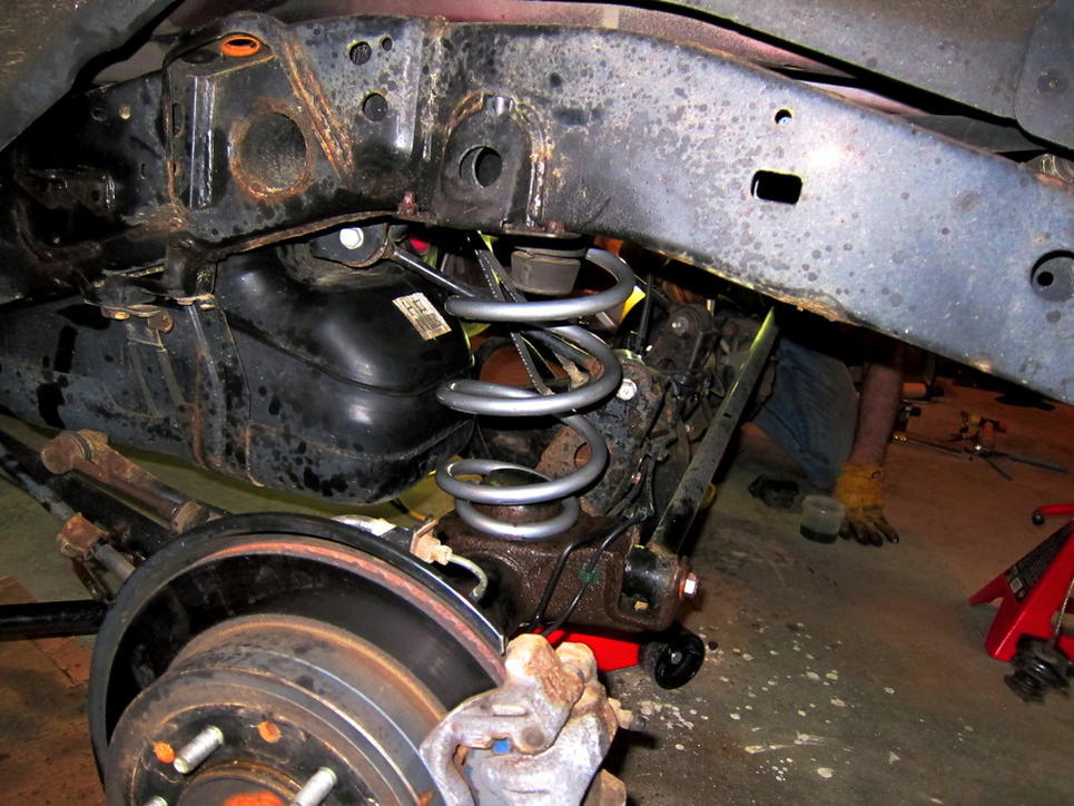

Suspension

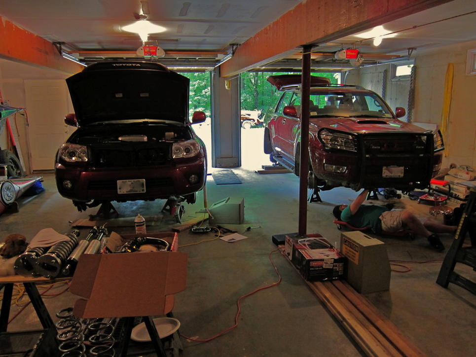

Probably one of the last complete Overland Warehouse 2.5 extended travel kits sold before closing their doors; Mark and Andries are still around though.
Install day !
Rear driver
I have really enjoyed this set-up so far. I have no spacers aside from what is built in to the front CO's, no body lift and I'm currently running 33's with no rubbing issues lock to lock. The handling is very tight, the ride is stiff but not overly so with the weight I am carrying. No complaints from passengers to date.
I am considering what to do to get another 1 ~ 1.5 inches of additional clearance as I take on more technical stuff but so far this set-up is handling the granite pretty well.

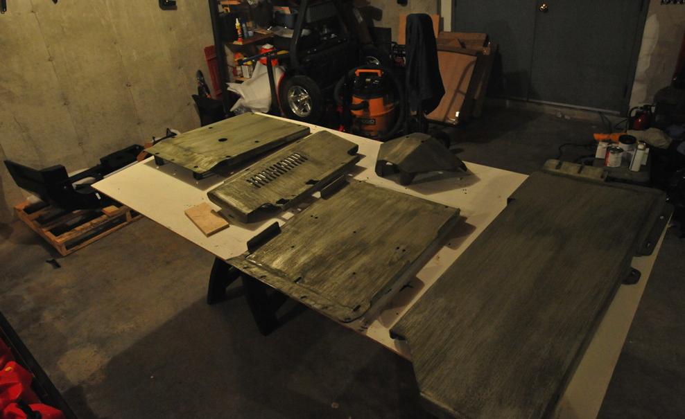

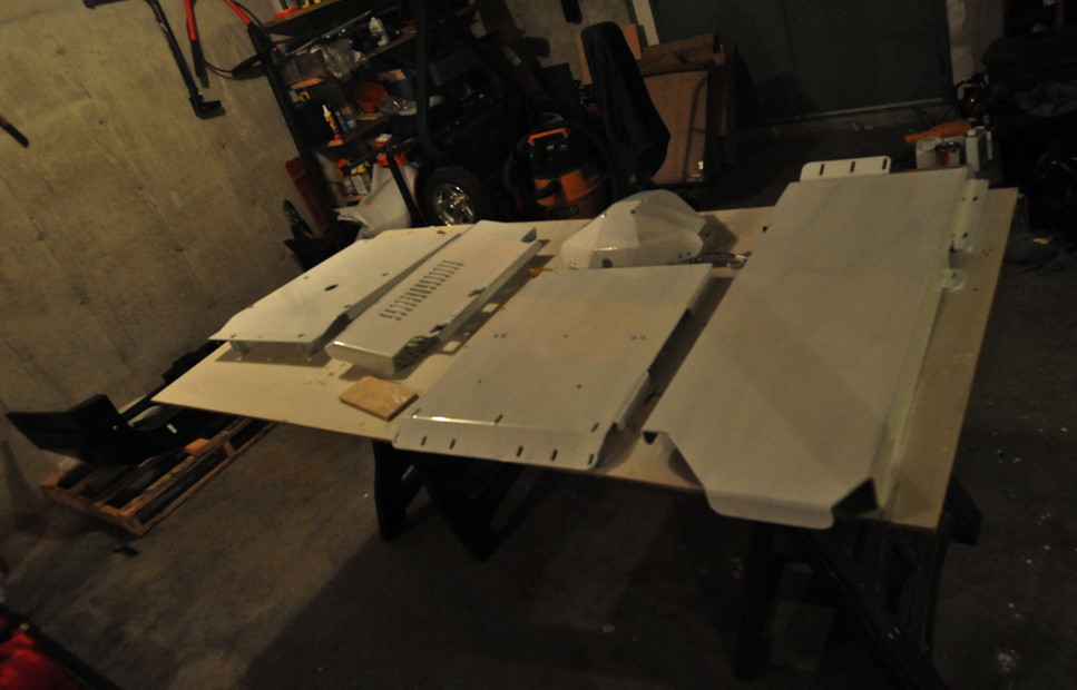

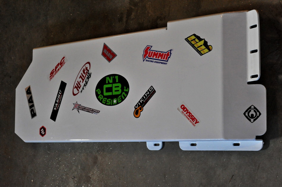

Aluminum BudBuilts from front to back with stainless rear diff skid and the aluminum gas tank skid. I won't say that installing that gear was easy but the fit of the equipment was near flawless. I did a fair bit of filing to remove all the sharp edges from every skid section so it would be more pleasant to go back under there to work. I used stainless nuts and bolts through out.
I had to use a special primer for the aluminum and then top coated using a can of two part urethane marine paint that I needed to use up. Perfect color for the underside: "Snow White" !
Not much for a lot of stickers so I figured I would give 'em all equal time on the underside...

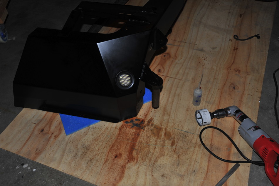

Bumpers:

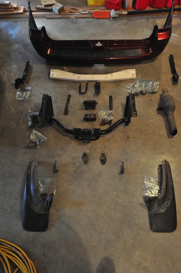

These are all the parts I removed to install the rear bumper:

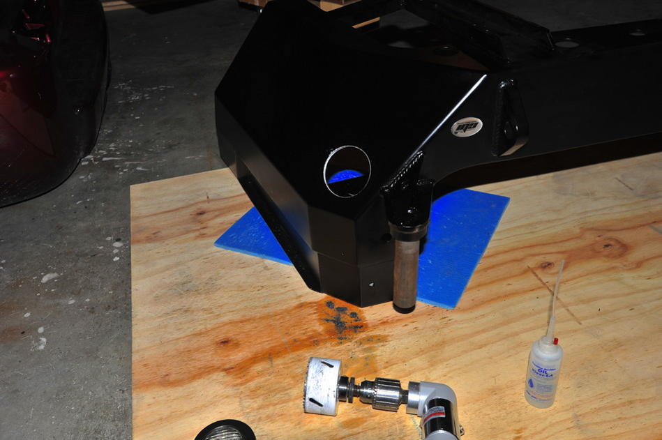

Added lights in the corners to illuminate close in:

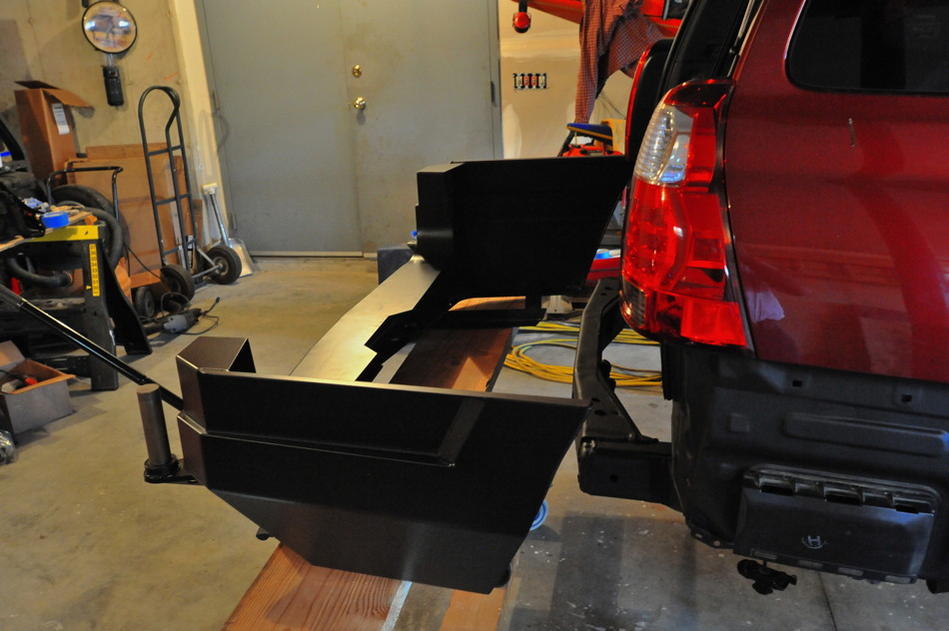

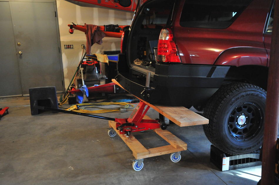

Used a floor jack with a 2 x 12 on it to move the bumper around and get it in place:
I used the OEM tow hitch bolts to mount the receiver as they were rated 11 and in great shape. The CBI rear bumper is a rugged piece of steel fabrication. It is not as strong overall as the Shrockworks front bumper but then I am rarely doing 65 mph in reverse. I feel I have great strength up front where I am most likely to need it and more than adequate strength in the back. The CBI is very well made and fits/installs really well. The swing out is well designed and operates smoothly without any play what-so-ever.
I used the Shrockworks sliders since I was able to get a great deal on a group buy. They do not extend out quite as far as I would like and I worried that they would not protect the body as well as needed from the granite. At this point, they are pretty scratched up and so far, no damage to body. Install is here: http://www.toyota-4runner.org/4th-gen-t4rs/116626-install-shrockworks-slider-yourself.html
I used the Shrockworks front bumper. Got a good deal that became a great deal when it took over 4 months to get mine. Excellent customer service and this bumper is really well made and installed without too many "therapeutic exclamations." The hella marker lights are crap so I would order with the openings for them but then use Amber LED Dualies: Pacific Dualies 30100 2 Inch Amber LED Side Marker Round Kit : Amazon.com : Automotive for the lights. The Hellas that came with my bumper both filled up with water shortly after installation.
As an indication of how rugged these Shrockworks bumpers are, I compared the recovery points on the Shrockworks vs the CBI; the 1" thick Shrockworks recovery points pass through a cut out in the face of the bumper and are welded on both the front and the back side of the bumper face. The CBI recovery points are face welded only which may be strong enough but stronger is better when it comes to recovery points in my opinion. The CBI towing receiver is bombproof and that is going to be your primary recovery point on the back side.

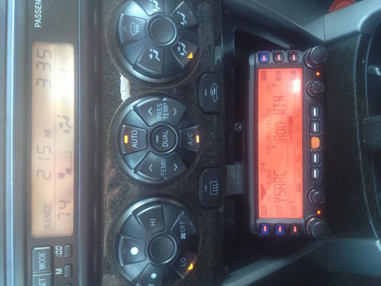

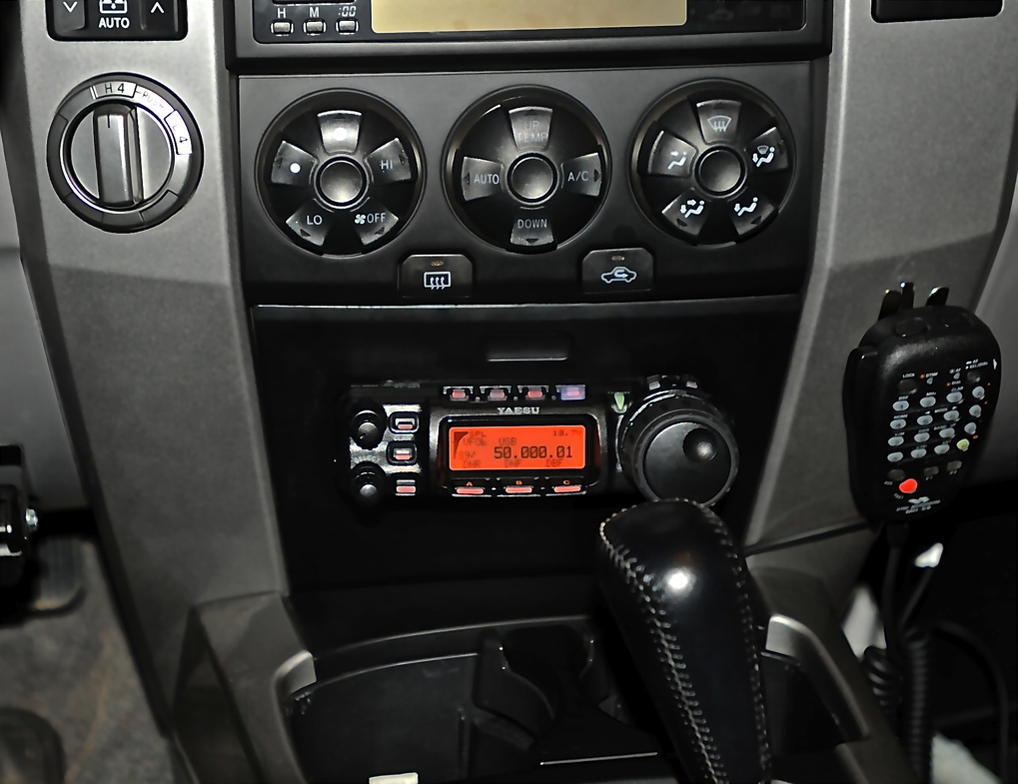

There isn't a lot of extra room in the cockpit of these rigs so I installed a ham radio that I am hoping will satisfy all needs reasonably well. I went with the Yeasu 857 for its compact size, performance and features. There is a lot of used Ham equipment out there and these aren't hard to find. Normally, the Ham radios do not operate on the 11 meter band (CB frequencies) but they are easily modified to do so although it is not technically legal to operate this way unless you can limit your transmit power to 5w or less. This radio will let you do that with some custom programming. I am limited in which channels I can access easily though so its certainly not as easy to use as a stand-alone CB. That said, my communication capabilities are vastly more than any stand-alone CB.

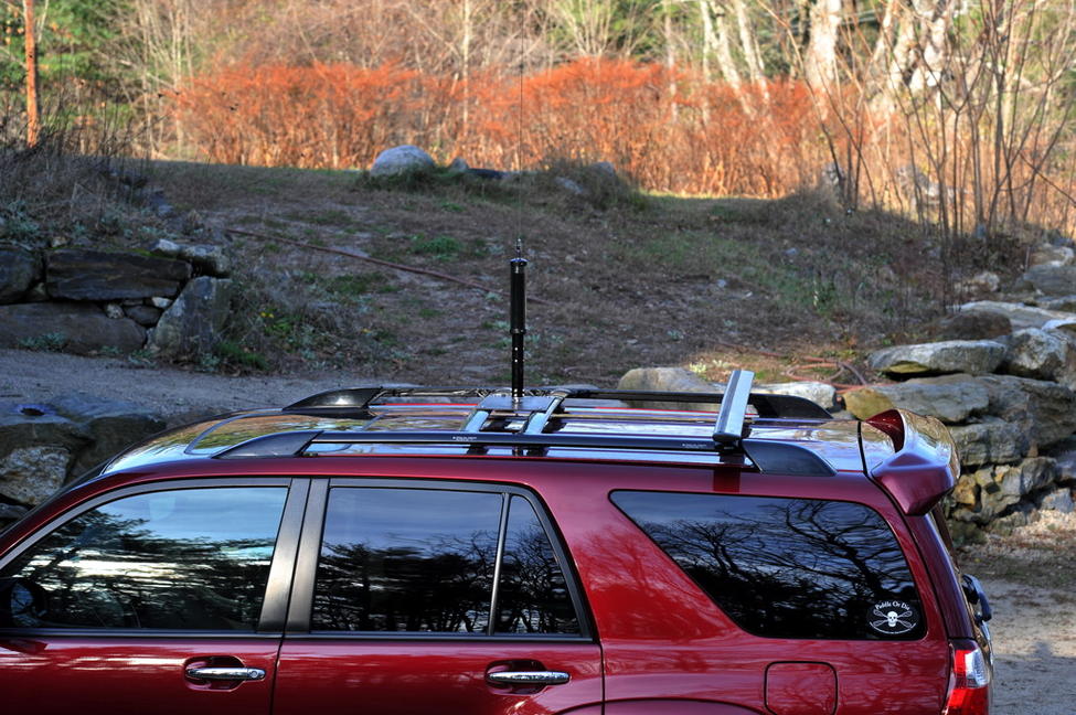

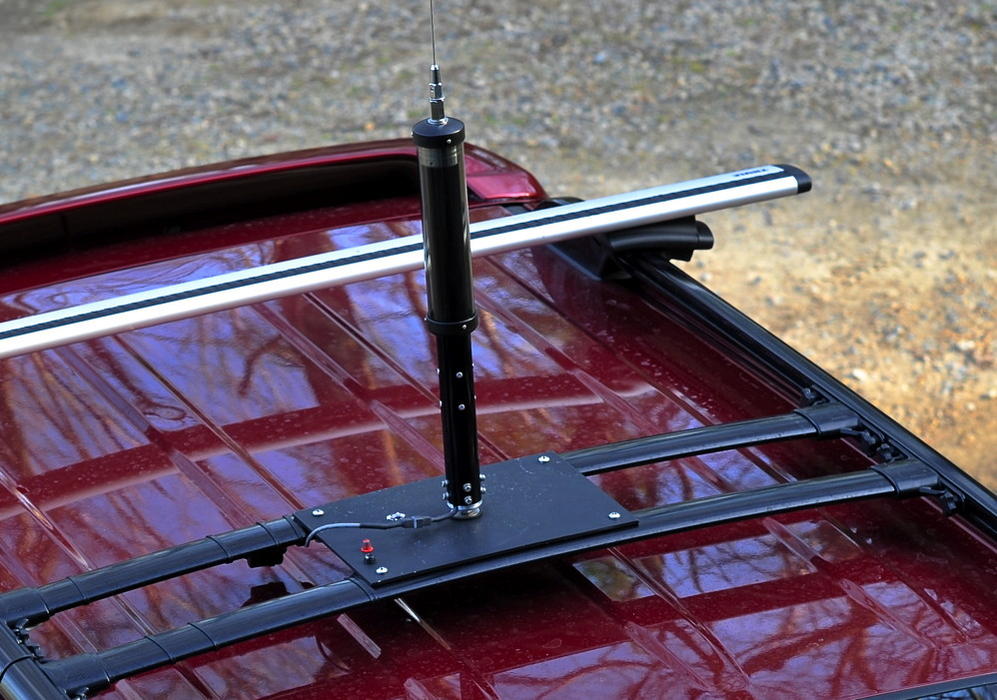

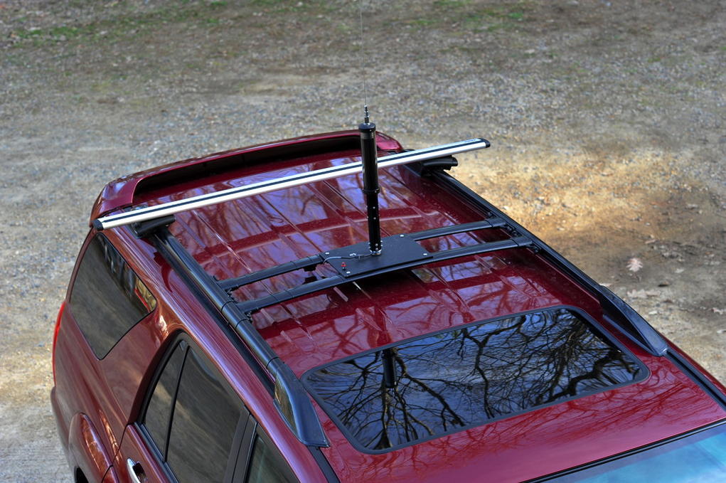

I wanted to install the antenna to get maximum performance and be out of the way. The center of the roof is the ideal location on a vehicle for a variety of reasons. It can be at risk in the woods though so a spring mount is advisable. The antenna is easily removed by unscrewing it and I can throw a Firestick up there when I will only be using the CB channels.
I used a small piece of aluminum plate that a got for free from a local machine shop and then fitted it to the OEM cross bars. I use the heavy duty Thule cross bars to mount the kayak racks on so the OEM racks were perfect to create a solid base. This saved me from drilling a hole in the roof also which I did not want to do.
Modified the door of the center storage pocket to accept the Yeasu face plate. Unintended consequences: the most useful cup holders in the vehicle are now poorly suitable for large (to go) coffee cups.

Love the way you have your FT-857 mounted! I bought an FTM-350AR and mounted it very similar. I wound up removing the door altogether though. I made a custom bracket out of sheetmetal to hold it all in place. Here's a pic if you're interested! Taken with an iPhone, so quality is as per usual.
