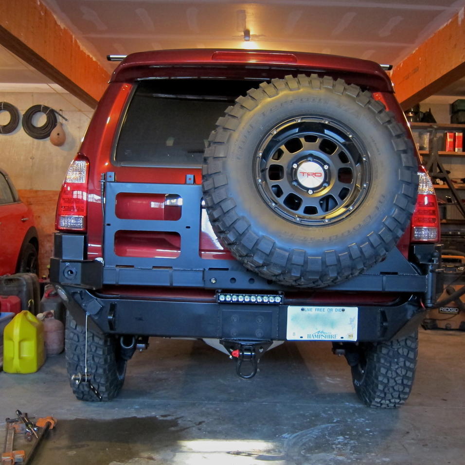

Going backwards ...

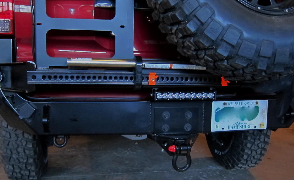

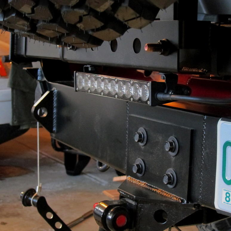

I never feel like I have adequate lighting behind me especially when backing up. Hopefully, I've taken care of that with this 10" LED bar.
Setting it up on a separate switch so I can use it anytime.
The HiLift does not interfere with it.
Pics at night to follow.

Nice! It's just the perfect size. I look forward to seeing the night pics as well. Mind taking some with and without it in the same location?

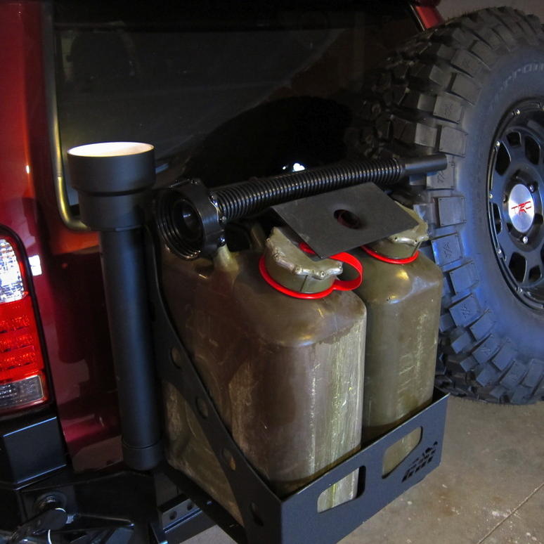

Fuel filler holder

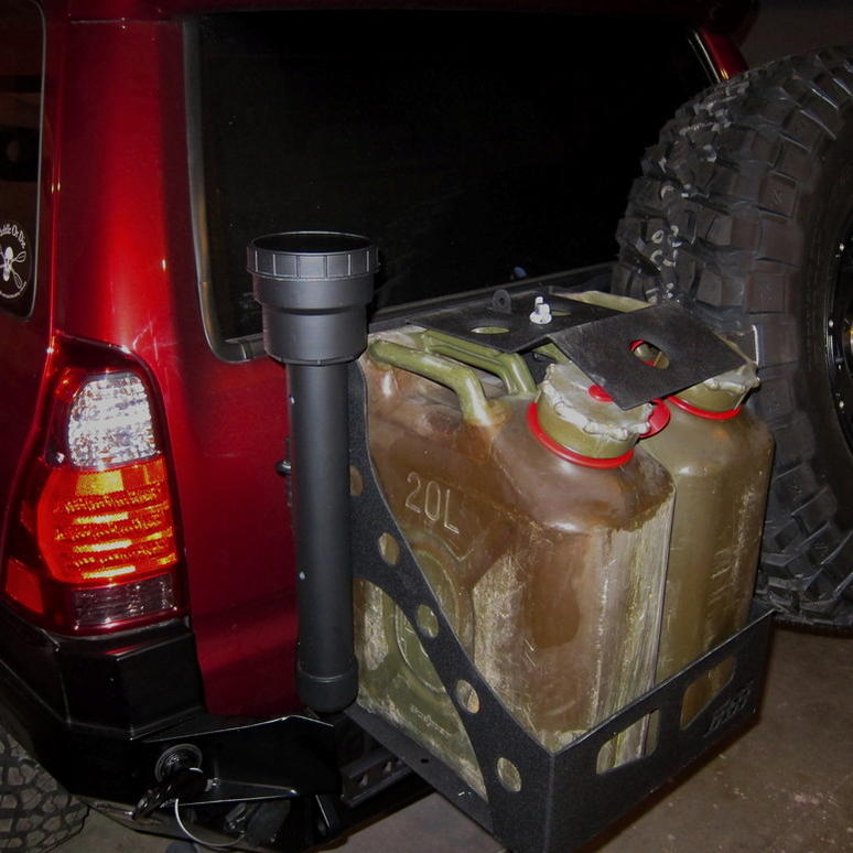

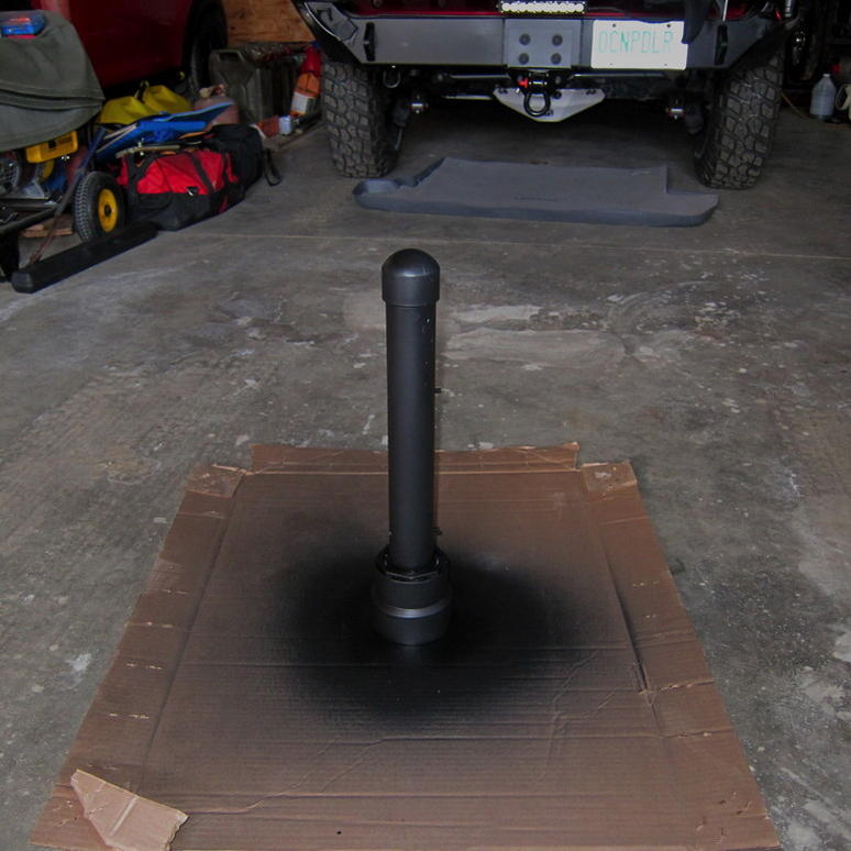

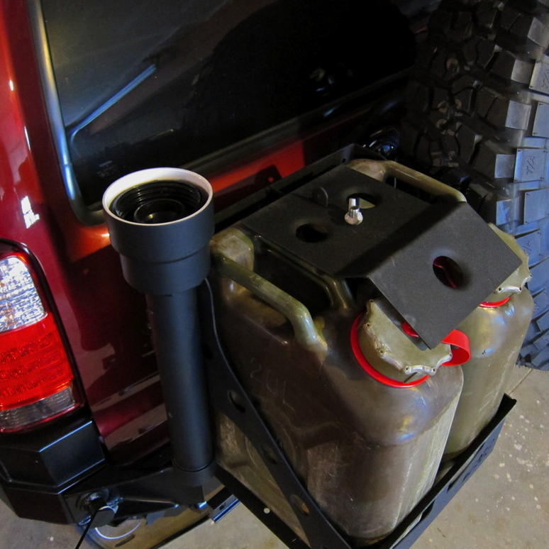

Needed a place to carry the fuel filler nozzle but also needed it to be outside the vehicle and protected.
Used a few pieces of sched-40 PVC pipe and then attached it to the fuel carrier in what seems like a pretty protected spot.

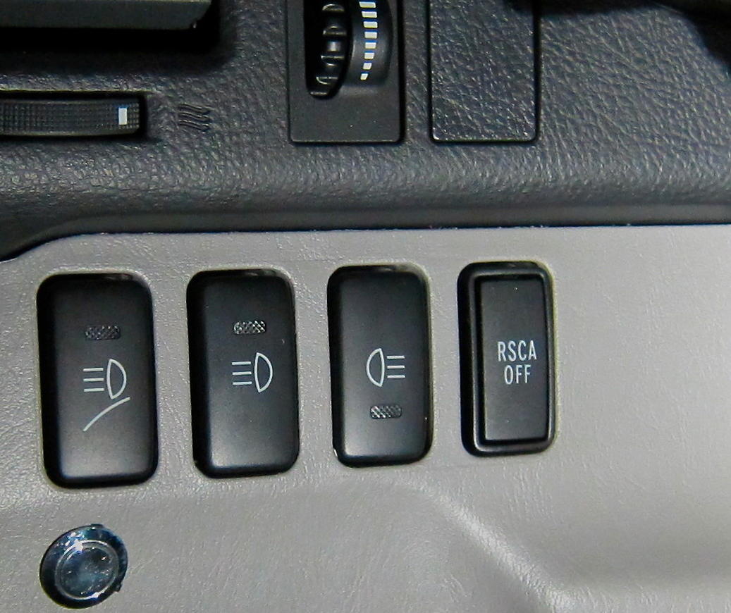

Moving switches

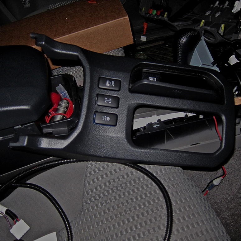

I wanted all my accessory lighting switches on the dash where the risk of accidental activation would be minimized. In my quest to maintain a stock appearance, i decided to move the Center differential lock and the VSC switches to the center console so all the lighting switches could be positioned in a way that made sense to me.
I can find these by feel and activate or deactivate as needed now.
The new location for the Center Diff lock and the VSC-Off switches
L --> R: Rooftop, Front bumper, Rear facing lights
