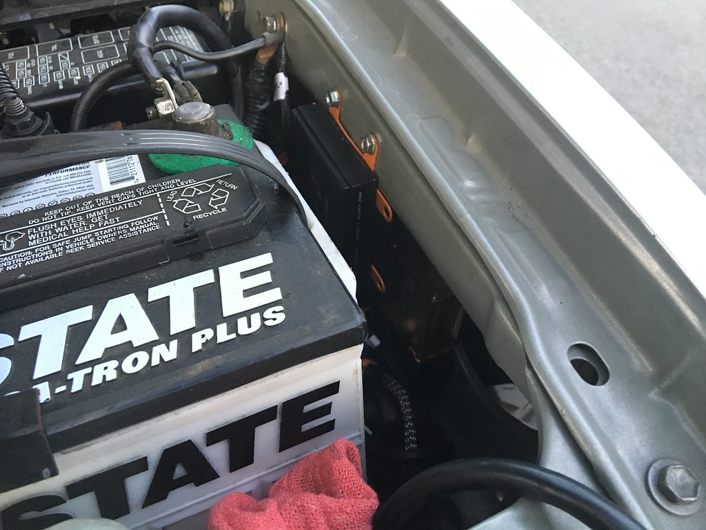

Why 100A and 125A circuit breakers instead of just one? Sorry, I'm not much of an electrical guy..
Slick build!
Currently, they are not used for anything, but I am going to use the 100A breaker for the auxiliary fuse block and the 120A breaker will be for the upgraded alternator once I get that.

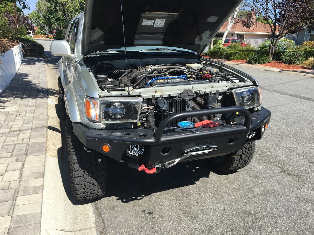

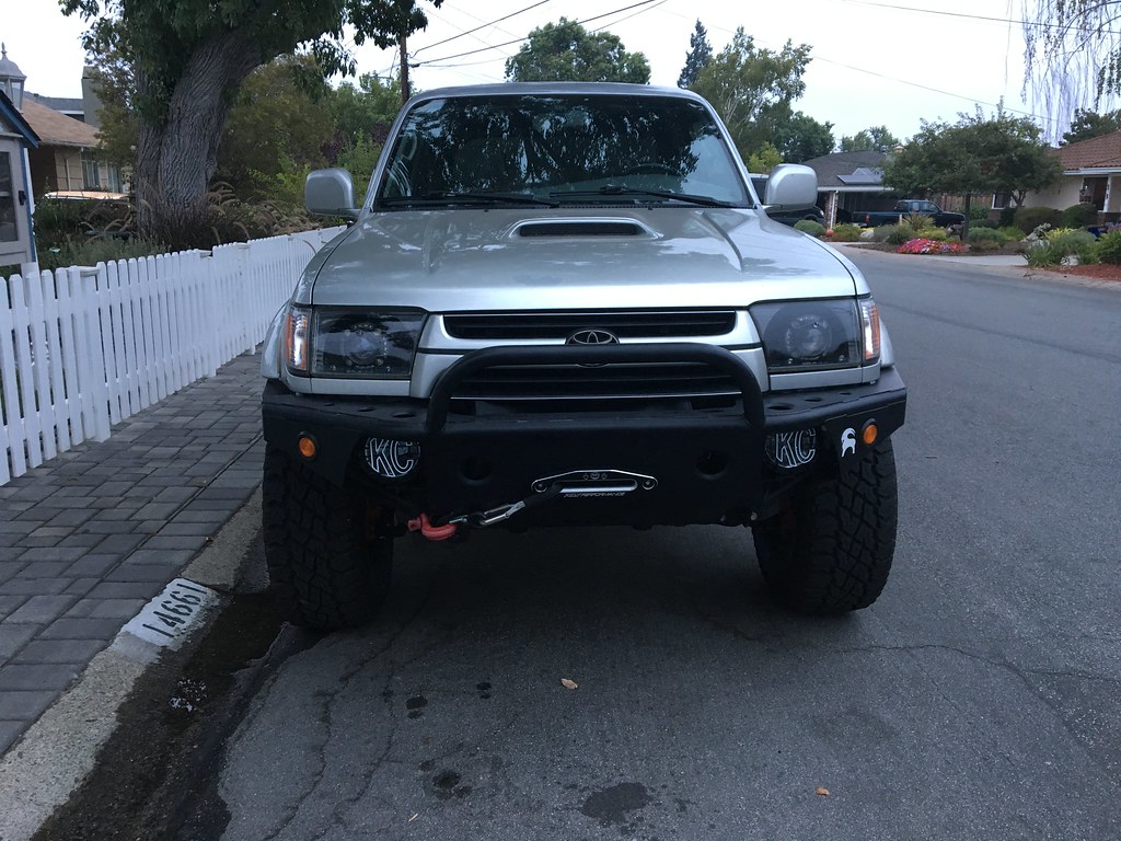

Winch and KC HiLites Installation
Parts List:
- Smittybilt 9.5K Synthetic Line Winch
- KC HiLites 6" Pro Sport LED Lights

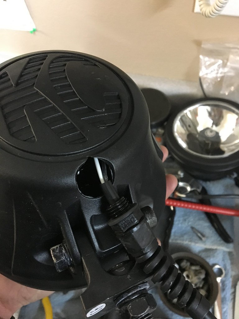

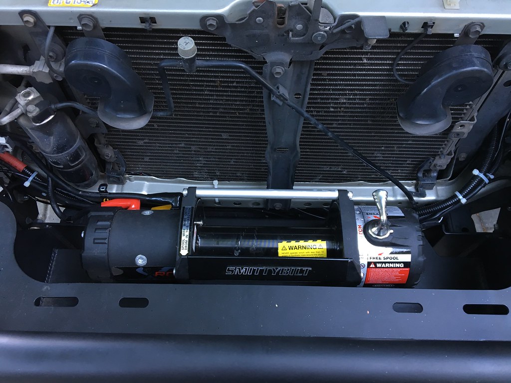

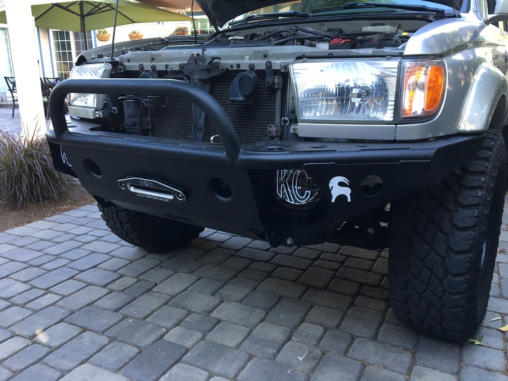

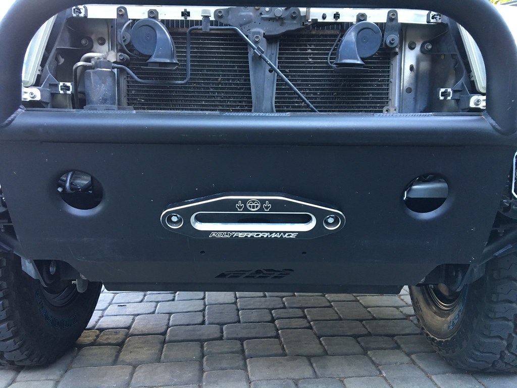

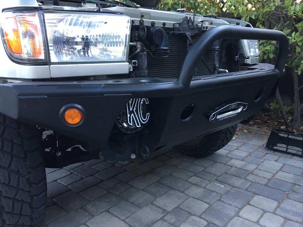

I probably should have just done these when I first installed the bumper, but oh well. I started with the winch and all of the wiring with it. I put the winch controller in the same place as before, on the passenger-side right in front of the wiper fluid bottle. It is held in with one of the brackets right now, but it definitely needs another one to keep it still over large bumps. I will need to spool the winch once I find a long enough flat ground and a sturdy pole.

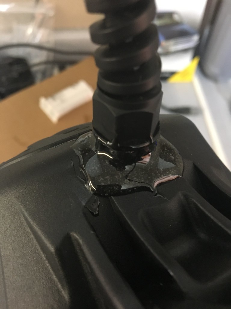

As I was putting the lights in, I noticed that the driver-side mount was bent from the accident. This was from the harness from the lights being pulled through the light housing. I beat on it with a BFH to get it mostly straight again. I had to set the wiring grommet back onto the housing of the lights, so I used some 5-minute epoxy to hold and seal the break. I routed and zip-tied all of the wires to go behind the front crossbeam and to the hole next to the light. I didn't want to pass the wires through the grommet on the driver-side, so I was not able to wire the switch, but I will get there one day once I do the "Big 3" and new firewall bulkhead.
Broken KC Light from accident

5-Minute epoxy to hold everything in place
https://flic.kr/p/WcqAUp

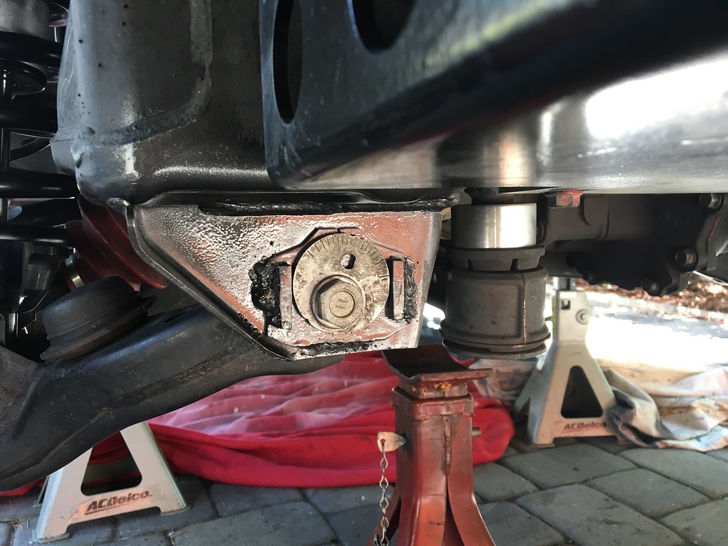

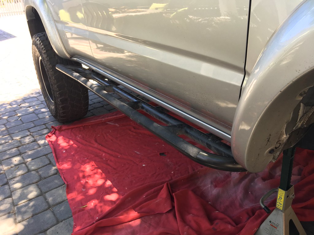

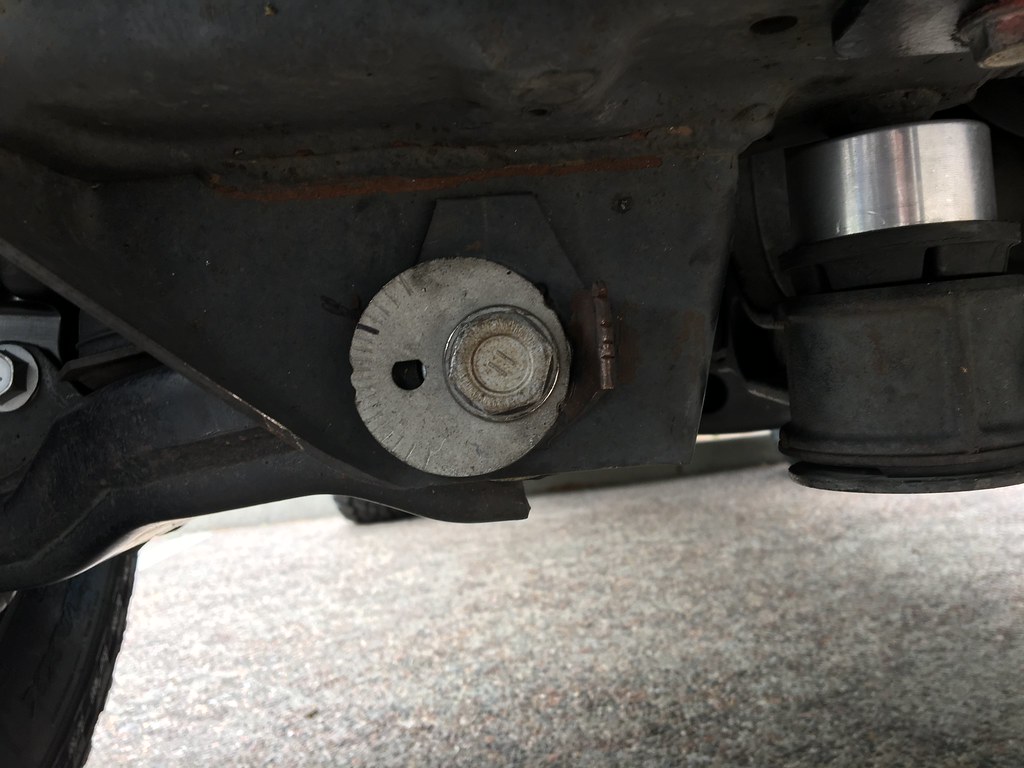

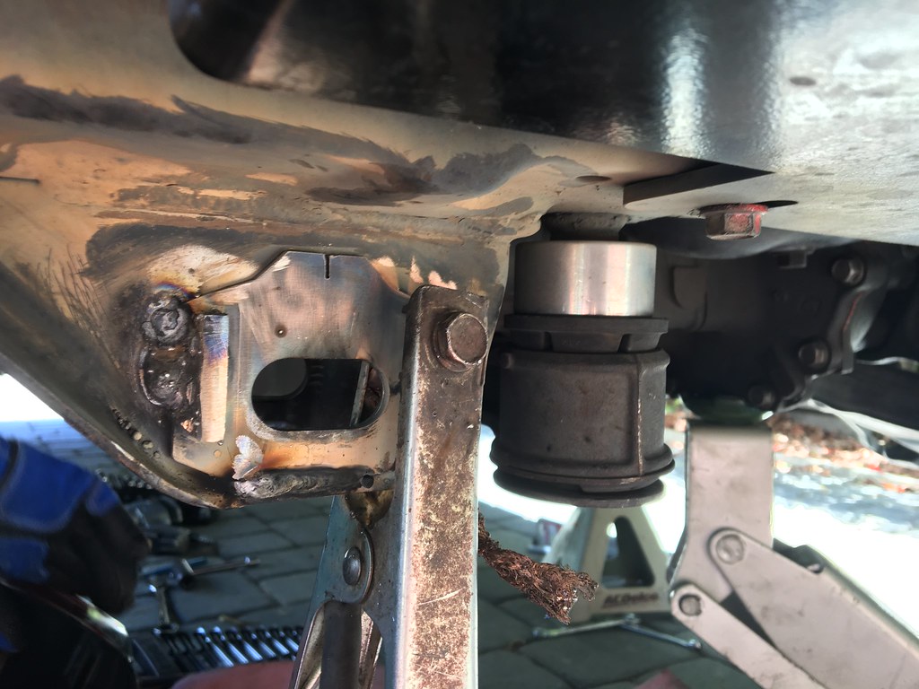

This past weekend I was able to get some welding done with a friend of mine! I wish I had caught that the cam alignment tabs were broken when I was first doing my suspension, but at least I'm getting quick at removing the LCAs! Once everything was torn down, I noticed that the rear alignment sets on both the driver and passenger sides were welded in areas besides the spot welds. I'm guessing that the car was in some sort of accident, and the front passenger wheel hit something hard causing the front set of alignment tabs to shear off. The rear ones must have been bent back into place and welded for strength. With all of that, I decided to only drill the 2 front tabs off and weld the Total Chaos on. Not the prettiest of welds, but it'll work.
Next up was welding the panhard drop bracket on, which took all of 10 minutes. We burned the bracket on, and i sanded down the splatter and painted the area to prevent any rusting. The last thing we worked on was my old sliders. These were plasma cut off the frame of my old rig, so they needed to be ground down a bit. Once that was done, we fitted them to the car and clamped them into place. Since the old frame was still attached to the sliders, there were a few gaps that had to be filled. This was pretty easy using the flux-core mig welder...just kept shooting the wire in the gap until it filled up! The sliders took just over an hour to finish welding, and i did my best to grind away the small growths and slag. I painted them up, and they look great! My girlfriend is especially glad that she got her step back...:roll:
The broken alignment tab
https://flic.kr/p/V7DgN3
Replaced and painted

The sliders
https://flic.kr/p/W94PMQ

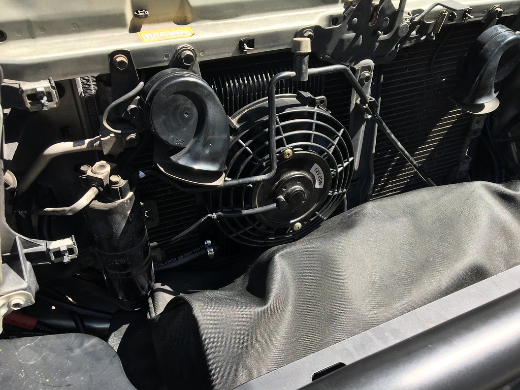

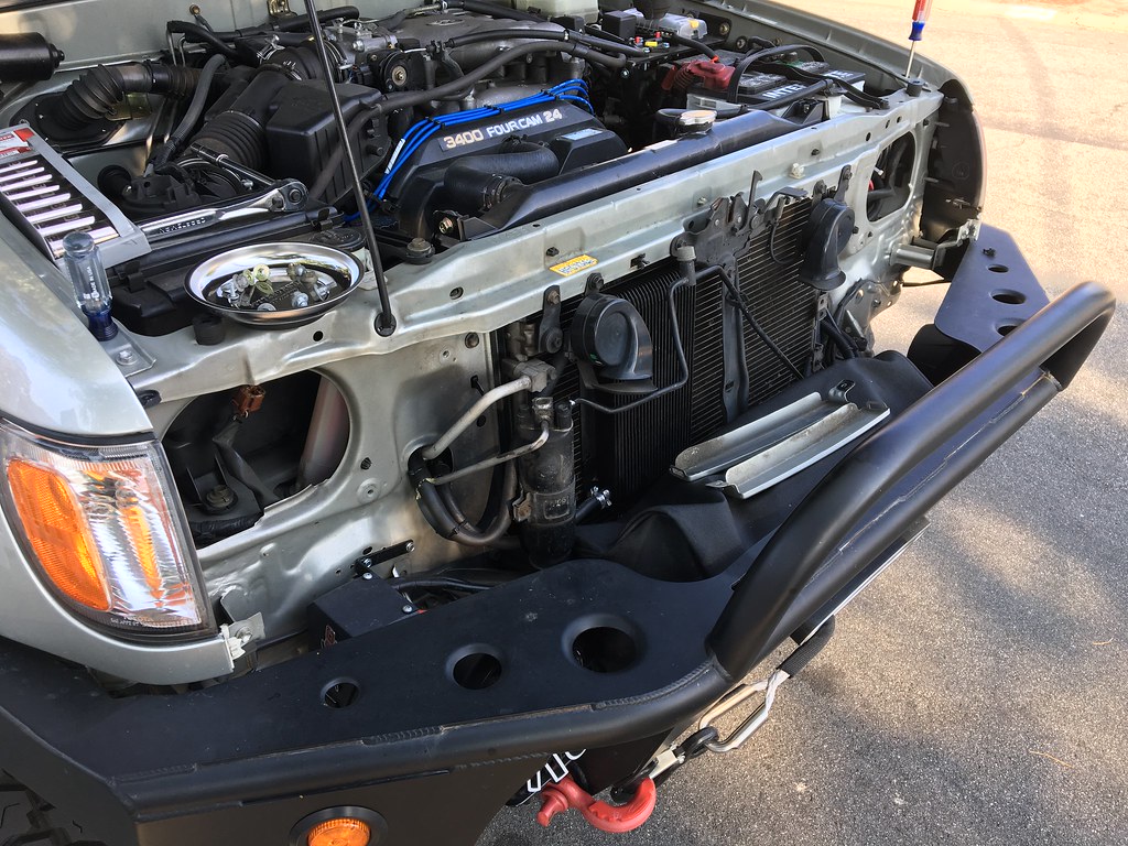

In actual 4Runner news...I installed my B&M transmission cooler, as well as the electric fan! I used the zip ties that go through the radiator for the cooler since they are extrememly convenient. I used the brackets that come with the cooler for the fan in order to attach it to various points around the front of the car. Unfortunately, I did have to bend the A/C condenser line in order to fit the fan. Unlike my old car, this one has the line come down at a 90* angle, and I was not able to pfit it into the same exact spot as before. It was a pretty quick install, and I'm hoping that it helps out when I'm going out to off-road! Eventually I'll be adding in a temp gauge or scan gauge...gotta figure that out first.

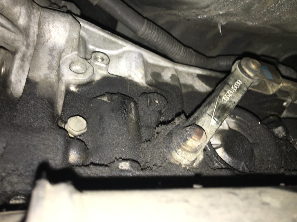

While I was under there, I also noticed that my transmission had a lot of oil on it. I think it is from the pan gasket, but I'll use some degreaser or oven cleaner in order to pinpoint the seepage!

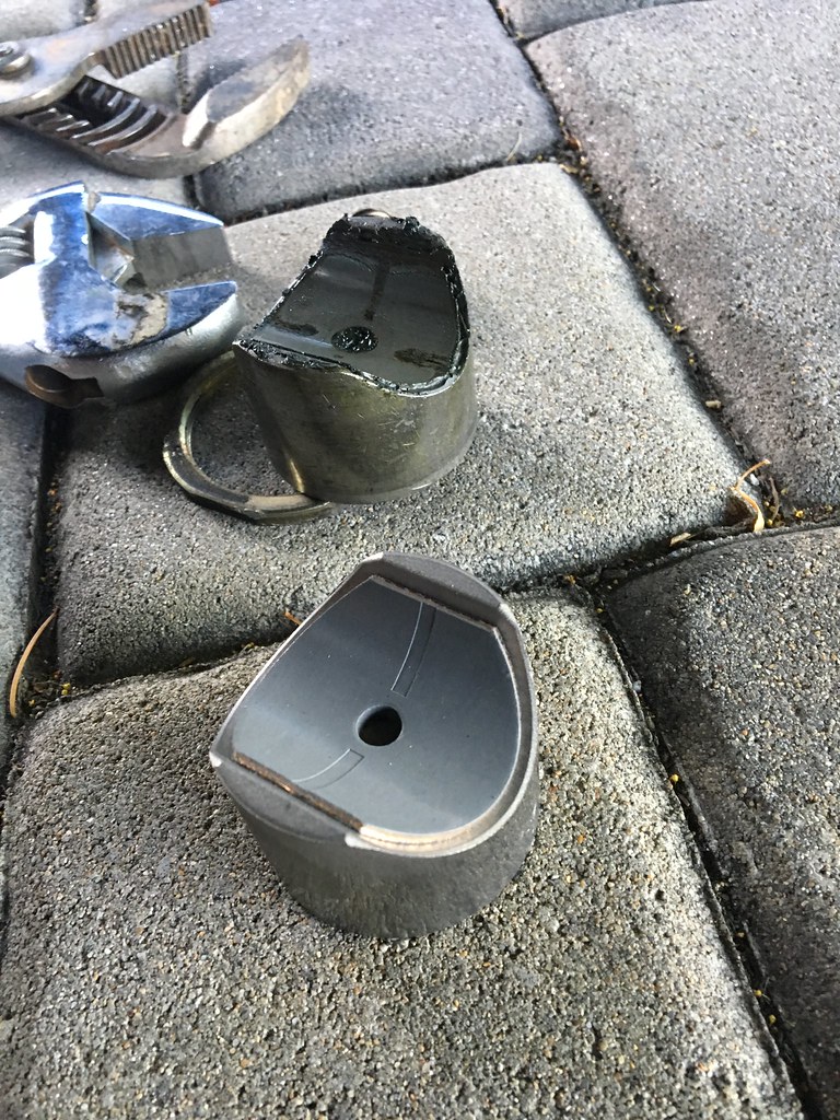

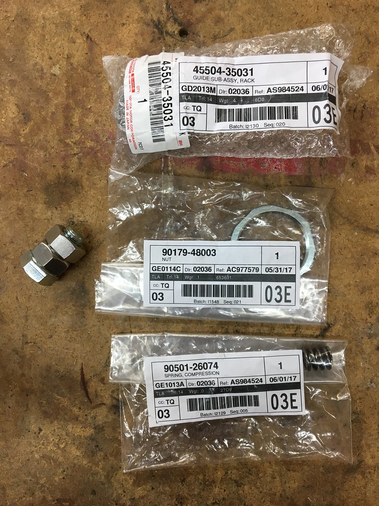

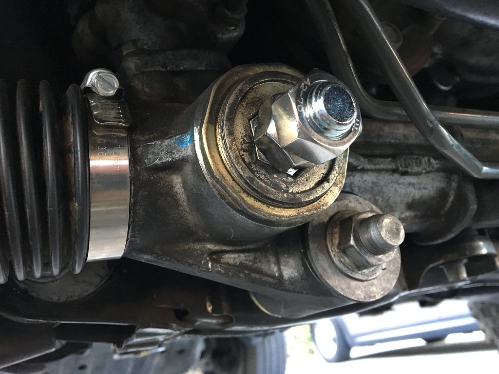

This past weekend I decided to tackle what I thought was the cure to a clicking noise underneath the driver-side of the car. Since it only happened while stopped and turning the wheels, and sometimes when I would first accelerate, I thought it had something to do with the steering rack. Since I had just replaced both sets of tie rods, I ruled those out. Short of replacing the entire rack, I went with the rack guide. Since I didn't want to shell out an extra $30 for a 24mm hex bit socket, I looked up what size bolt has a 24mm head on it. Turns out it was a 16mm! I went by my hardware store to pick up the bolt and 2 nuts for the wrench.
Once I got home, I used the channel locks to remove the large retaining nut. Once off, I put the bolt head into the cap and got it off no problem. I replaced the rack guides and retorqued it to about 18 ft-lbs then backed off a little. I might need to go back in to adjust it, but the clicking went away for the most part. I can still feel it every once in a while, but it is mostly gone.

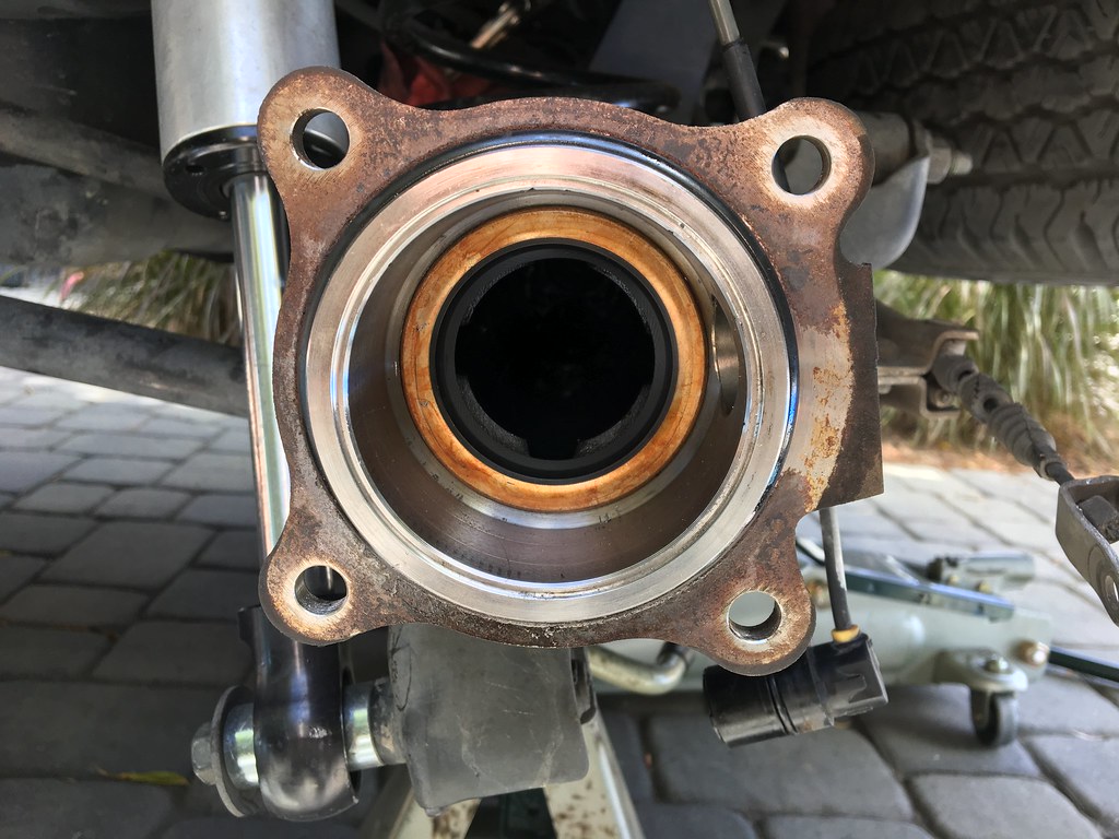

This weekend I decided to test fate and swap something out that wasn't broken...my rear axle seals. Since it was an expensive fix the last time I had to do them, with the bearings and shop time for the press, I wanted to see if I could get ahead of any failure on the new rig. Getting everything off of the car was super easy now that there is no rust to deal with...I just love it! I took off the drums to check the status of the brakes, and besides being dirty, they looked pretty good. Next up was removing the brake line and the 4 nuts holding the backing plate to the axle. Once the shaft was removed I was able to get a good look at the perfectly fine seal...oh well...I decided to continue and remove it since I was already that far into the axle. It came time to press the new one on and I was having the hardest time getting it started. I ended up getting one side in, and using a socket on one side of the seal driver to get it straightened out.
I got everything else back on without issue, but since the seal looked fine, I decided to not mess with the passenger side. Now I'm guessing that it's going to leak soon just to spite me. While I was under the car, I noticed some oil seepage from the 3rd member and axle housing. I really didn't want to drain the oil and drop the drive shaft, so I decided to check the torque on the bolts. I found maybe 5 that were under-torqued by quite a bit, and it was right where the seepage was so I'm hoping that will solve the issue for the time being.

Rack guide parts
https://flic.kr/p/WGSBM4
The 16mm socket in the cap
https://flic.kr/p/W7zJpf
Side by side
https://flic.kr/p/WGSBFn

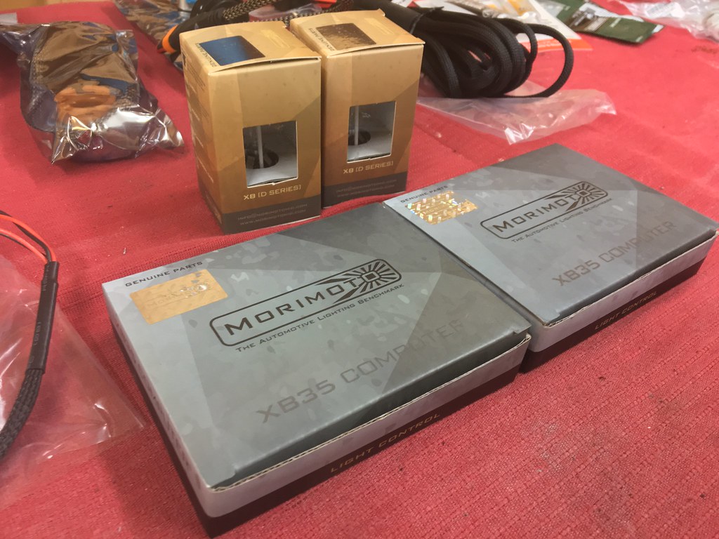

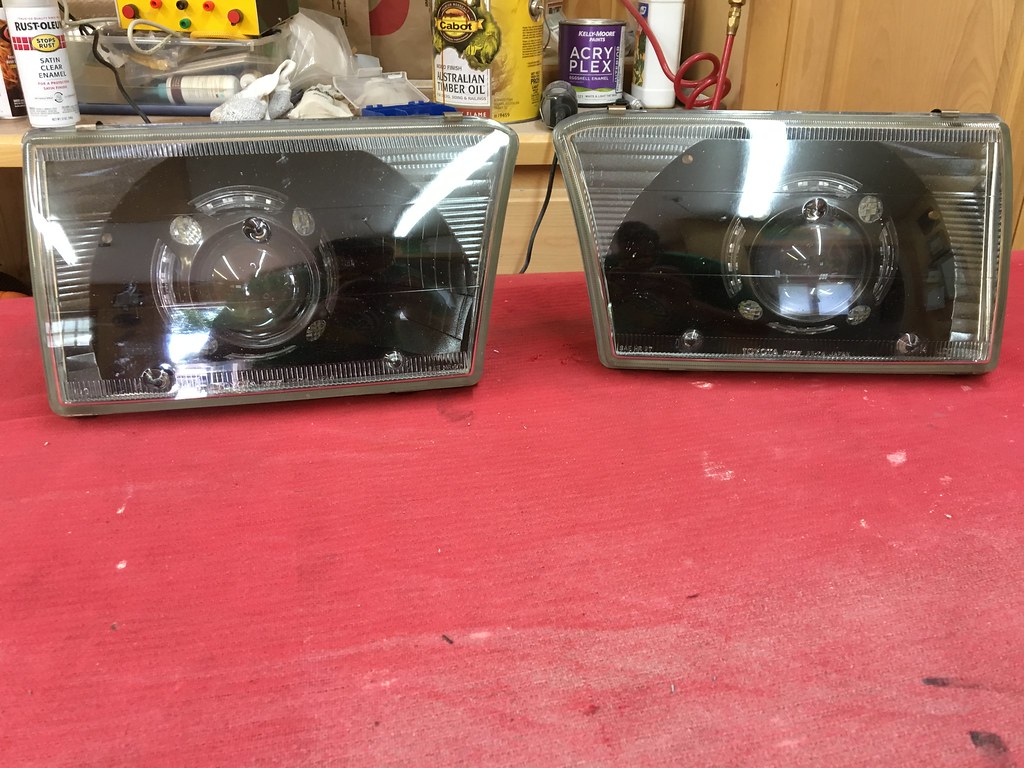

Projector Retrofits
Parts List:
- Bi-Xenon: Morimoto Mini D2S Stage III Kit
- OEM TYC Headlights
- Rustoleum Metallic Black Paint
- Rustoleum Semi-Gloss Clear Coat
Tools List:
- 10mm Socket Wrench
- Philips and Flat Head Screw Driver
- Dremel with Sanding Attachment
- JB Weld
- Silicone Sealant

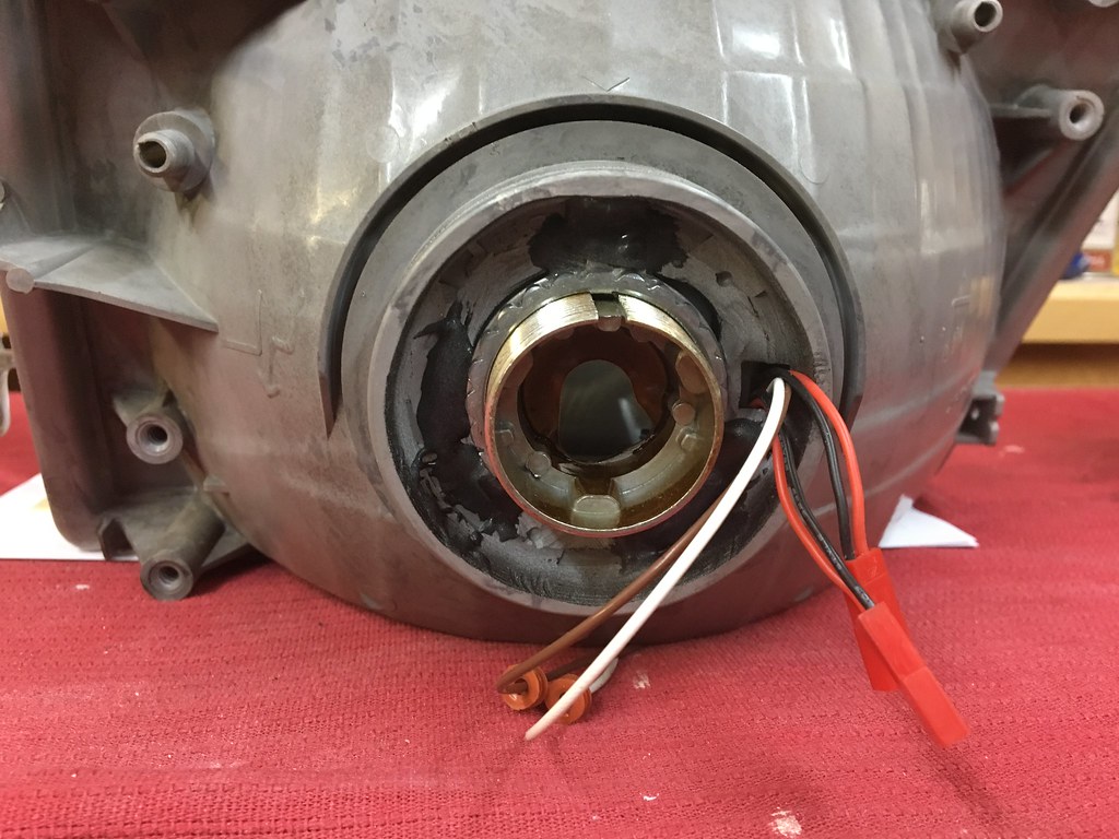

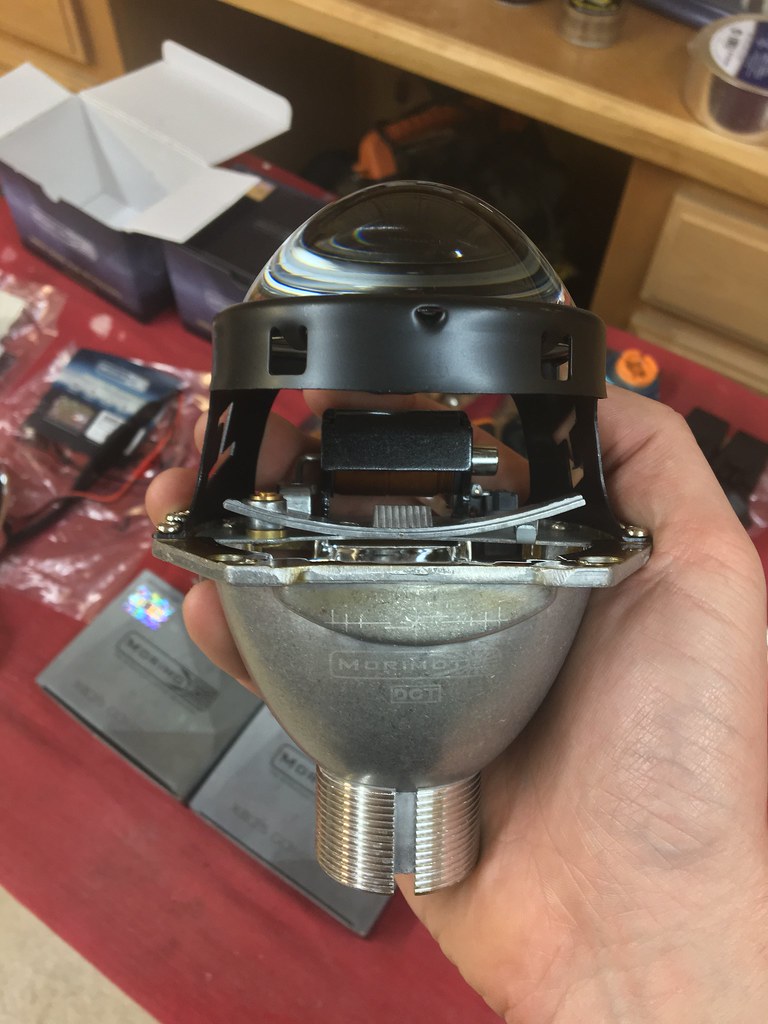

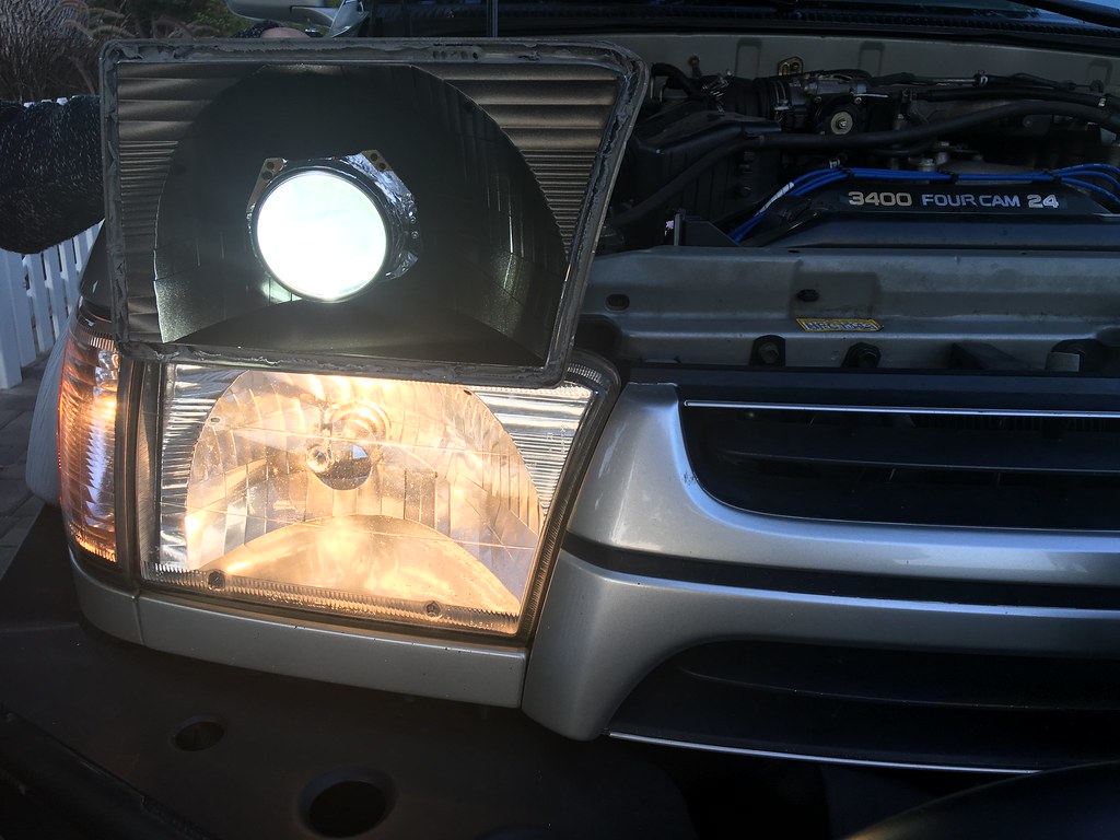

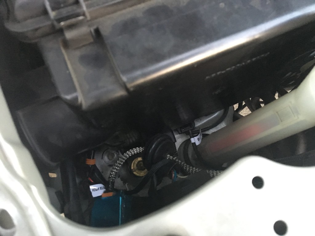

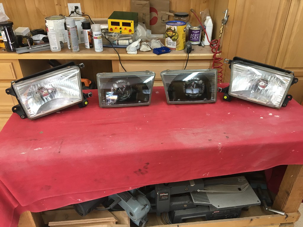

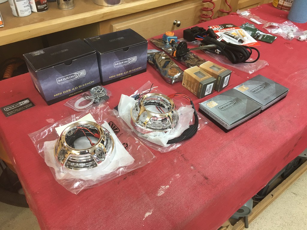

I was able to finish offf my projector headlight retrofit project today (minus aiming them). I am extremely happy with how they turned out, and I'm sure it will look even better when they are aimed. The actual modification to the OEM housing was simple. I took a dremel with the sanding attachment and removed the structure that holds the original light in place. I then used JB Weld to secure the projector alignment key in place on that surface. As others have done before, I used aluminum tape to completely seal the projector from light leakage.
I wanted to get the paint as perfect as possible, so I scuffed up the interior of the reflector bowls before cleaning them some paint thinner. I sprayed a couple coats of primer before putting on a black metallic paint. I finished it up with a clear coat to protect to give it a more glossy sheen.

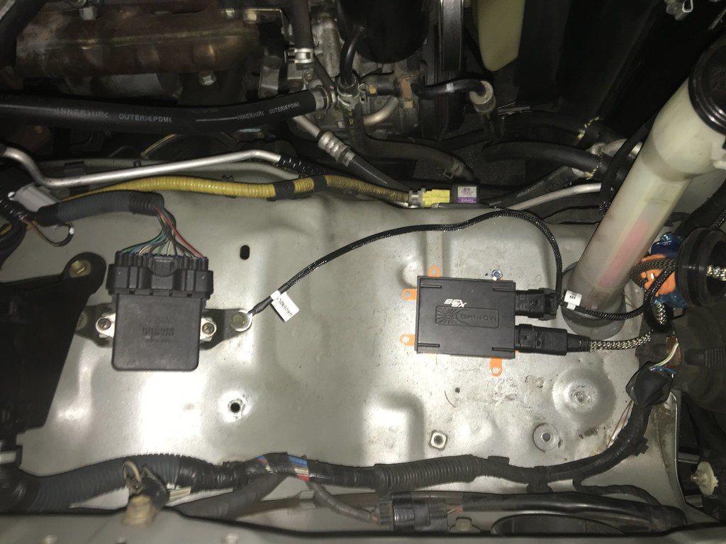

Since the mounting holes were covered up, I used 3M VHB tape to secure the Panamera shrouds in place. The high beam and shroud cables were routed through the square hole near where the light is, and sealed it off with some silicone. I cleaned everything off one last time before placing them in the oven for a bit and pressing the glass and bowl together. I removed the OEM headlights and attached mine. Unfortunately I didn't have time to fully align them, but I got them pretty parallel to the ground. I'm hoping I can finish the rest off tomorrow when I have a flat surface and a wall.
Time for some pictures!
All the parts
https://flic.kr/p/Wws7Kx
The projectors are huge!
https://flic.kr/p/XFTytY
Ballasts and Bulbs
https://flic.kr/p/XFTAF3

Mounting locations of the ballasts
https://flic.kr/p/Ya38KD
https://flic.kr/p/XTVivG
https://flic.kr/p/XTVhpJ

Nice work on the projectors!

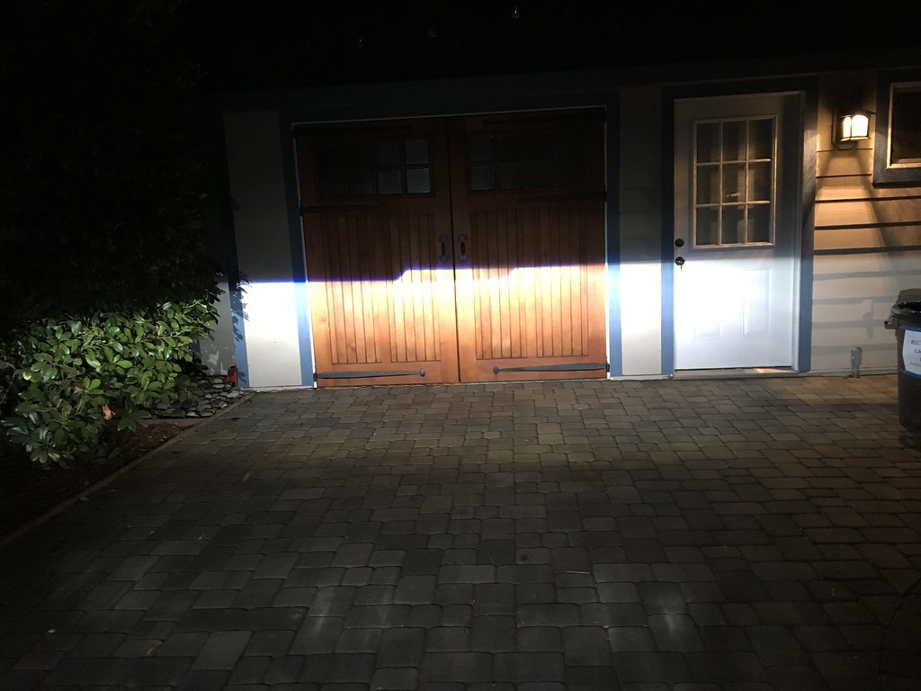

Got any tips on aiming headlights? I replaced my housings months ago and have yet to get them really pointed right!
Thanks Jordan! Ater working on them tonight, you really need to find a long, flat space. I had a slight incline so the lights are a little bit too high. The lower adjustment nut seemed to adjust vertical alignment while the upper nut did horizontal. For the projectors, I adjust both sides so the cut-off aligned with each other. Fror halogens, I'm not sure how you would do it.

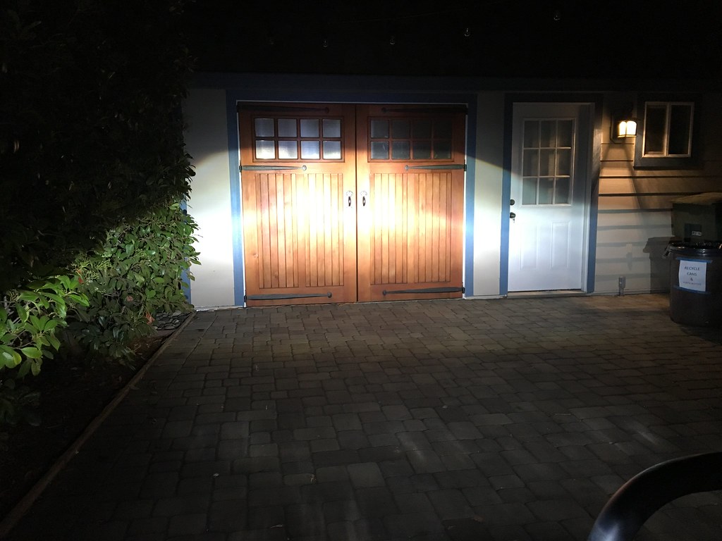

August 28th, 2017
Headlight Aiming

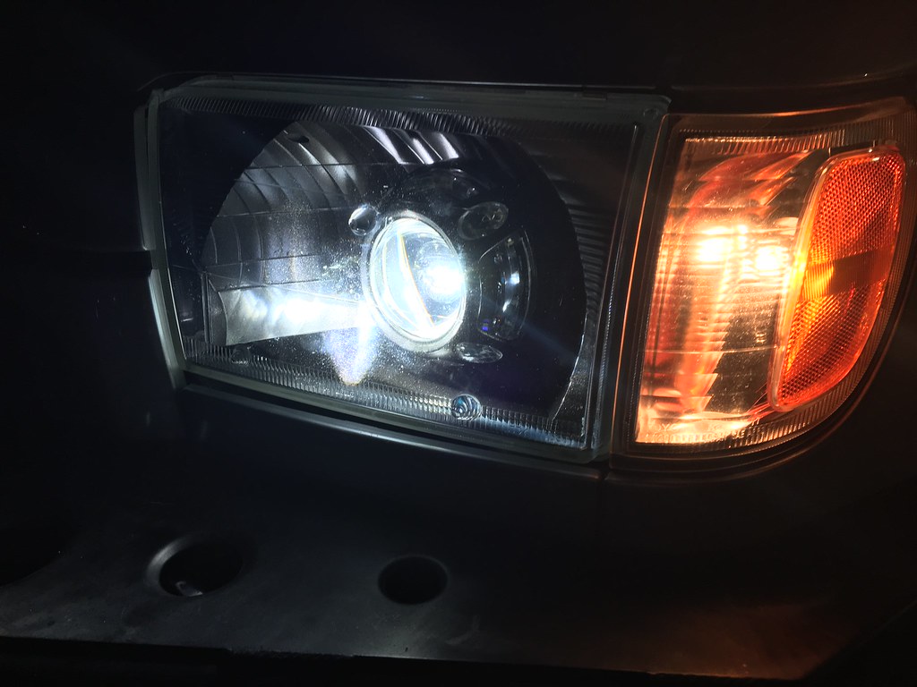

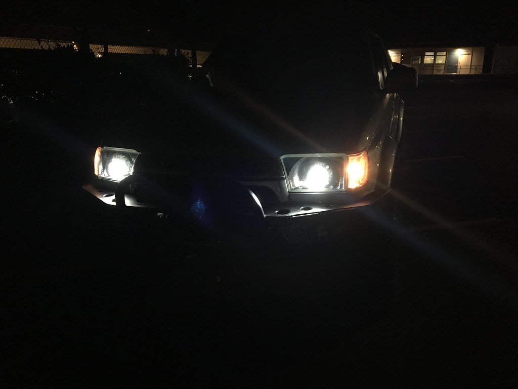

I was able to adjust the headlights up quite a bit, maybe even a little too high after test driving it around the block. I am very impressed with their distance and how much they light up the street. A HUGE improvement over stock. One thing I do want to try and correct is the driver-side headlight not being perfectly parallel to the ground. In the meantime, I am a happy camper!
Low Beams
2017-08-28 20.22.33
High Beams
2017-08-28 20.22.47
Night Shots!
2017-08-29 20.49.27
2017-08-29 20.49.14
2017-08-29 20.49.37

Any night time front shots?
I just added them to the original post! It was tough to get a decent shot with just my phone. I hope it's what you're looking for!
