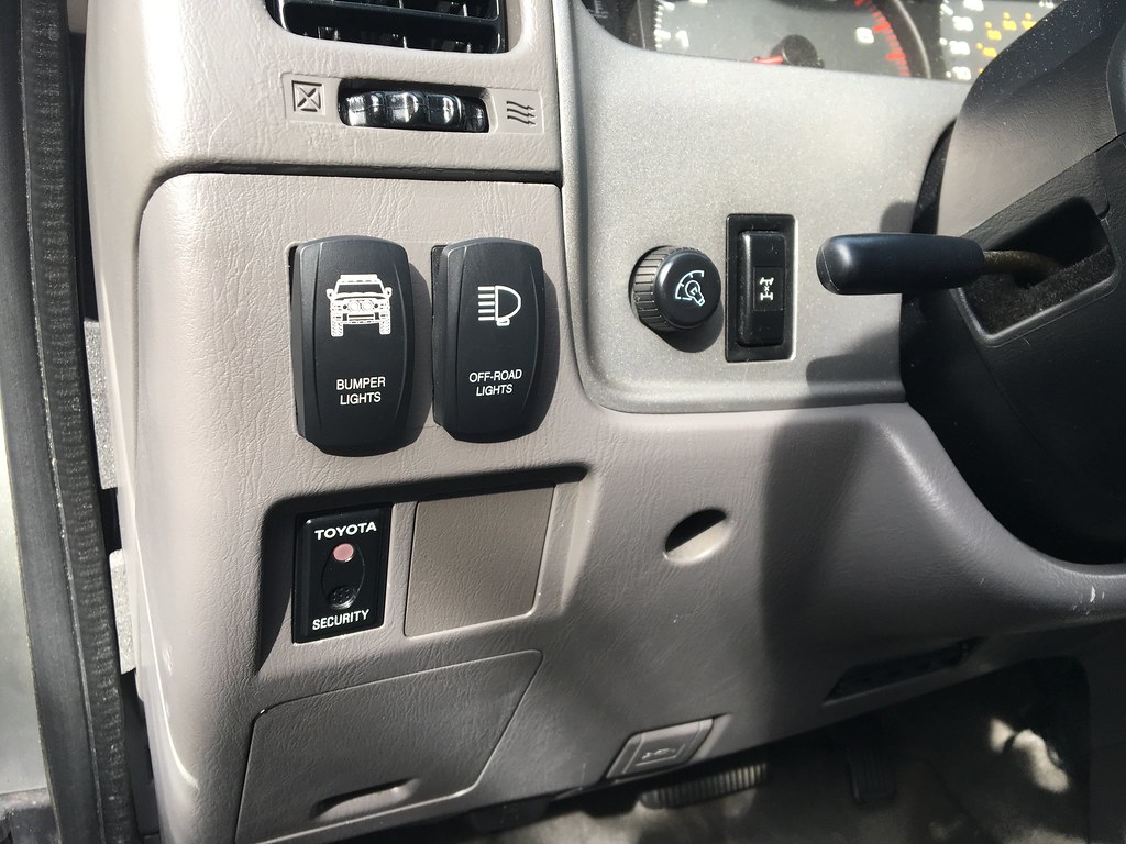

Bumper Lights Switch Install
Parts List:
- 2x OTRATTW Lower Independent SPST Switch
- Bunch of Colorful 16ga GXL Wire
- 3/8" Wire Loom

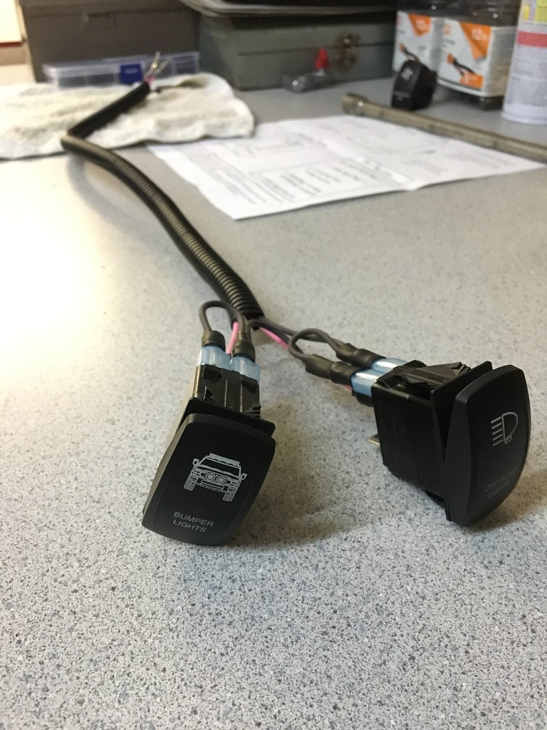

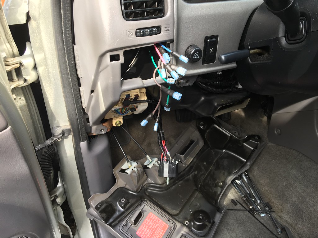

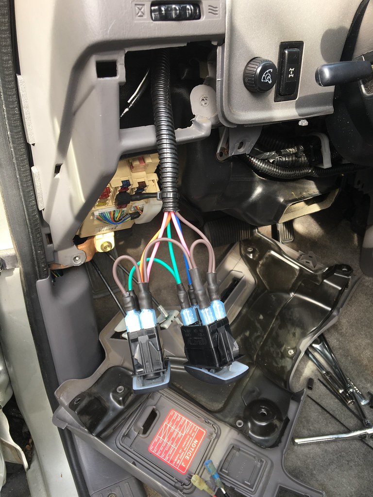

I've had the lights on the truck now for a month or so, but I haven't been able to use them since I didn't have the switches I wanted to use. I planned ahead by wiring the lights up until the firewall, so it made life a bit easier yesterday.

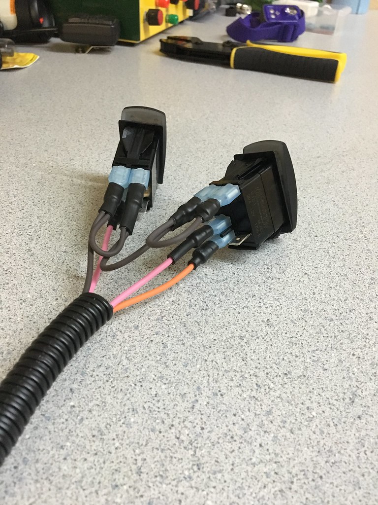

As a common theme to this build, I have been trying to make everything look cleaner and perform better. In order to reduce the number of wires coming through the firewall, I decided to use a common ground and jumper it to both switches, and use the ashtray light's wire in order to power the lower independent light. I made the rest of the harness by very roughly measuring the length of the bulkhead connector to the dash piece beneath the wheel.
I needed a total of 5 wires coming through the firewall and quite a few jumpers which you can see in the pictures coming up. Once that was done, everything was wrapped up using some wire loom to make it look more professional. After connecting the wires to the bulkhead, I routed the loom over the air vent to where the switches would be. Once the lights were tested and I verified that I didn't screw something up, I re-attached the dash!
While there is not a ton more room for switches on that side of the dash, I made the wiring pretty modular if I were to ever add another one over there. Next up to wire is the transmission fan and the rock lights!
On the bench

Wires through the dash

Connected to the switch

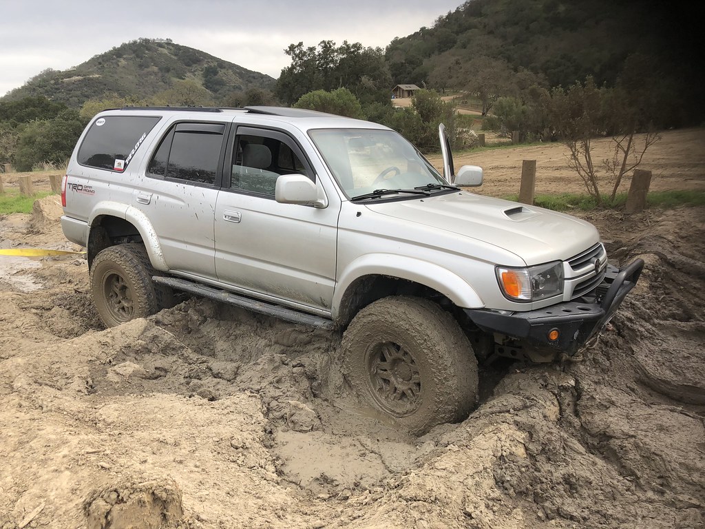

Hollister Hills SVRA Day Trip

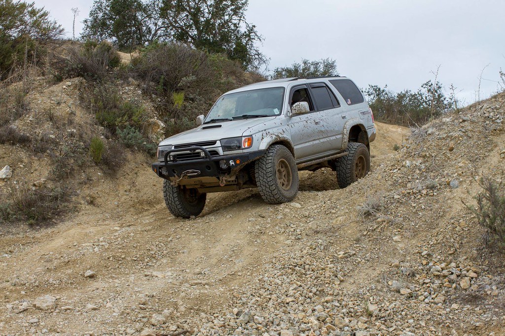

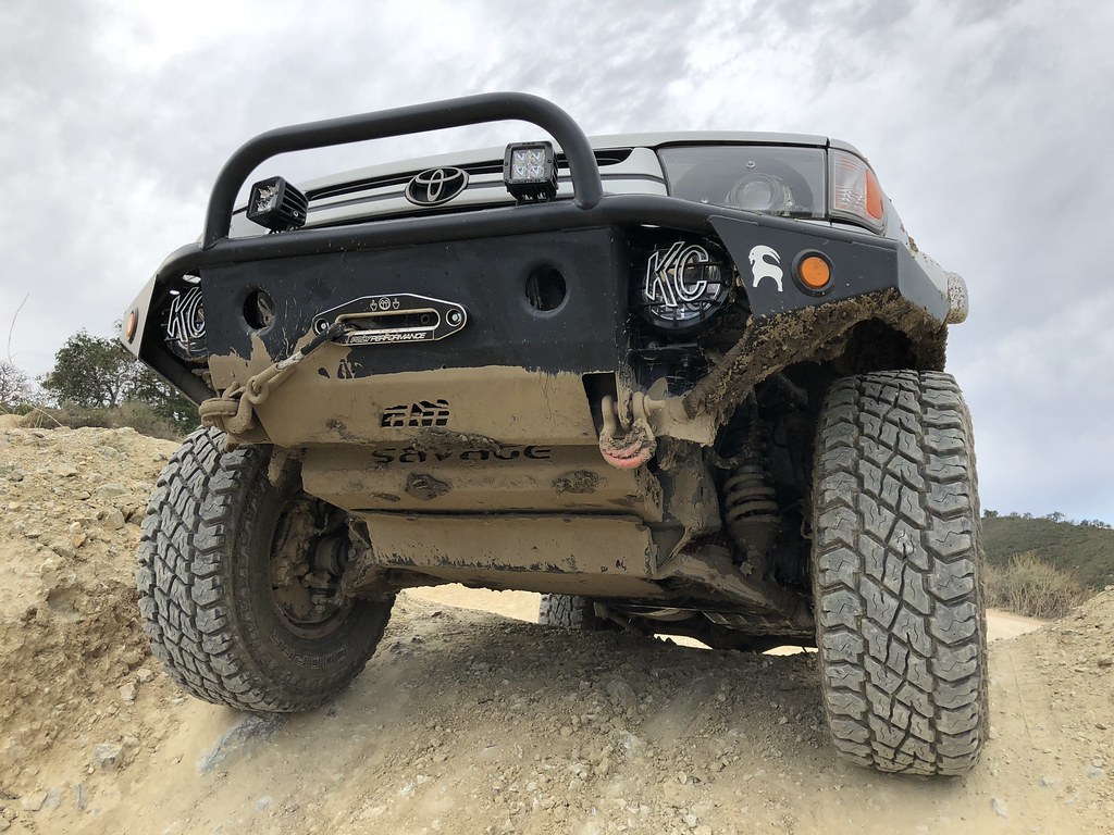

It's been awhile since any update, but I was able to go down to Hollister Hills this past weekend! It was really the first time I got to take it onto the dirt (mud) since I bought it...so I was definitely itching to go. I went out with a couple of my coworkers and a friend who brought a Cherokee.

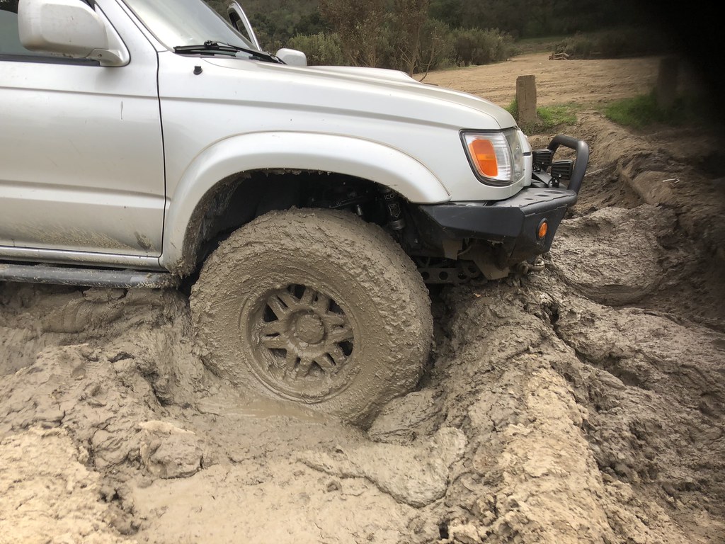

We had a great time tooling around the obstacle courses and taking mainly blue trails around the park. I ran into trouble off of the first obstacle I took, a log pit that was full of mud. I made it over the first 3 logs then got buried in deep because it was extremely muddy. Definitely the worst I have seen it. Besides that, I was extremely happy with how everything performed, especially the suspension. It felt SO good offroad, but now my LCA bushings are squeaking...

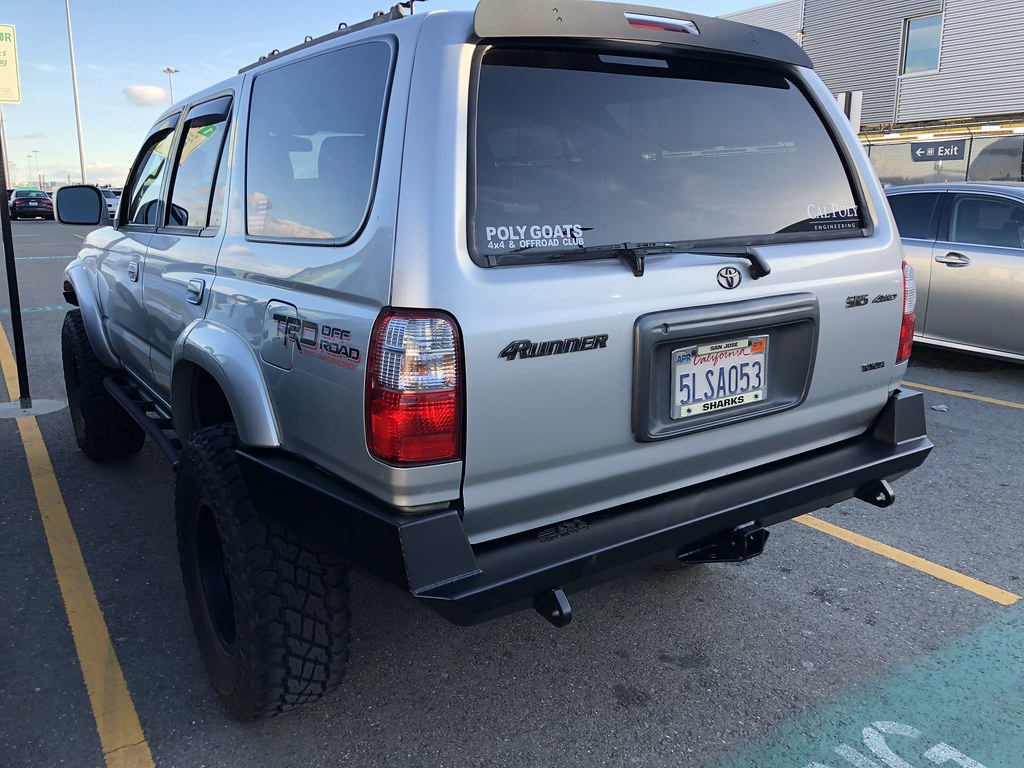

Rear Bumper Installation...Part 1
Parts List:
- CBI Rear Plate Bumper

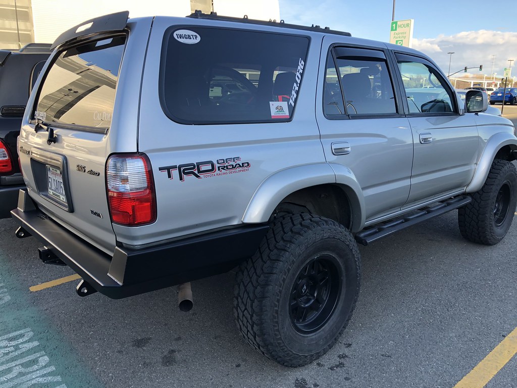

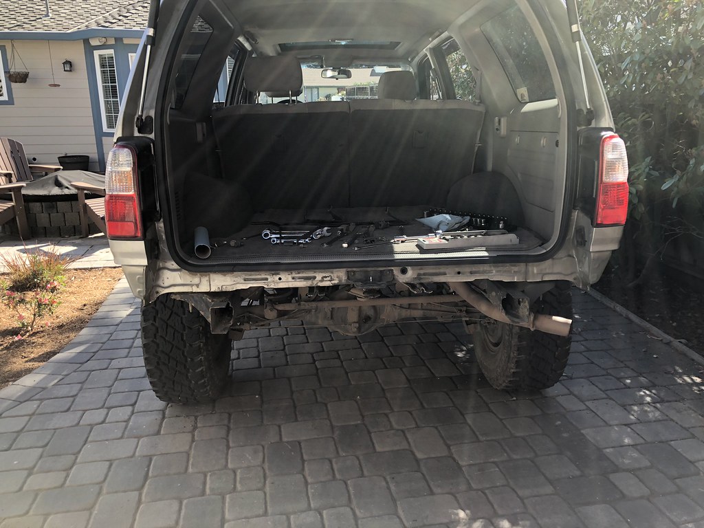

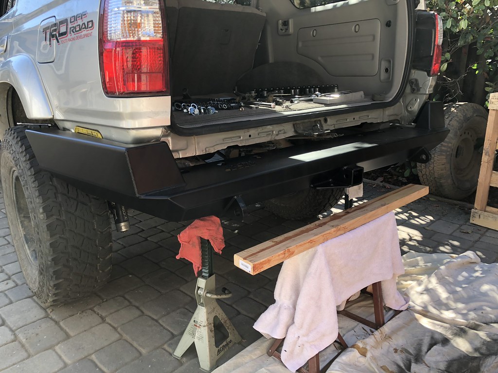

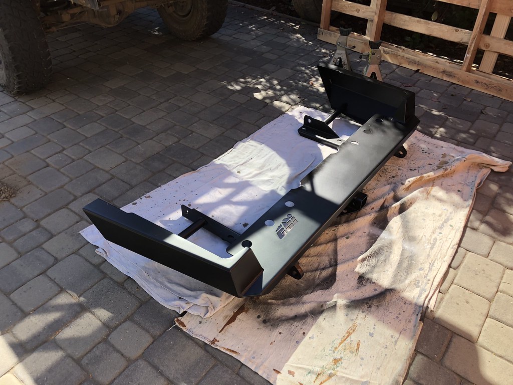

So I received my rear bumper this past Thursday, and I was definitely excited to install it yesterday! Upon unwrapping the pallet, I saw a bit of damage to the powdercoat and bumper itself. It looked like the painter didn't prep the metal properly which caused the powdercoat to chip off. It was mainly apparent on the hitch, so it wasn't a big deal to just repaint it.
I got started by removing the hitch and the stock bumper. I always forget how many bolts are holding the bumper in place, so it definitely took longer than I expected. Once it was off, I started to prep for the new bumper. Since I was by myself, I used 4 jack stands and a 2x4 in order to get it in position. I let it rest on the frame rails before lifting it up into the final spot.

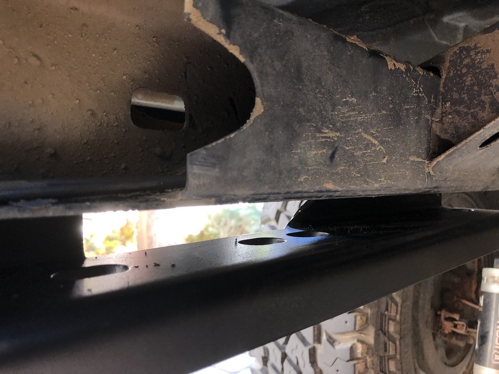

After pushing the bumper up to put the bolts in, it ran into the car's body before the mounting surface touched the frame rail. My best guess is that CBI made the bumper for a 4Runner with a 1-1.5" body lift...BUMMER! I double-checked the order to make sure I selected the correct options.
I'll give them a call either tomorrow or Tuesday if they are closed and go from there. I am hoping to get the correct bumper soon! For now, I will be rocking the no bumper look!

Rear Bumper Installation...Part 2

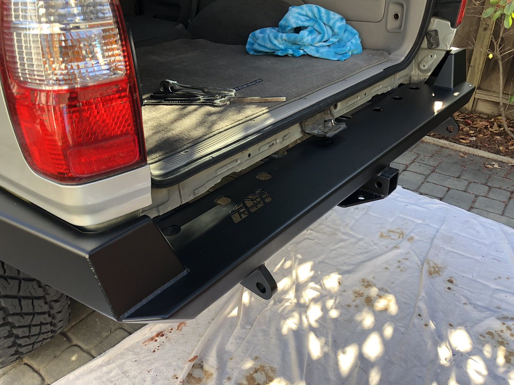

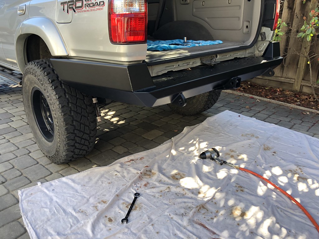

I was able to work it out with CBI, and got the new bumper Saturday morning, making it about a 2 week turnaround. My company had a big party in SF that night, so I definitely wasn't going to be able to get any work done until Sunday. I had already set everything up, so the install was going to be quick.
Once I got back from the city, I started by removing the rear shock reservoir mounts. The place I had them installed overlapped one of the bumper mounts, so I would have to relocate them slightly. I had a couple of my neighbors help me lift it into place while I guided it over the exhaust and put a few screws in. After that, it was just a matter of getting the 2 sets of bolts deep in the frame into place. The first set went in fine, but I had some trouble wiggling the second to fully seat.
With all of the bolts in place (minus the 2 I still need to drill a hole in the frame for), I started working on the reservoir mounts. I liked their current location, so I just drilled a new hole ~1.5" towards the front of the car. This allowed plenty of room for the mount to clear the bumper.
With everything ready to go, I torqued all the bolts down and got to admire the beauty of this bumper!
