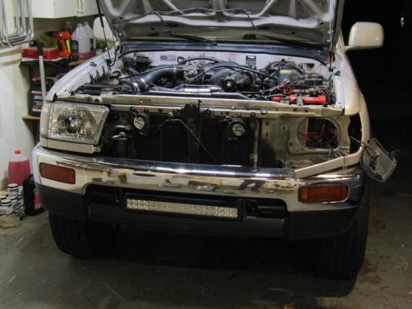

IT LIVES!!!
Cranked it over twice and it fired right up as if it had never stopped running! It's so buttery smooth compared to my last engine, I'm really happy so far. Obviously, I will need to put a few k's on it before I'm in the clear but it's looking great so far on day one.
So happy for you, Jerod! It’s like you turned back the clock - OEM Toyota build quality, tolerances, etc. JDM is inherently a gamble but more often than not you get a winner. Enjoy it!
Both of us have more Japanese 4Runners than most people now! I don't know if you experienced this or not (I think you said a shop did the swap?) but the moment it fired up I felt like a weight had fallen off of me. All that hard work and patience paid off. It cost me about $1800 all said and done for the engine, fluids, tools, engine stands, etc. to do the swap so I'm pretty happy about that too.
I remember that feeling! I did the swap myself - will share the story here on T4R.org: could help others avoid the same situation that led to replacement of the engine and transmission. I still use the engine hoist here and there but the pair of engine stands sit unused. My 12 year old wants a 3rd Gen 4Runner when he’s 16 - depending on what we get for him another engine replacement might be on order. Hopefully the JDM 5VZ-FE engines keep coming over, for all of our sakes.
Did you bolt the SC on? Thinking you want to run it NA for a bit to make sure all is well. I have ~20K on my JDM so far.
Naw S/C was the first thing to go back on once the engine was in! I won't push the engine for a few weeks though to allow it to break in a little. It has a bypass valve so it doesn't build boost until you get on it. I'm addicted to the rattling noise at idle and the whine, can't live without it now!

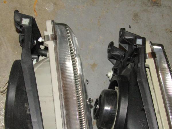

Needed to perform some eye surgery this evening, the poor TYC headlight gave out on me. One of the clips that are spring loaded gave out and wouldn't go back together so it would point at the ground and wobble about. Tried to secure it but it didn't work.
15 minutes later, and had the new one in and with a few turns of the adjustment knobs, aimed and ready to go! I would complain about the quality and all that buuut... they are $40 on Rockauto.com so... yeah. Sure beats dealer prices!

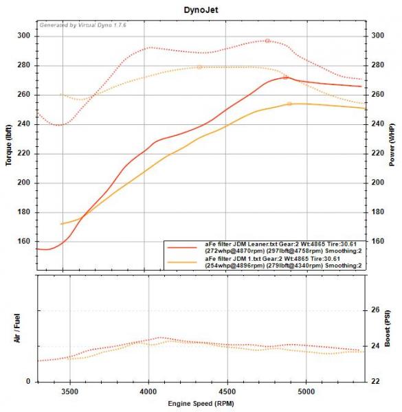

So, I had some time to run a few times down the road and get some power readings with the two filters. Here's the chart and I'll discuss the data below:
gamefreakgc-albums-engine-performance-mods-picture55048-afe-filter-dyno-runs-vs-paper-filter.jpg
Orange line is the aFe 5R Power oiled filter, blue is my stock paper filter. Pretty conclusive by the chart this thing flows better for my engine. Now, before you ditch your paper filter on your N/A 4Runner know that my engine is heavily modified and has a higher cfm flow than stock.
That being said, I'm very pleased with how it performs. Peak gain might only be +3 HP and +4 lbs tq but max gain is +9 HP and +9 lbs tq at 4500 RPM! Now this is just preliminary data based off my AEC FIC 6 logs (using Virtual Dyno) but it's shown to be pretty darn accurate. I'm going to give this filter a straight +6 HP, the power is there. Confirms also that my intake it still too restrictive.
A few other things I learned today is that heat soak happens on the third run. You'll notice the top end REALLY drops off once you go back 5000 RPM's. That's what happened on the dyno last year too, heat is a real limiting factor on this engine. I might do another run soon when the engine is cooler for some better comparisons. I took at total of 6 runs, that was too many without allowing it to cool down.
Also, I learned that the AEM FIC reads the AFR +0.3 higher. I will need to re-tune my engine soon to correct that.

I've been sick for over 40 days straight... but finally on the mend! In between storms I had a chance to tweak my tune a bit and it made a BIG difference! Upon following some advice, I leaned out my tune into the low 12's, so around 12.0-12.2 and wow, did that wake up my engine! I saw roughly +18 HP and +18 TQ from my Virtual Dyno program!
gamefreakgc-albums-engine-performance-mods-picture55365-afe-filter-leaner-afr-12-0-12-2-a.jpg
I need to do a few more runs to confirm this but so far I'm seeing more top end power leaning out the AFR's a little with meth injection. I was previously in the 11.6-11.8 range.
^^ Yes this is expected. Meth setups seem to like a 12.0 AFR.
The challenge I've had with mine is COT (cat over temp). On some runs my AFRs will be 11.9 - 12.3 and on other it'll be 10.9 - 11.1. NO changes to the vehicle.
My assumption is it's COT kicking in and dumping fuel to cool things down. Too bad we can't shut if off that I know of. We turned it off in the Hellcat.
