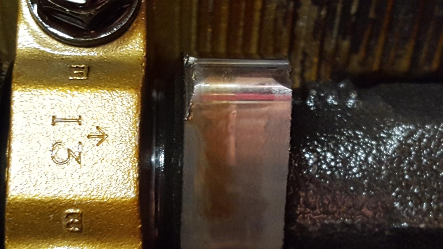

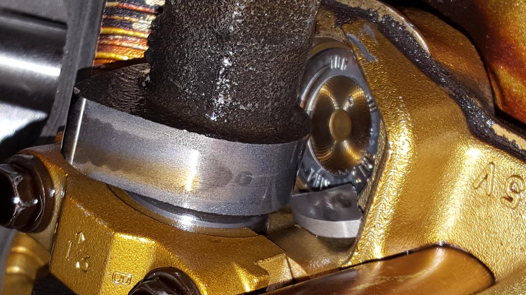

Bad news. The RH cylinder head spit out a shim and caused the engine failure. The intake side has 0.030" shim spacers which allowed a shim to pop out and cause it to shatter and pieces scattered into the engine. I found most but there's shards of it everywhere and it marred the cylinder head, causing the valve to be stuck open. Thankfully the valve is intact but it looks bent. The cam lobe on that shim is damaged as well.
I will not be installing the Colt Cams in the next engine, which is a bummer. I am now part of the "don't use shim spacers" crowd as I see what kind of damage it can do if something goes wrong.
I'm a little confused here Jerod. I thought there were shims for all the valves, and when you do a valve adjustment, you just adjust the size of the shim based off the readings you got with your feeler gauge. Was the "Spacer" something placed on top of the shim. So, instead of just buying a shim the correct thickness you needed, you added a spacer to get the needed height that was required?
That is too bad. By the look of it the engine was in good health...
It actually isn't. I had lost compression in cylinder 6 years ago and recently the compression was starting to tank across all cylinders. Plus it has like 5 oil leaks lol.
Aftermarket cams often come with shim spacers to bring the clearances closer since they are regrinds. These ones had 0.030" for the intake and 0.015" for the exhaust. Unfortunately for me, it allowed the shim to ride too high on the bucket and found a way out.
