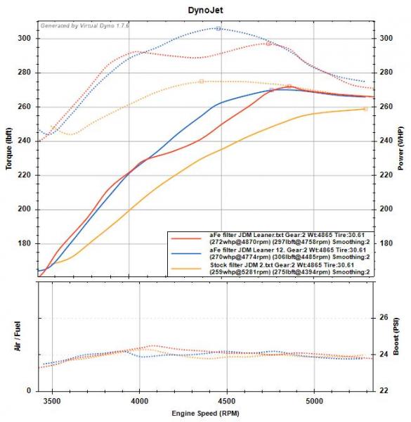

Had some time to smooth out my AFR's. Did a few runs today and found that 12.1 - 12.2 AFR sits reaaal nice. Here's the final result.
Blue is new smooth AFR with aFe filter
Red is leaner AFR with aFe filter
Orange is stock filter with old tune
gamefreakgc-albums-engine-performance-mods-picture55402-afe-filter-leaner-afr-12-1-a.jpg
In total, the change from going from 11.3-11.5 AFR's (my AEM was reading the AFR innacurately by 0.3) to 12.1 - 12.2 and changing the air filter to the aFe Pro 5S has netted a gain of 11 RWHP. But that's only part of the story, since peak torque has improved by 31 RWTQ! I can really feel the engine pull in the 4000-5000 RPM range!
HP Increase:
+12 HP
Running Total:
+121 HP
P.S. on a side note, I tried altering the MAF signal to trick the ECU into showing more timing. Yeah, that didn't work, ran like absolute garbage!
What software is providing the graph data?
Virtual Dyno, it takes data logs in .txt, .xls, and other formats and calculates TQ and HP based on RPM, speed, elapsed time and anything else in the log.
The AEM FIC 6 creates .txt logs. I took an actual dyno run and fiddled with the weight until it matched the power output measured on the the dyno so these numbers should actually be in the ballpark.
I can "feel" a difference but it's hard to tell how much of a difference it makes. This program confirms the difference and puts an actual number on it.

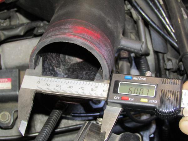

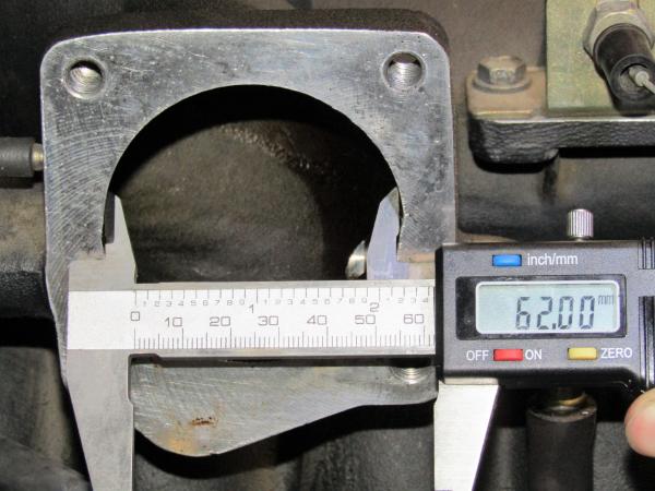

Took some time when swapping throttle bodies to measure the sizes of my existing intake piping. Here's what I learned:
The supercharger itself measures between 62-62.5mm depending on where you measure (it's not completely round because of the bend). I was actually surprised to see it's bigger than the throttle body, which confirms my theory there's power to be gained with a larger throttle body. Not only is the stock TB 60mm, but it's also got a thick valve which restricts flow.
The maxbore TB will be 63.5mm which is just about perfect. Having it slightly larger than the supercharger it not a bad thing, since you want a slightly larger bore to equate for the valve itself and the flow it restricts.
The one problem I did encounter is the Airaid intake tube. It's only 60mm:
Thankfully it's plastic so gonna borrow a dremel and bore it out by hand as best I can. Want to get it at least to 63mm. We'll see how that goes.

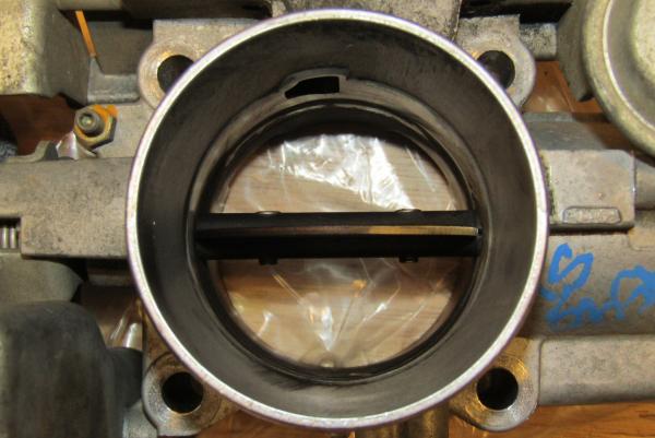

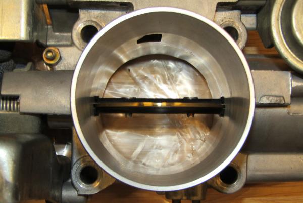

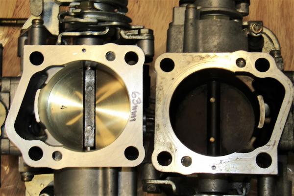

I had my throttle body shipped off to Maxbore.com to be bored out slightly, have the shaft machined down and matched the intake of the supercharger. It turned out pretty good:
Stock size:
You can notice the thinner shaft. Here's the two side by side, notice the thickness of the IAC passageways on the bottom and the difference between the two:
Some measurement comparisons between the two:
Front
Stock - 66mm
Maxbore - 66.4mm
Middle (as close to the throttle valve as I could get:
Stock - 60.4mm
Maxbore - 61.9mm
Rear
Stock - 60.4mm
Maxbore - 63mm
