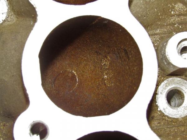

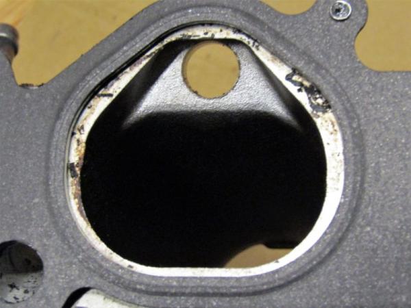

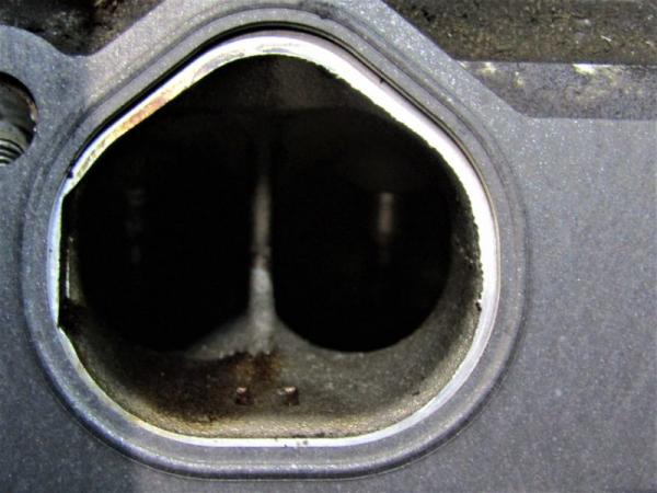

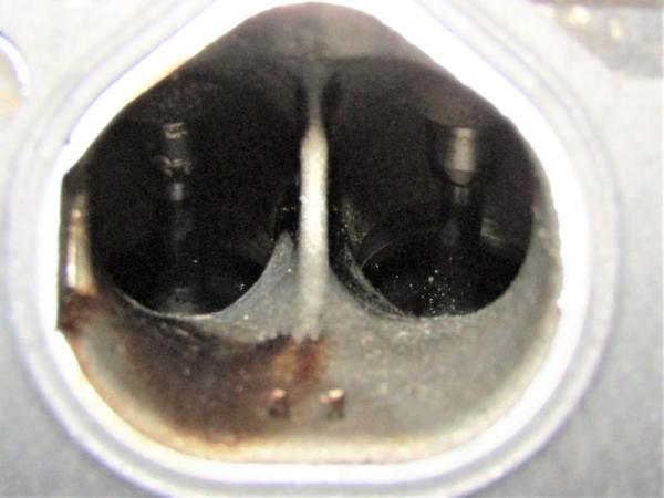

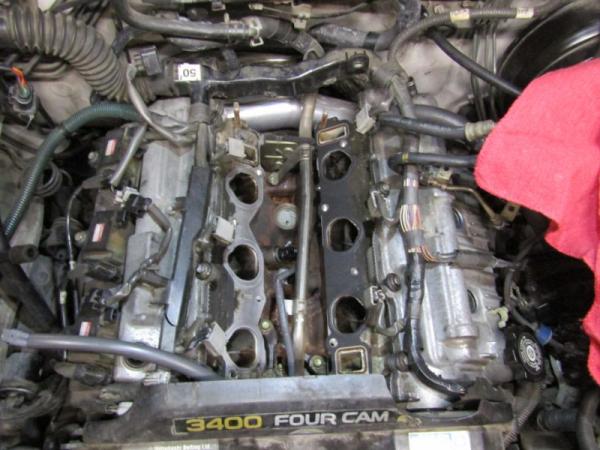

Also, there's some real gains to do a good gasket match port on the intake manifold and the cylinder head. Also some casting flaws.
Cylinder head (see size of gasket vs size of intake port)
Intake manifold
Casting flaws on intake manifold
And in cylinder head
