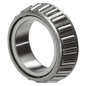

I had a local shop do the work, since I know diddly-squat about differentials. Turns out my differential bearings were also destroyed and were causing a ton of noise but I never knew since I got it that way! These are the bearings that were completely shot, he showed me what mine looked like and they were gauged out so bad. I should have taken a photo, but these are the ones I'm talking about:
So I drive it around and when decelerating, it's so quiet! I can't believe how thrashed mine were, I always thought that grinding/whining noise when I let off the gas was the supercharger rotors! Nope, it's the rear end making a ton of noise.

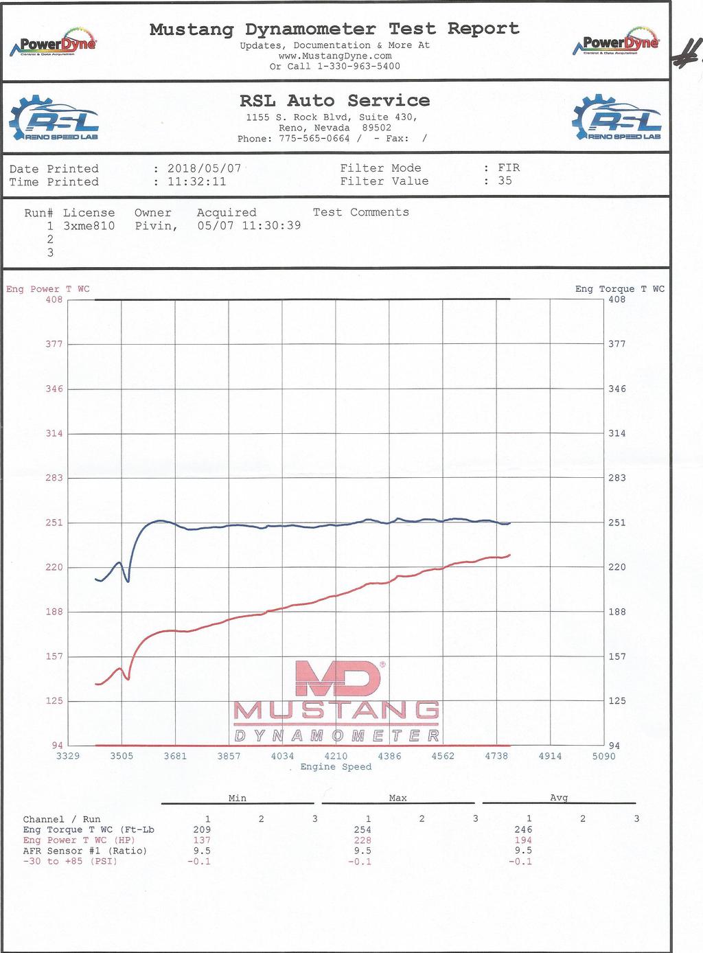

Have my dyno run scheduled for Monday. I've been looking at a few dyno charts of new, stock vehicles and have an educated guess on where I'll be at power-wise.
The stock 4Runners dyno'd at around 145-148 RWHP when fairly new. They also have a drivetrain loss of 17%, this has been confirmed multiple times with stock 4Runners on a dyno. Add a TRD supercharger, and that jumps to about 185-190 RWHP, when new (don't get confused with peak vs maximum gain, peak supercharger gain is 40 HP while maximum is 62 HP).
Enter my 4Runner with 200k miles. My wife's 2011 Altima puts out 203 HP at the crank, and my 4Runner was slightly faster than it 3 years ago so I'm guessing I was not too far off from the 180 RWHP mark, seeing the Altima was putting out around ~170 RWHP.

First Dyno Run Results
<iframe width="560" height="315" src="https://www.youtube.com/embed/0hIotwCwv_o?rel=0" frameborder="0" allow="autoplay; encrypted-media" allowfullscreen></iframe>
Dyno run is complete, but with mixed results. Ran into some problems due to the elevation and the speed governor! Short version, on a Mustang dyno (more on that later) I made 229.1 RWHP and 256.6 TQ at 4800 RPM. Those numbers seem a bit low? 'Cause they are. There are 3 main factors on why it dyno'd low:
1. The shop is at 4400 ft elevation. I knew I'd drop a little boost but what I didn't realize is that atmospheric pressure AND boost pressure are lower. So my F/IC 6 is tuned based on both of them. It reached a max of 11 PSI boost at 14.7 atmospheric pressure at sea level but only 12.7 atmospheric pressure at 9 PSI of boost at 4400 ft. So my tune was off by 4 PSI! It was basically useless. I had to created some new values on the fly and didn't get it back to 11.5-11.8 AFR's until the last run. The first run made the same power at 10.2 AFR on the bad tune, so I lost about 10 RWHP just from heat soak alone (difference between 3rd run with bad tune and 5th run with good tune). This was unexpected for me and a bit of a bummer.
2. The dyno run needed to be done in 3rd gear because it has a 1 to 1 drive ratio. However, the governor kicked in at just under 110 MPH and kept cutting fuel! We could not get past 4800 RPM without it cutting fuel so I don't have the full HP and TQ curve to ~5500...
3. It's a Mustang dyno so the numbers are lower than a Dynojet. The technician explained the difference, he said it reads more consistent since it applies force to the rear tires similar to that you see on the road since there's resistance against the rollers. This makes it really nice for getting a tune on it since it will mimic the conditions you'll see out on the street. He said if I had gone to the other shop and town and ran it on the their Dynojet, I would have made 280 HP on paper, that's how different they are.
So overall, I learned a lot about my vehicle and how it performs. Did it go as I had hoped? No, the two major issues I encountered were a bit of a disappointment, but at least I have an idea on where I'm at. I'm even more tempted than ever to put 4.56's or 4.88's in my rig, since that'll lower my speed but increase my RPMs, since 700 of top end RPM's in 3rd are basically unusable! But look at how flat that torque curve is... gosh is it fun to drive!
