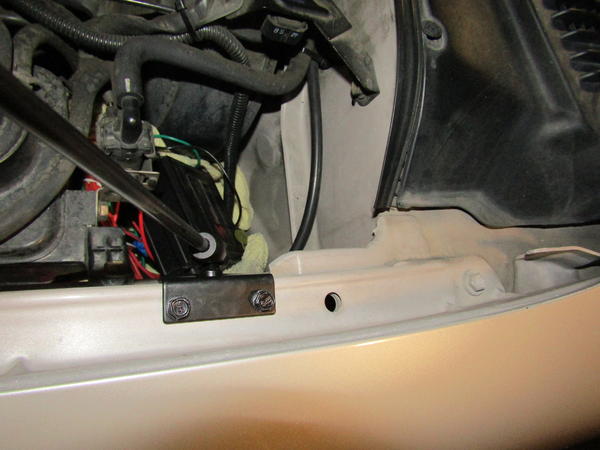

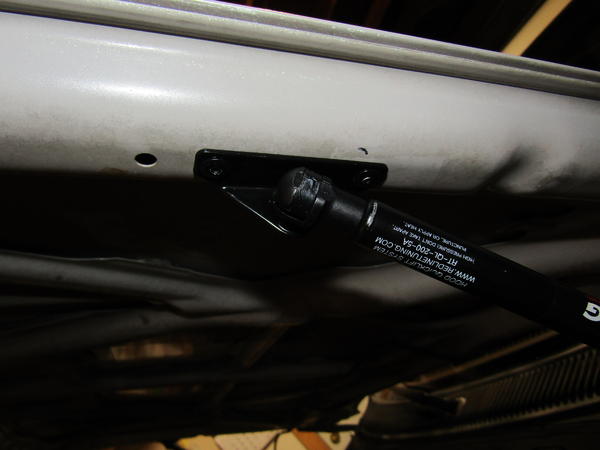

I ordered the hood struts from Redline Tuning: 1996-2002 Toyota 4Runner Hood QuickLIFT PLUS. I went with the Plus line for better mounting hardware but there's a more economy line for less. I won't go into too much detail here because the instructions were very good. They tell you exactly where to drill the holes for the brackets so that it matches perfectly, you just need a sharpie, a drill with bits, a riveter and a punch (I used a small Philips screwdriver). Here's my photos for reference:
Top bracket:
Bottom bracket (it's flush against the frame in the corner):

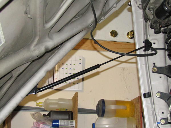

Finished installation (can't rotate the darn photo):
I absolutely love the struts! In the last photo, you'll notice some nifty LED lights shining in my engine bay! Also one of those WHY DIDN'T I DO THIS SOONER sort of things.

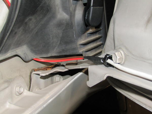

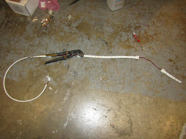

I first cut the LED strip per the markings to make the LED strip a bit longer. I wanted more light spread out across the engine bay. I used the connectors to easily attach the LEDs. Make sure you don't accidentally reverse the polarity like I did.
I then install the pinswitch on the frame, right next to the rubber hood bump stop above the driver's side headlight. I realized too late I should have drilled it on a flat, even part of the frame but it worked out ok in the end.

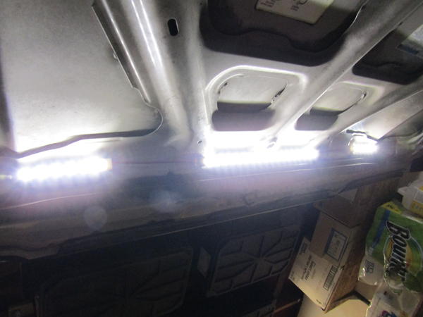

I then cleaned the hood off, used the adhesive promoter and attached the LED lights in the crease just behind the rubber gasket. I ran the power wires down the hood and was careful around the hinge - it can snip your wires in half if not routed correctly.
Here's how the lights sit under the hood with it on:
And the finished product:

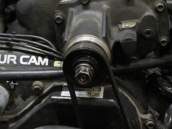

2.0" Pulley time!
It's officially installed! Gosh it's small:

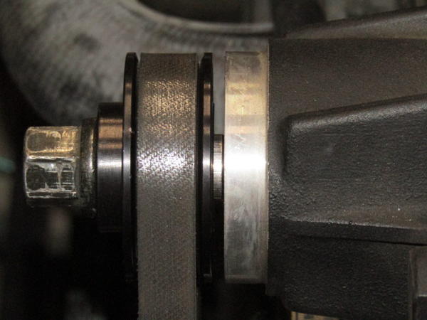

I noticed that it didn't fit flush with the snout. I was going to bust out the impact wrench when I realized if it's flush, 1 of 2 things will happen:
1. The pulley is so small that it will rub on the snout housing. I've heard of some having this problem.
2. I'd never get it back off! The puller didn't grip the inside edge without slipping/scratching, so this allows me to catch the edge or insert a washer or something for more leverage.
I'm working on a basic tuning map based off the one I created for the 2.1" pulley. I don't want to go WOT until I figure out how much PSI of boost I'm making and ensure that I have enough fuel.
