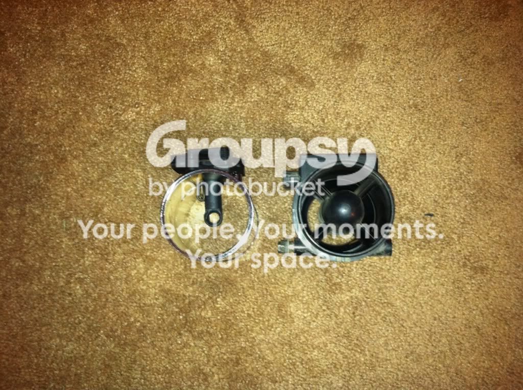

I want to free up as much airflow as possible, and heard of this mythical "MAF swap" from the turbine design to the smaller MAF in newer 99-02 4Runners. Here's what I am talking about:
a6329712.jpg~original
Smaller restriction = more air flow. Turns out, all you have to do is move the black wire from the end, over 4 spots like this:
Thanks to [MENTION=106741]bambi_runner6[/MENTION] for the photo! Hoping this photo lives on to help others and to encourage people to learn Elvish.
So all that is needed is a small screwdriver. First, pop out the white lower section of the MAF plug. Pry under it and it'll come out. Next, you'll see little black tabs under each wire connector. Pull on the wire a bit on the backside while prying the little tab down. It should pop down and stay in place. Do this to all five wires and pull them out the back of the connector.
Next, move the black wire from the end to the second to last position as shown in the photo. No other wires move around. Then reinsert the wires until each one "clicks" in place. Re-insert the white lower portion and you are done!
What's interesting is that my Long-Term Fuel Trims went from roughly +9% (from the deckplate and Airaid tube) to +19.5%. I'm flowing roughly 10% more air in than before, not bad! The computer adjusts just fine to the newer MAF's as well. Now that I've got more airflow, it's time to crank up the boost!
P.S. You will also need to swap the airbox with the 99-02, since the MAF sits in the airbox, while the turbine style actually is part of the intake.

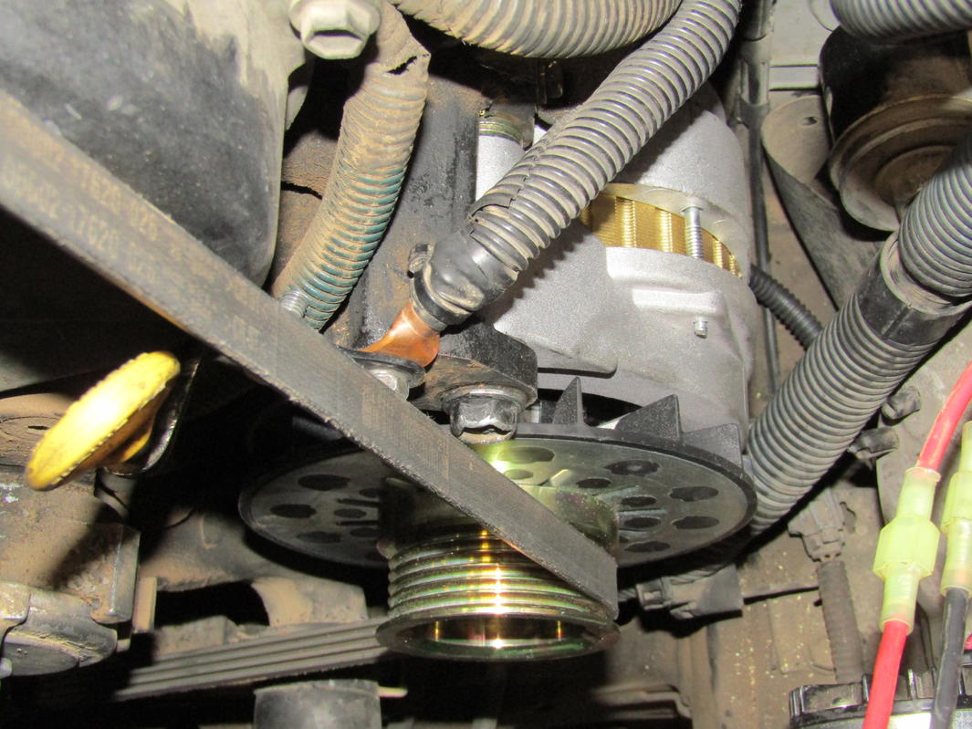

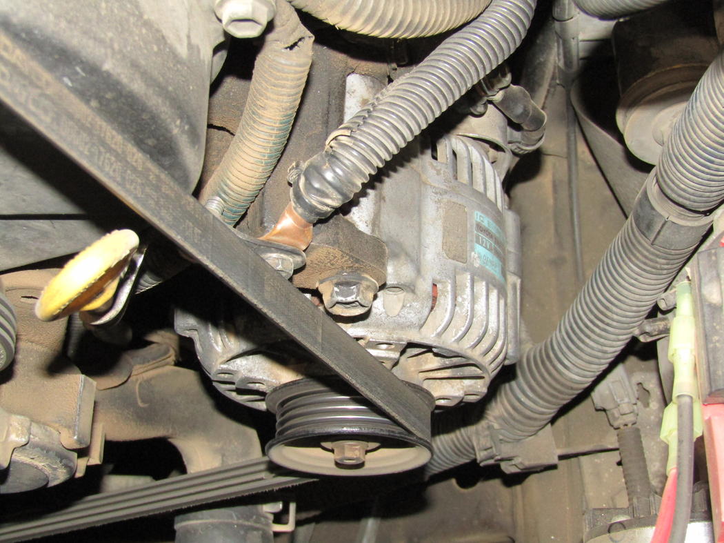

CS144 Alternator Upgrade
I actually did this over a week ago, but been out of town and busy with other projects so I haven't had a chance to post anything.
My alternator has been giving me trouble for a while, but over the past few weeks it really had become bad. I tried rebuilding it with new brushes but it still wasn't up to the task since I have an electric fan that pulls 20 amps when on and the stock amp puts out about 75 amps total. My battery (Red top Optima) was up to the task of keeping my rig from dying but it was clear I needed something better.
Enter the CS144 alternator. It's a common swap for many vehicles since it puts out a whole lot more amps, almost double a stock 4Runner alternator. It was completely plug and play with these parts:
https://www.ebay.com/itm/Alternator...e=STRK:MEBIDX:IT&_trksid=p2057872.m2749.l2649 - $20.35
https://www.rockauto.com/en/moreinfo.php?pk=3467661&cc=1025783&jsn=409 - $110.79
A set of Dorman washers I picked up from O-Reilly's - $15. They didn't have the size I needed in a small container, oh well.
The swap was actually pretty easy, I used Doc's tips and photos here: http://www.toyota-4runner.org/3rd-gen-t4rs/135318-docs-cs144-alternator-upgrade.html. Since I have a supercharger and the dynamic tensioner gave me some extra slack, I just took out the old unit, and put in the new. The only hard part was wiggling the new alternator in there since it's a tight fit. I ended up taking out the battery for more space. Also, the nut on the back is a little tricky to get a wrench on but it's not impossible.
Overall, I went from 11.7 volts at idle and 12.3 under load (measured at the OBD port, not the battery) to 12.4 at idle and 12.9-13.3, depending on heat soak. A huge improvement and my battery is no longer draining.

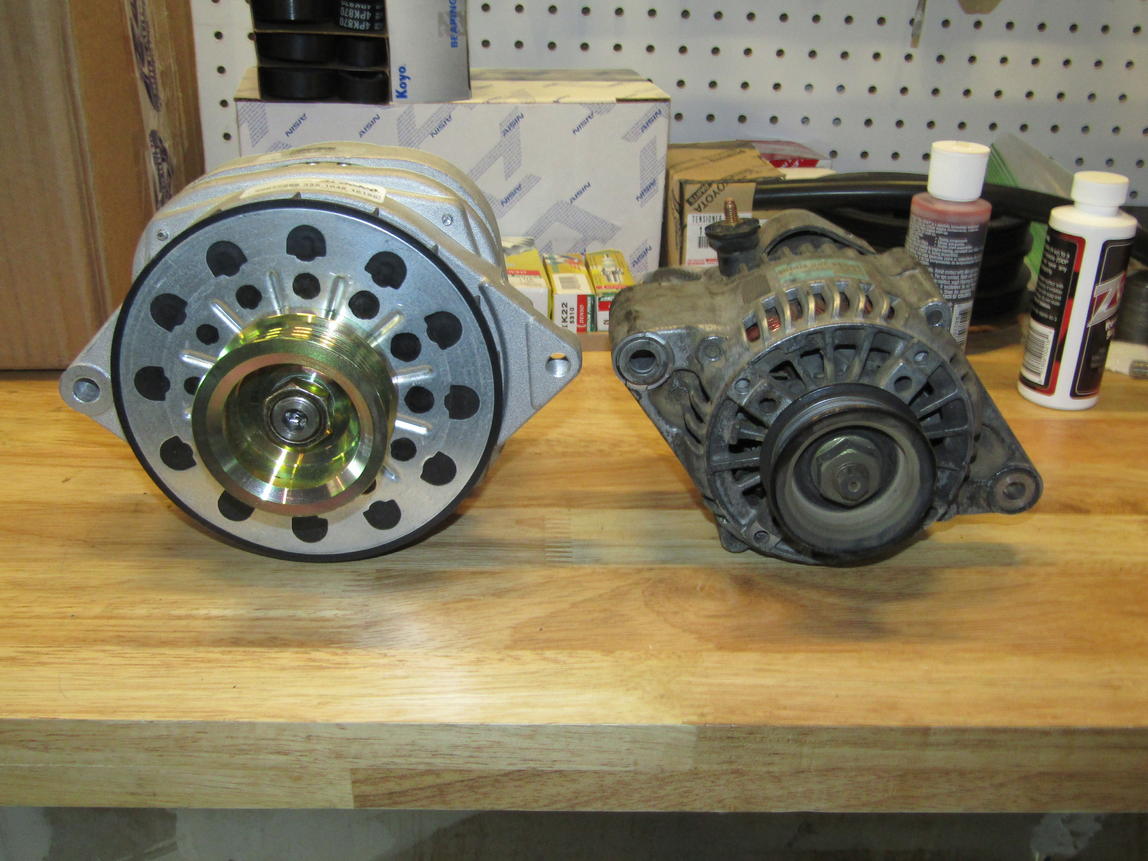

Photo comparisons of the old DENSO unit (small) and new CS144 (large).
