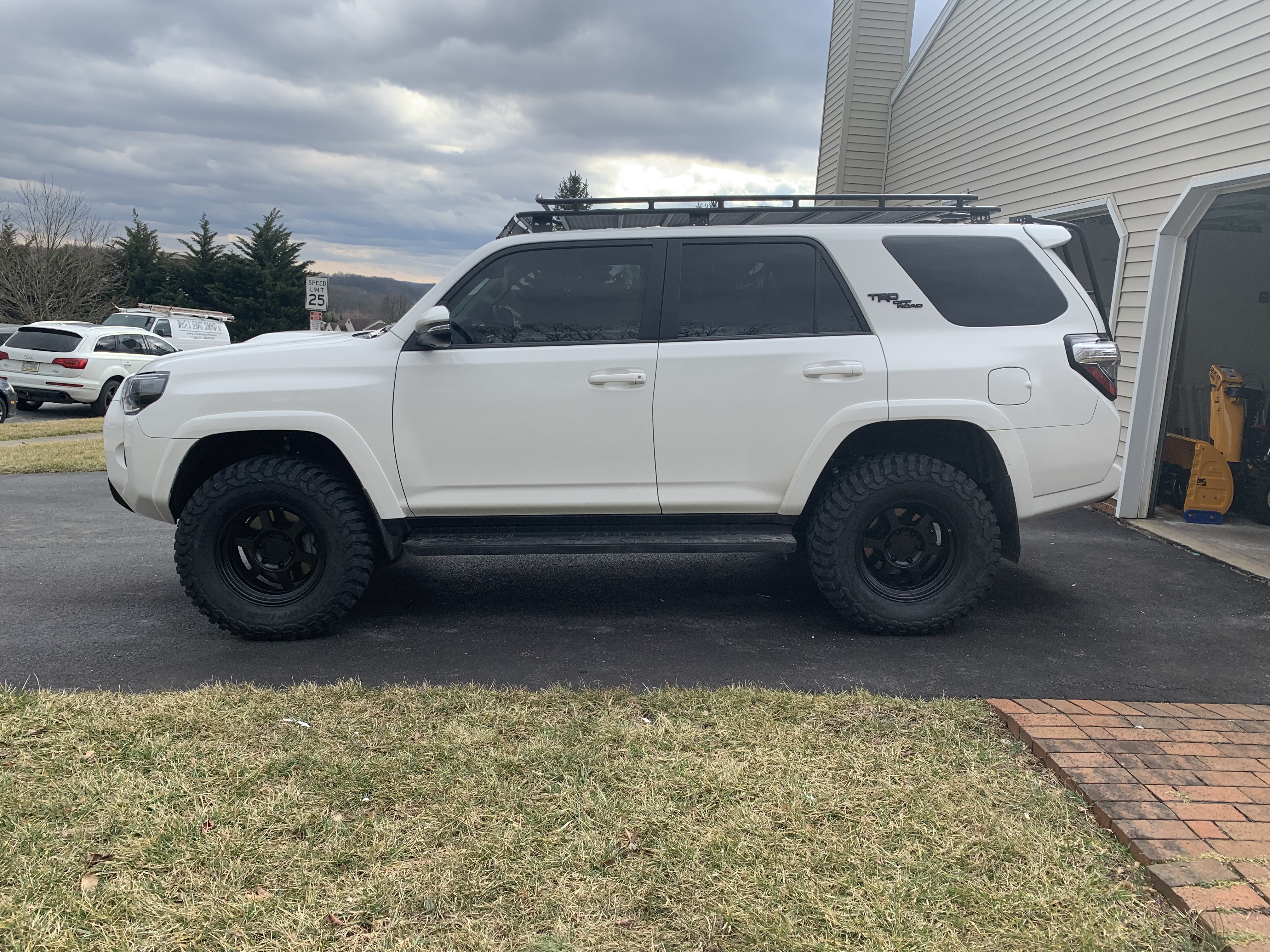

I tackled the install last weekend. It took a couple hours longer than it should have. First mistake was wasting a ton of time fighting KDSS on the front passenger side. End result was removing the front skid plate to access the KDSS piston on the drivers side. Once that was accessible it was easy to compress it using a jack, making the passenger side fall low enough to get the CO in. Same thing on the rear; just a lot of trial and error with the KDSS. Also getting the washers on the long UCA bolt is such a pain in the dick. Anyway, end result is great. Really loving the Icon equipment. Suspension pic is before the KM3s were mounted. A few days after the install we got a decent snow. Here's a pic on the snow day as well.

Looks great!
What is your center hub to lower fender lip measurement in the front?
Those tires are badass.
