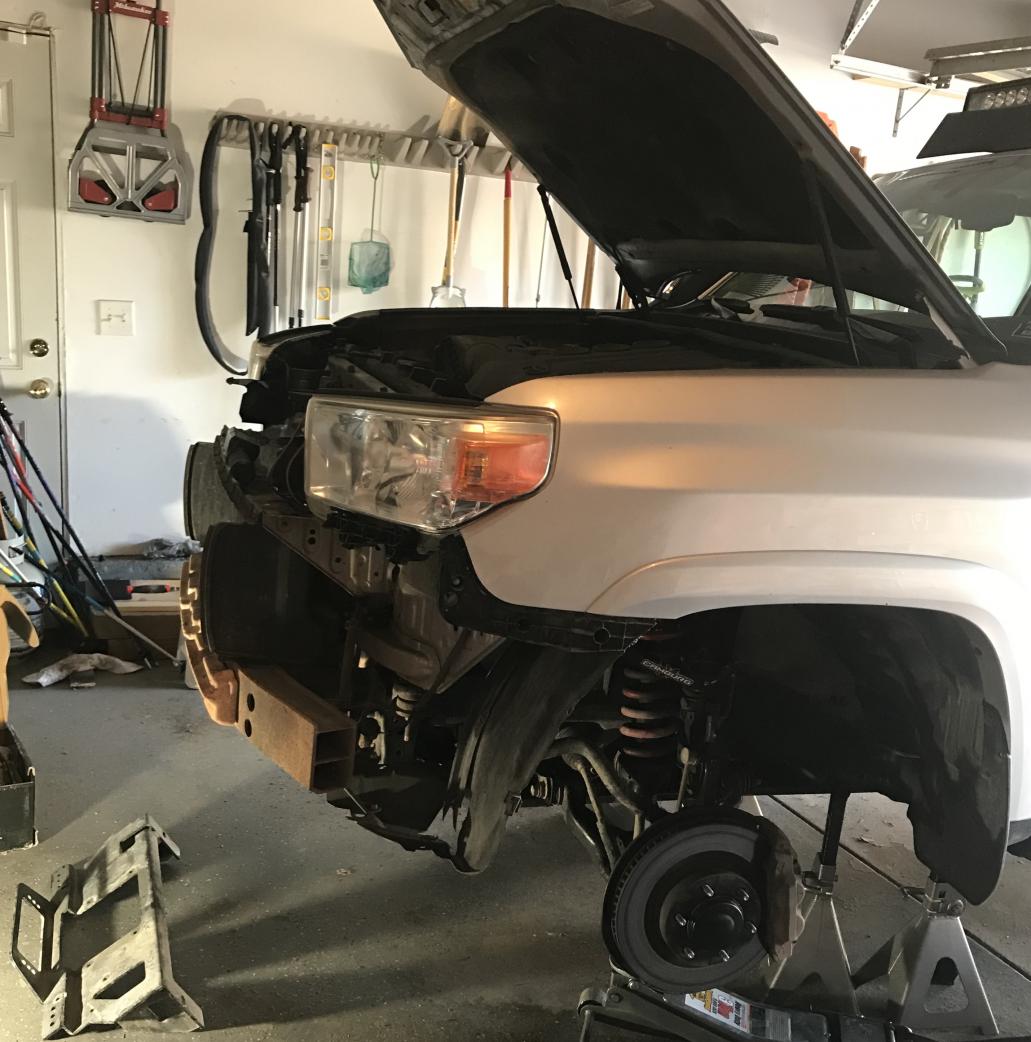

Truck is apart... after thinking we’d get the new Elka suspension in easily we found quite of bit of wear on stuff in the front end. So more parts ordered and hopefully I’ll get it all done next week. Winch, new suspension, rebuilding UCA’s, replacing LCA’s, a few random other items as well.

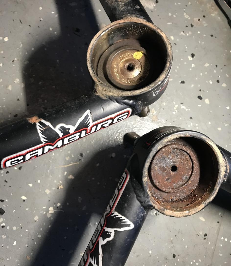

You want to see what abuse and neglect do to a UCA ball joint...

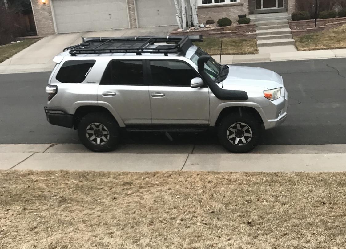

Suspension is done and truck is driving straight. What a PITA this project was. I’ll compile everything and post it up next week, given the age of my truck I’m sure others will hit some of the issues I did. New suspension is riding nice, I’ll discuss that after I get more miles on it. So happy to be driving the truck again... this beats by 3 day snorkel install with almost a 3 weeks to get the suspension start to finish. :ranger:

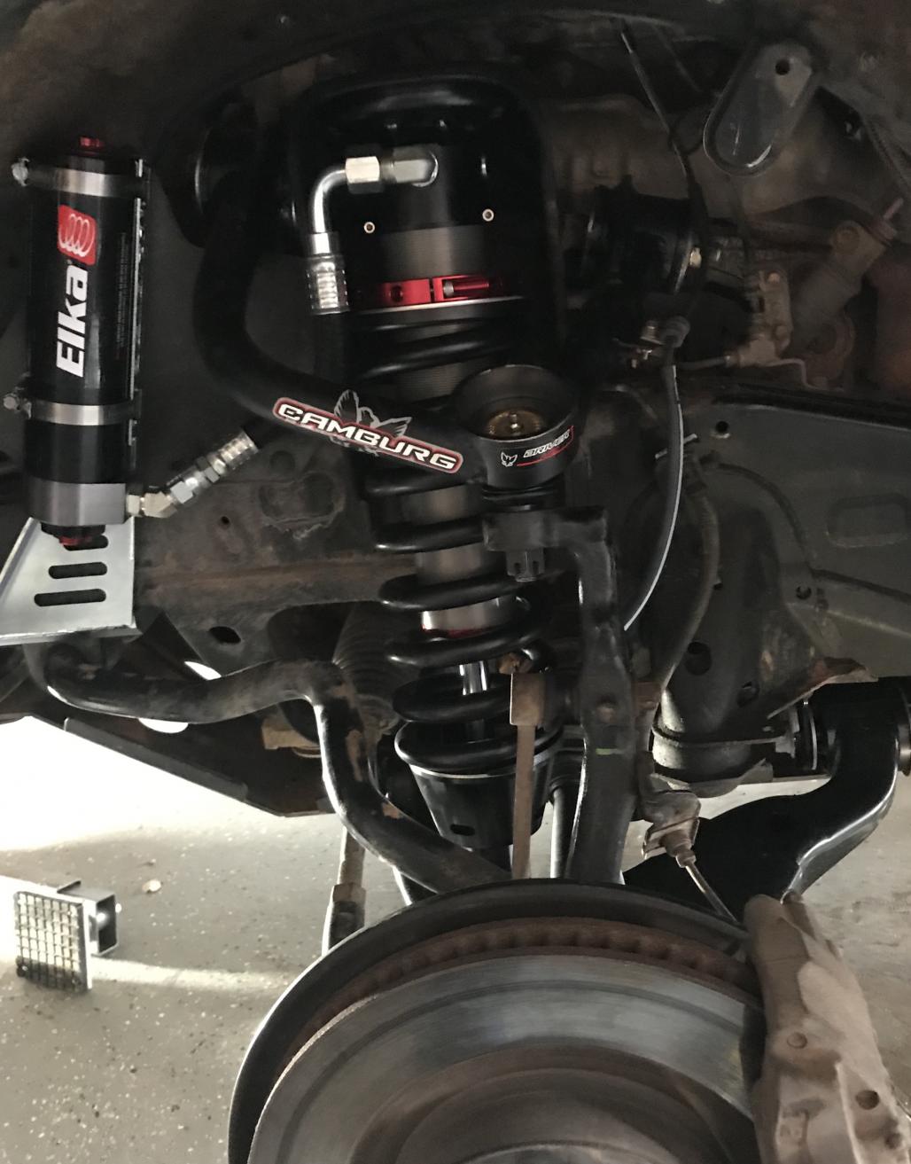

I ended up swapping out Camburg UCA for SPC to get able to get enough caster and align it. PITA.
Was it the age of the Camburgs or can they simply not provide enough adjustment?
They have some extra caster but not enough. I had stock UCA’s when the Boss suspension went in and it was at the low end of range for caster with about 2 1/4” of lift, I added Camburgs a little later and got more. With just a little more lift on the front the Camburgs just didn’t have enough, they looked solid though after clean up considering 5-7 years of use and mag chloride here in CO. Which was frustrating since I just rebuilt them and all the time I spent cleaning them up. :der:
Knowing I’ve got some more weight changes coming for the front (battery/electrical wise) I needed the flexibility if I need to adjust things. :couch2:
