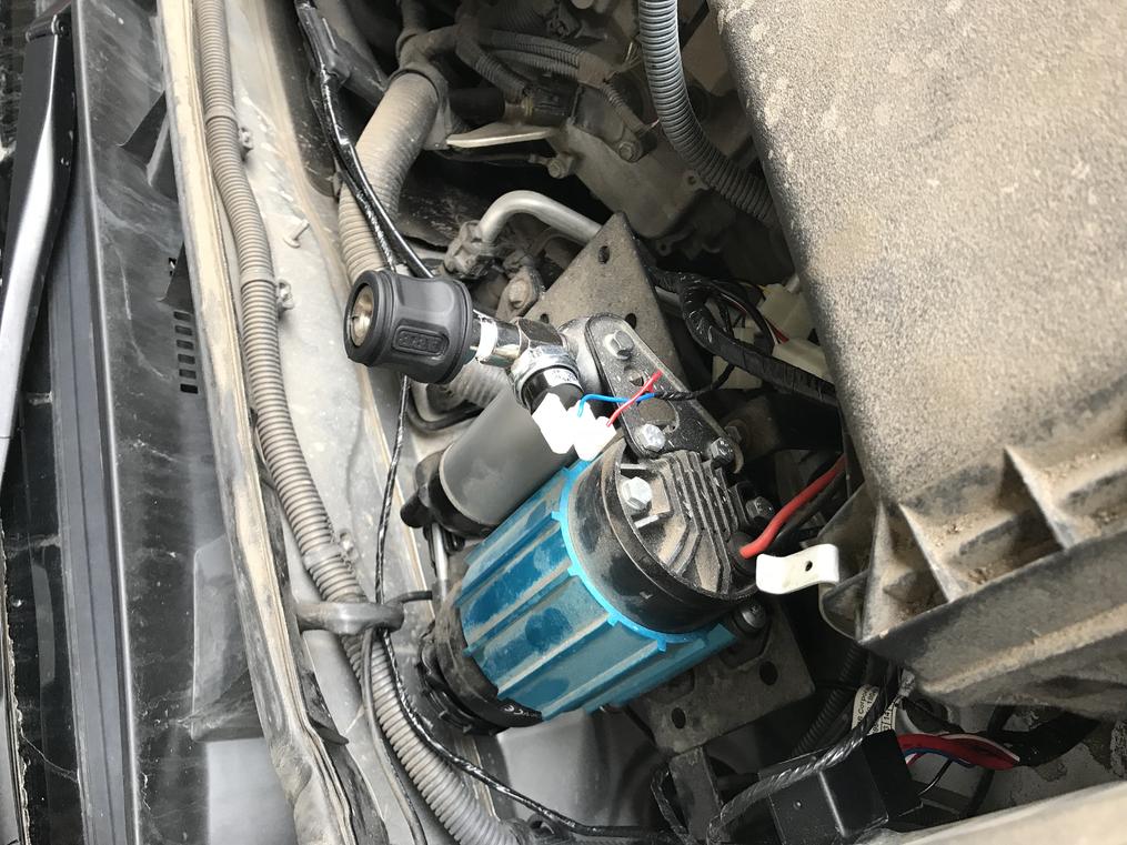

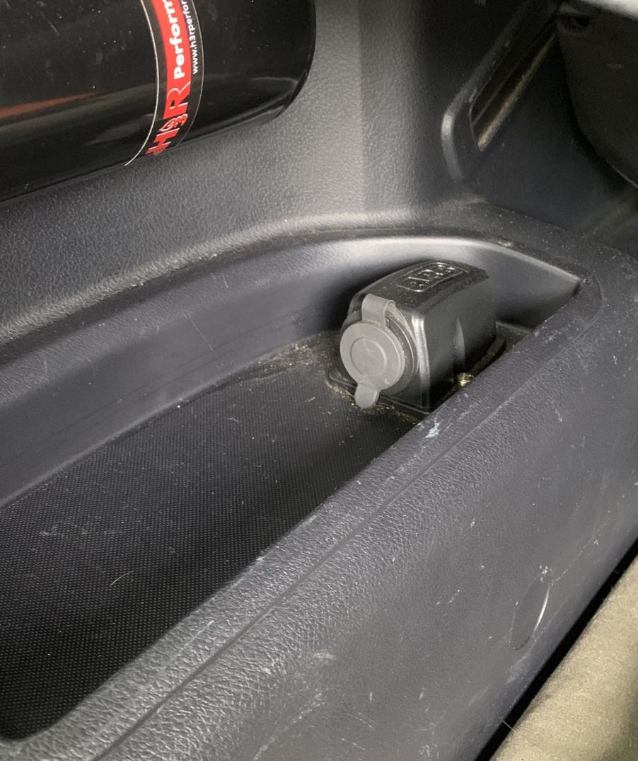

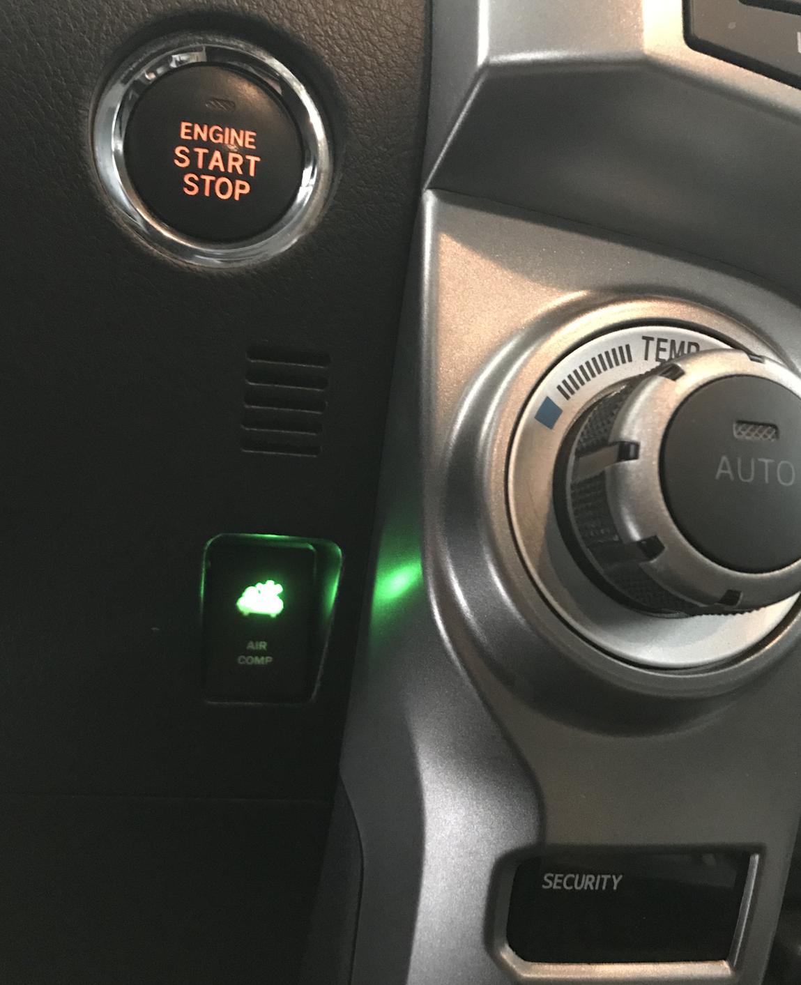

Prepping for heading out on the road, finally finished up wiring for under hood compressor.
Also turned Party Mode into Compressor Mode!

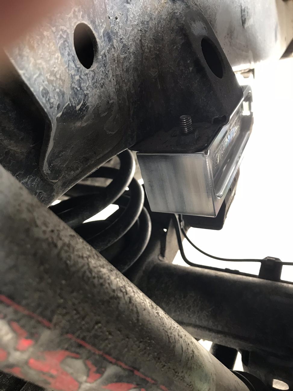

Also finally installed extended bump stops...

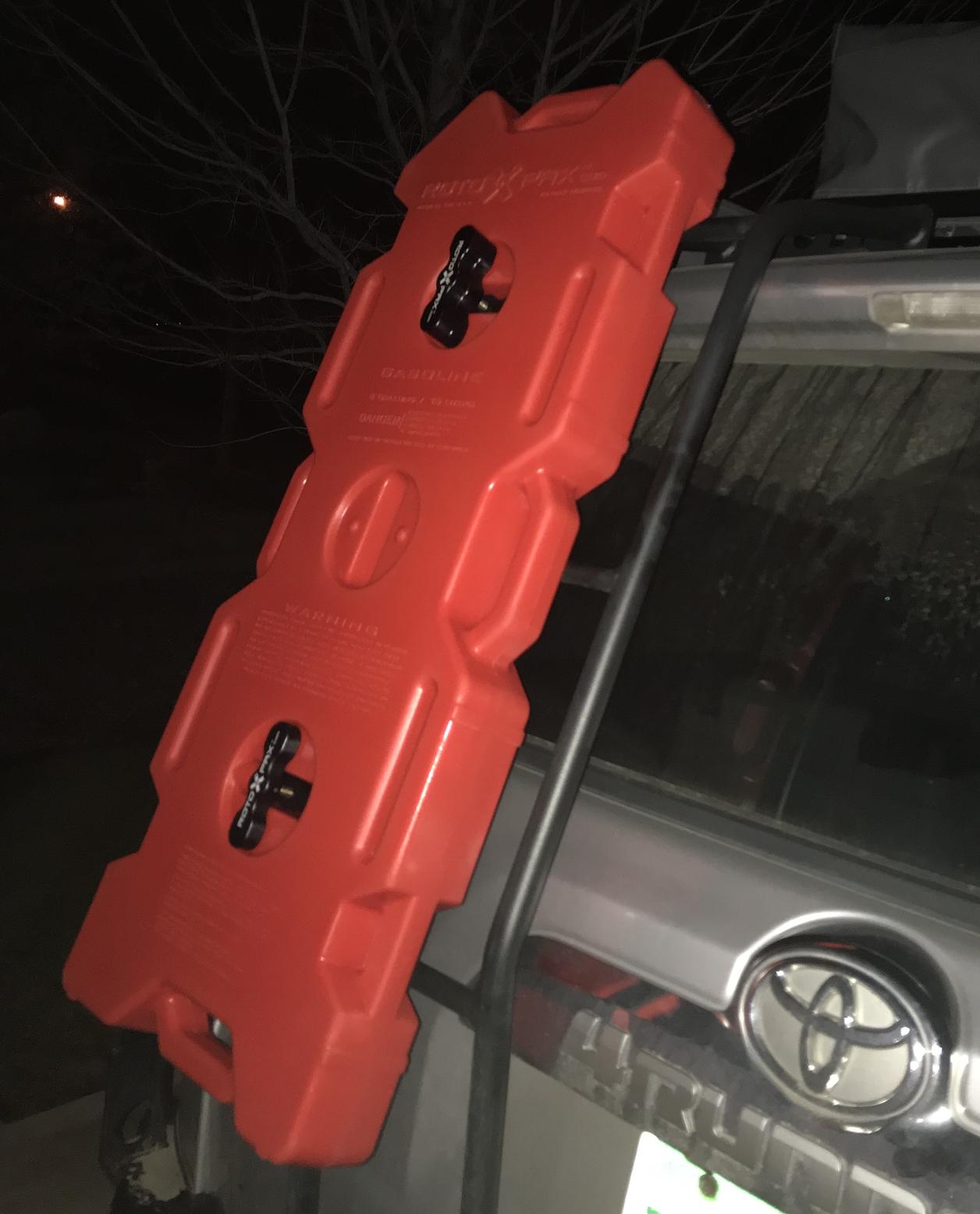

There may be a need for extra fuel on this trip (more likely someone in the group).

WOW do you have a DIY on how you changed your key start to push button? I'm assuming you had to get a new key fob and reprogram it to the car.
That's super cool!
