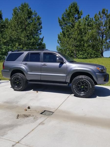

My XREAS is failing so I decided to go with an upgrade!
A little teaser pic for ya.
Ended up going pretty smooth install wise. I love the way it looks now and especially how it handles.
Removed the XREAS system of course. Old system was leaking.
First pic is stock
Second pick is with a spacer lift. "3/2" Cornfed/Daystar
Remaining pics are end result of 6112s/5160s
Stock
Cornfed/Daystar spacer lift
Bilstein 6112 @ 4th notch with BurtmanIndustries small spacer in Front
Bilstein 5160/Wheelers springs rear
I haven't tested the down travel and the CV angles are decent. According to 4Wheel parts (did the alignment) the angles are great.

So what are your hub to fender measurements?
** Not sure if you changed something, but they are showing up now! Looks sweet man! **
I did use Photobucket yes, but I just changed it and used this sites photos. Hopefully they can be viewed now.
Front hub to fender = 24.5"
Rear hub to fender = 25.5"
That's crazy that yours sits so much taller. I have my 6112's on the top setting and I'm only at FR: 21.75", FL: 21", RR: 23.5", RL: 23.5". I need to figure out how to get mine to sit higher!
