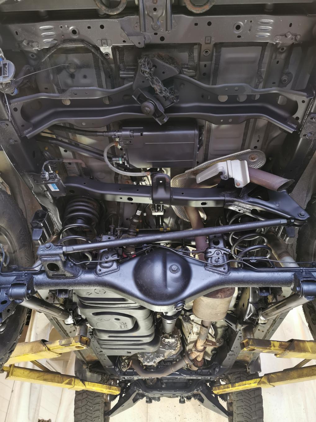

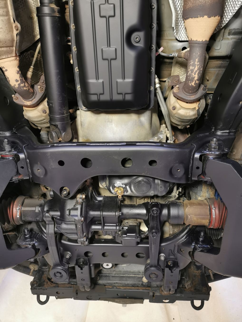

Truck is in at Sublime Surfacing (Edmonton, AB) for rust proofing. Not that I've had rust issues, but the city has been using calcium chloride spray on our roads, and I'm not willing to watch my 4r rust.
Ted and his crew first dry ice blast, then apply enamel undercoat, and finally finish with a wax coating to resist corrosion.
Whatever kind of black magic they work, they do an amazing job!
