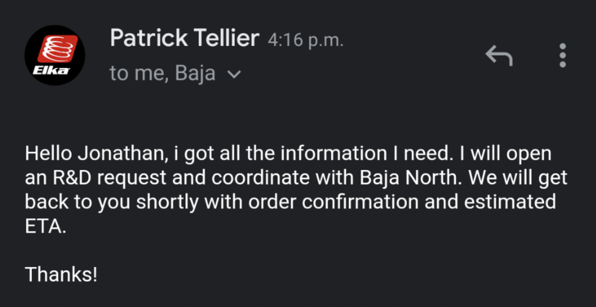

Method 105's and a set of Goodyear MTR's in 275/80r17 being ordered from 4 wheel parts tomorrow, and should be less than 4 weeks now before the new Elka's arrive.
