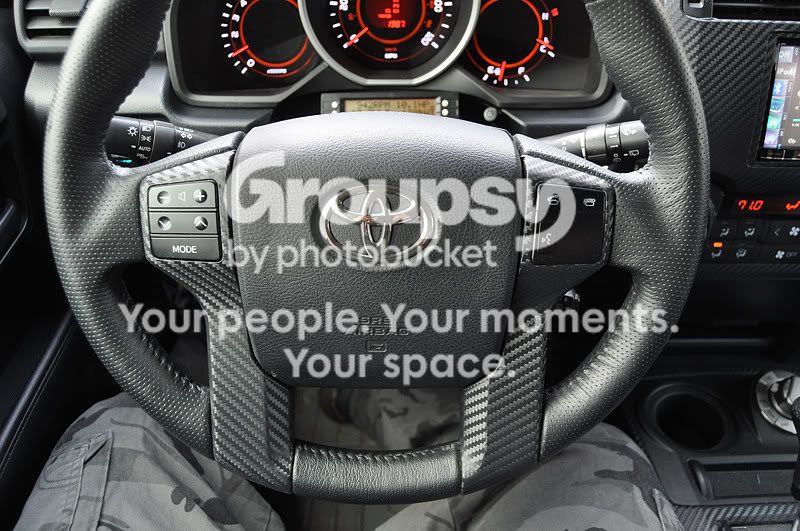

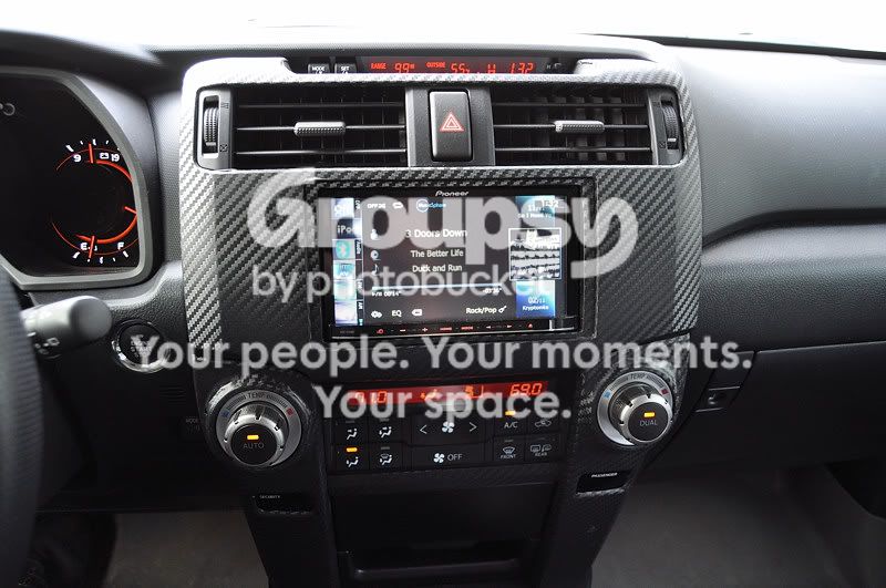

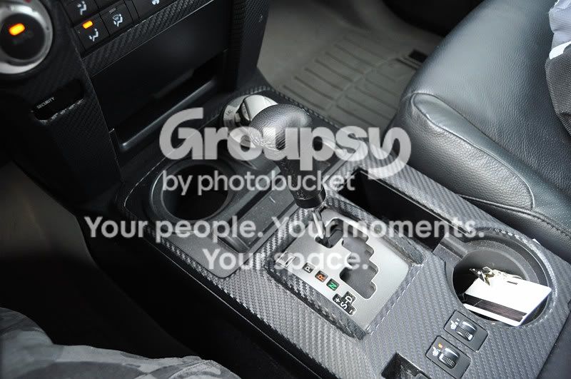

They make this carbon fiber vinyl that is really nice.It's actually textured like real carbon fiber. It called 3M Di-Noc and it's a little more expensive then Avery A9 because it's a little thicker and easier to work with a heat gun for curved spots. Your installer guy should know about it. Comes in a bunch of different colors too. Some of these space age vinyls 3M and Avery are coming out with are unbelievable quality.Alot of guys in the sports car world are doing their roof in it or even their whole cars.
I wrapped my interior silver pieces in that black Di-Noc Carbon fiber and like it alot better then the plain silver paint. The silver made my center dash look huge after I put a new stereo in.
Here's some pics of the Di-Noc I installed.....my first time and it wasn't that hard except you have to take the parts out to do it right.
CopyofPicture015.jpg~original
CopyofPicture013.jpg~original
CopyofPicture016.jpg~original
Wow, that compliments the interior perfectly.

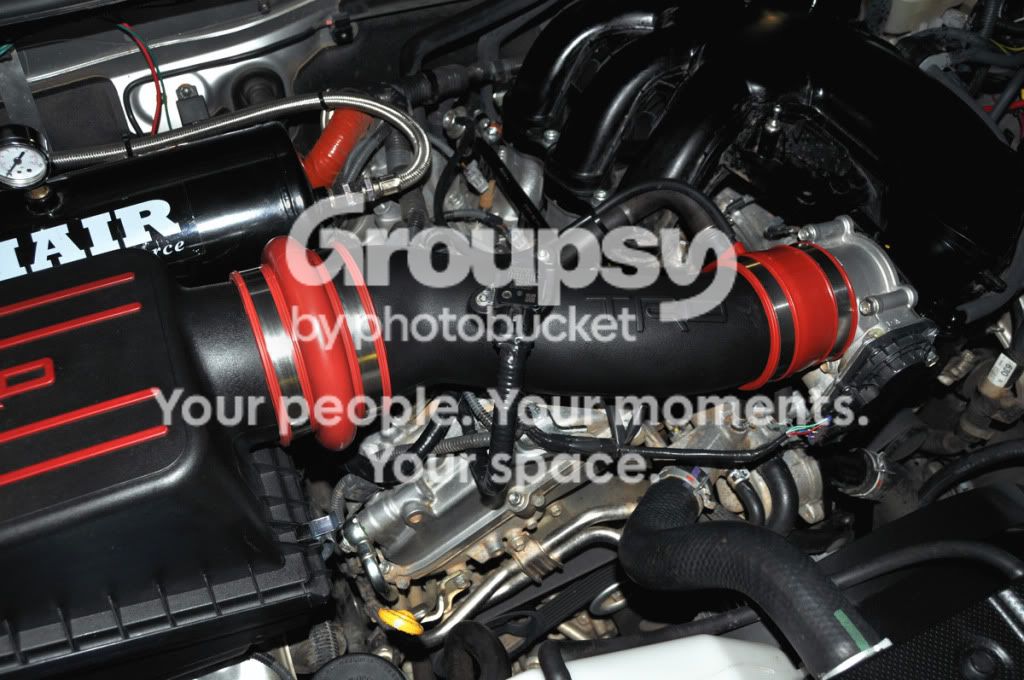

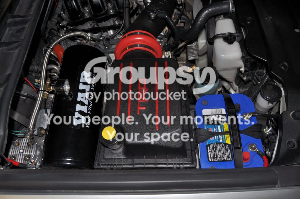

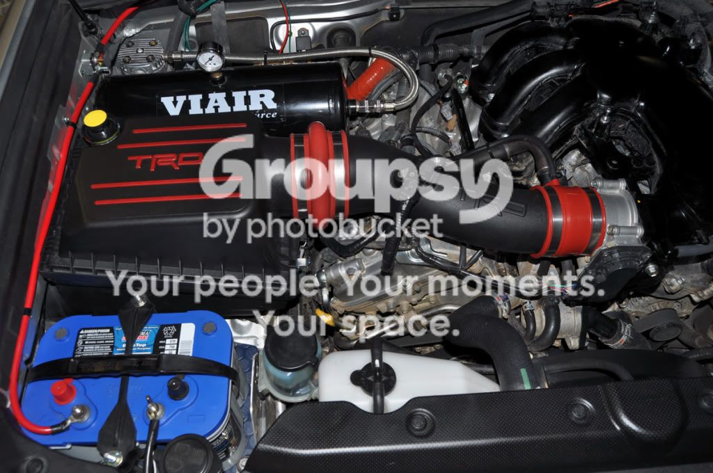

I also installed my TRD CAI and here are some pics. Fit was great and took about 2 hours.
Picture008-4.jpg~original
Picture014-3.jpg~original
Picture012-4.jpg~original
Picture016-5.jpg~original

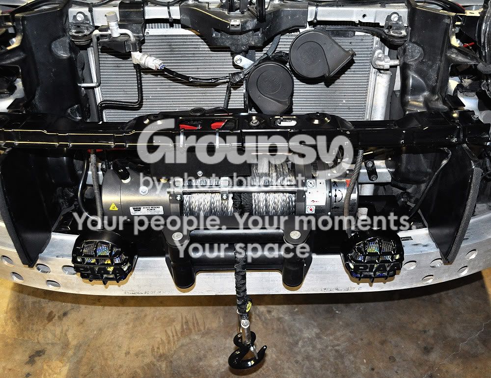

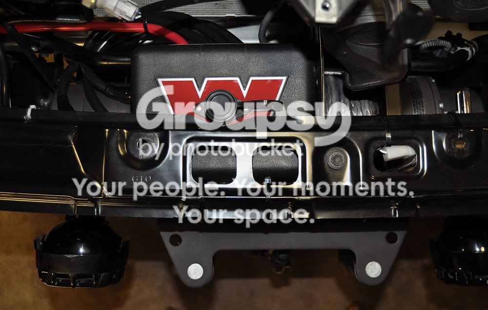

I finished up my Warn M8000 winch install with the new BudBuilt Internal winch plate for 5th Gens today for the stealth look. Kind of a tight fit for the Warn control box but I got it to work. It's a little off center and tilted as there's a center support right in the middle in the way.Might be easier to get new longer cables and mount it under the hood.I also had to redo the PIAA fog lights from the way I had them and just put some brackets off the winch plate.
Here is the link to the Thread on the Internal Winch Plate........BudBuilt Internal Winch
Here are some pics.....
Warn M8000 winch , Smittybuilt 10k synthetic rope and black Daystar polyurethane rollers.
Picture007-7.jpg~original
Looking straight down....I put the control box on top of the winch with brackets and trimmed the top brace a little for access to the plug where a wireless remote will plug in.
Picture012-5.jpg~original

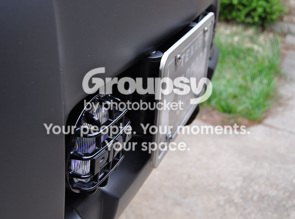

A front look with out the license plate.
Picture029-2.jpg~original

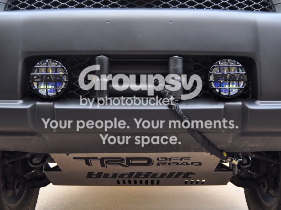

With the plate installed there is about a half an inch clearance.It's straight and even as the pic just makes it look like it's not! I used a Rugged Ridge roller plate holder and a stainless frame. Rugged Ridge Plate Holder
Picture046-2.jpg~original
Thanks!
wow! Nice work!
