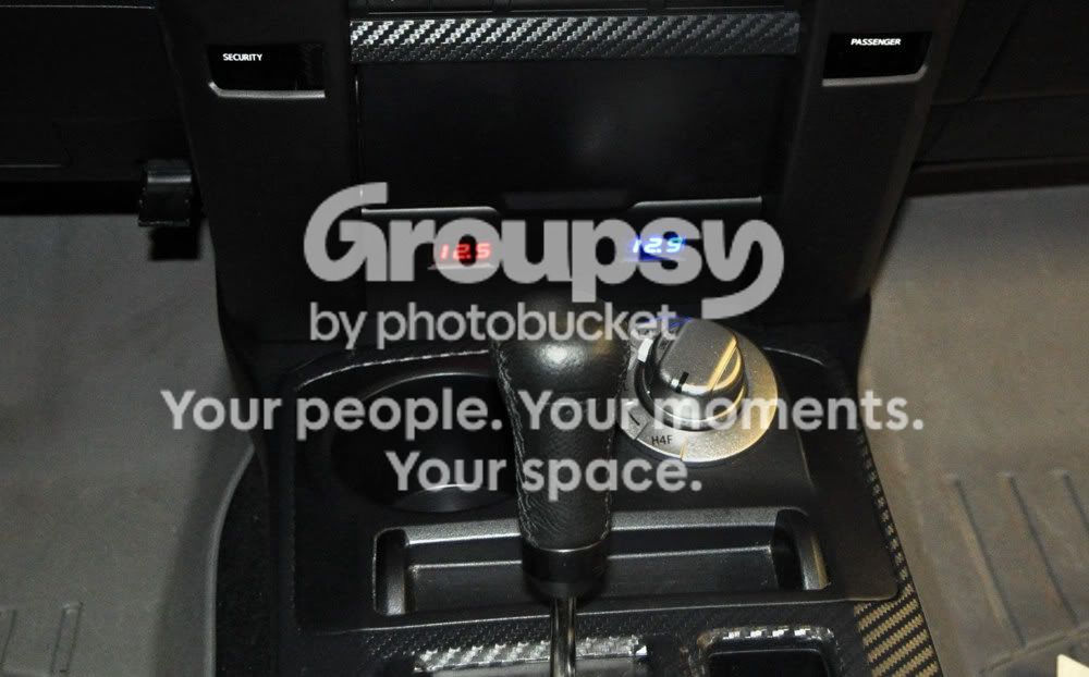

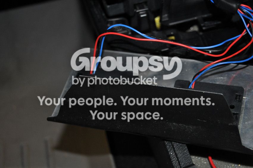

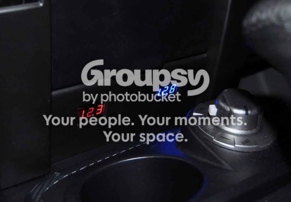

More Mods.......I had to run a bunch of wires thru to my center dash for my CB,Isolator switch and Isolator status light so I wired up a couple of Volt Gauges while I was at it. They are wired directly to each battery to better get their true readings.Used my Fluke meter to calibrate them.

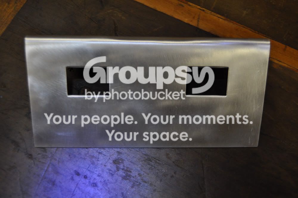

I fabbed a piece out of 2024-T3 aluminum that I cut holes in for the gauges and painted it satin black to match the other interior pieces. The volt meters are made by Stinger and I bought one in red LED and one in blue since I have one red battery and one blue battery so it makes it simple.They sit in place of that bottom storage hole that I never used anyways.
Here are some pics....

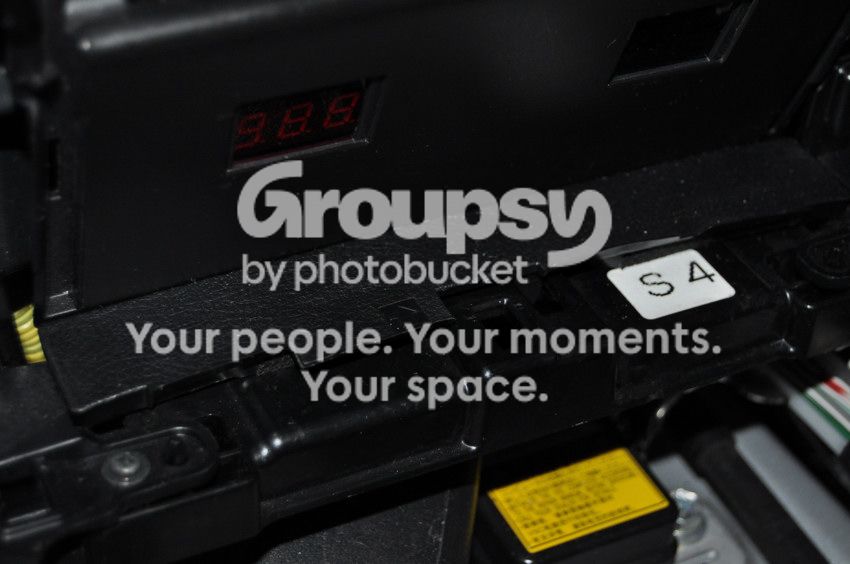

Test fitting....decided to make the holes bigger as it was hard to read when at an angle.

Holes cut..ready for paint

Installed and Wired

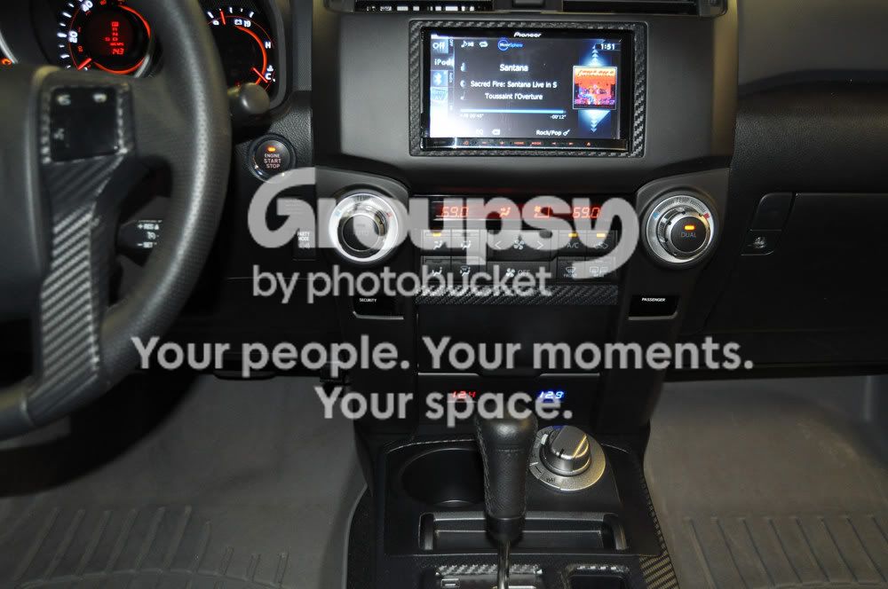

Full Center Dash shot
Picture022-4.jpg~original
I also wired my Cobra 75 WXST CB in my center console for now.
Can I ask how you attached the metal sheet to the bottom of that console? I'm trying to do something similar with ABS plastic, but I was toying around with the idea of replacing that entire middle unit with the flip down cover and all.
Does yours just sit in there?

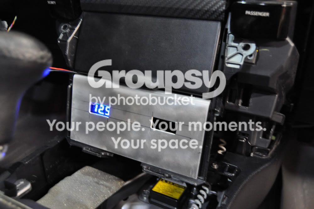

I cut it so it sits down in where the cubby hole was and is a tight fit. Then that 8-10" trim piece down below on the console holds it tight forward.
Here are a couple of more pics that shows it.

Black trim piece that holds it.
