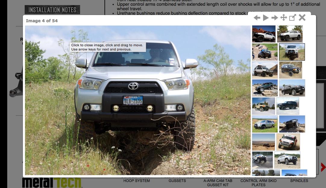

I am sure you are aware that you are featured on Total Chaos's website for upper control arms.

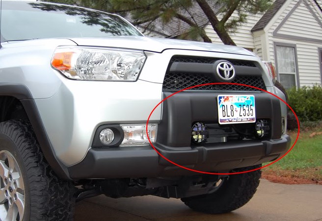

Just the flares were going to be painted silver.I originally thought the side flares from the Limited and Trail were the same with the exception being the Limiteds were painted body color.
Not the case. They are completely different in shape and texture.The Limited are smooth and the TE's are sort of pebbled or textured look.They don't mix.
I know it's been years, but I'm thinking of a trail front bumper swap. Do you think if I had the side flares from the trail bumper painted (black) to color-match my stock smooth SR5 flares it would look too weird? Alternatively, anybody know if they ever made smooth ones?
Also, I know you modified the mounting brackets to get the trail bumper on, but I haven't seen anyone post pics or an in-depth explanation of the mods needed. Any tips/details in that department?
<a href="http://s420.photobucket.com/albums/pp282/gharper60/?action=view&current=Picture073.jpg" target="_blank"><img src="http://i420.photobucket.com/albums/pp282/gharper60/Picture073.jpg" border="0" alt="Photobucket"></a>
Does anyone know if the SR5 lower grill would fit in that spot where the round fog lights are?
Also, do I really HAVE to change the fender liners? Can I get away with just the front bumper cover and the bumper-mounted flares painted to match my SR5?
