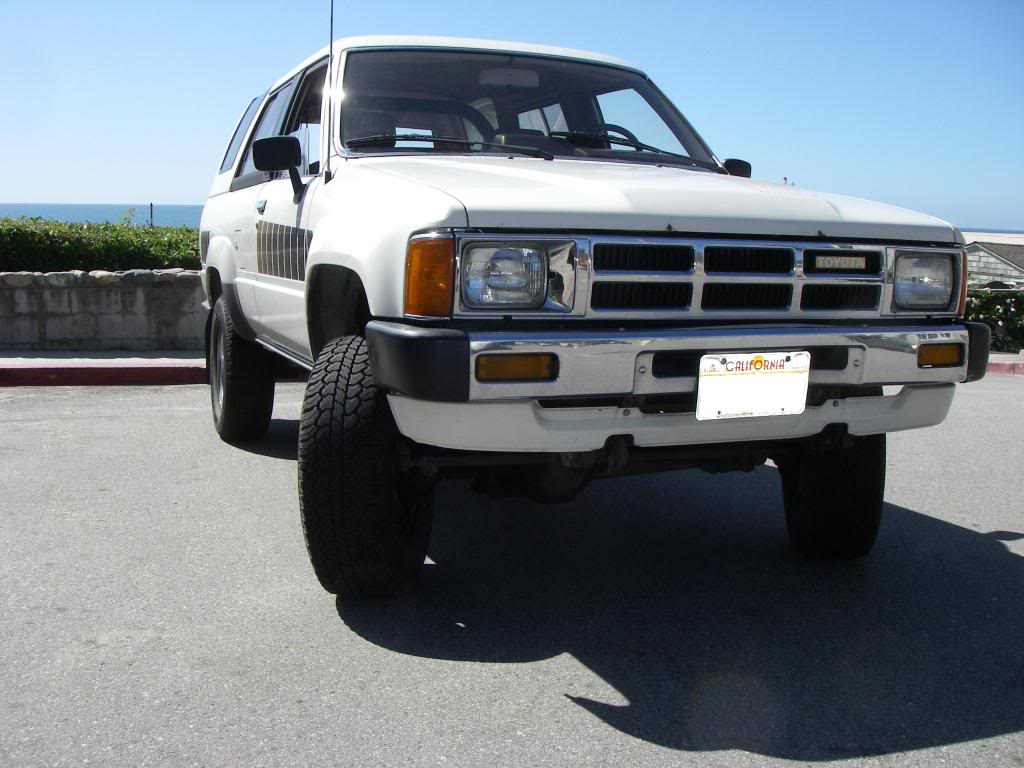

hey, T0YMINAT0R, here is your beasts baby. with baby training wheels
Yeah, that is pretty much what mine used to look like...but your seems a lot cleaner than when I first purchased mine!
