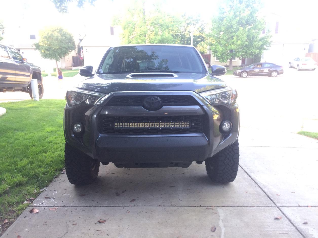

Just another light bar in grill
Thanks, but I didn't ask my question well.
What I was trying to ask is: did you put some kind of trim on the grill and surrounding the light?
I cannot really tell from your picture and I'm trying to come up with a good solution as I'm going to be doing this mod soon.
My first mod btw, just got the truck a few days ago.
I didn't do any trim, so the edges are open. I may down the road do some trim like sakers.

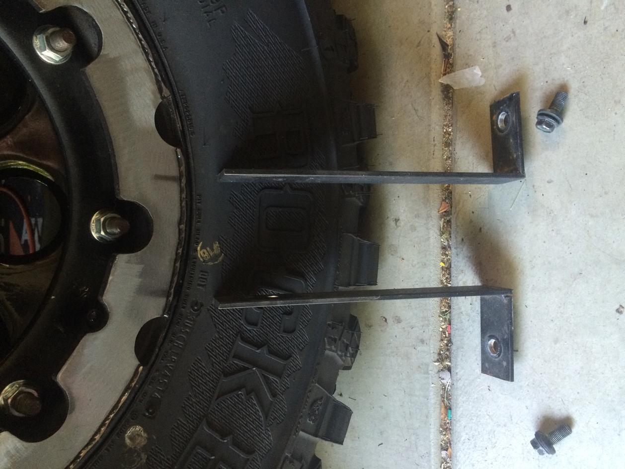

Easy mounts
Just to add some "how to mount" content....
As said before tons of info how to do this, but since this thread seemed to heat up, I'll toss this here:
Pretty easy to make two "L" brackets, hardest part is reading a ruler and getting the top bumper bolt out. I used my impact gun for the top bolt.
I'm running a dual Amber & White LED bar from Sierra LED, really cool dual diode LED where each LED is Amber and white with the flip of the switch:
https://www.sierraledlights.com/innovative-dual-amberwhite-led/
Not on this fourm much, spend most of my time over on ih8mud. I'm an 80 guy generally in the trails and the runner is my DD. Do I need to get my post count up to post more then one pic?
-Ammo

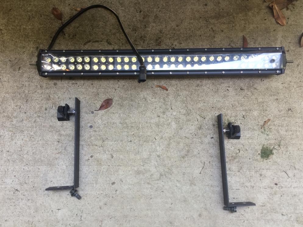

-Ammo
Another picture:
