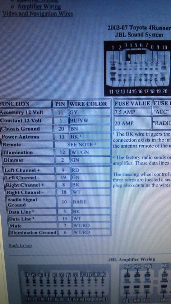

Okay, so here's where it gets difficult. I have the JBL system, which I wish I DID NOT!!! The JBL system requires an additional harness for the amp interface (TYTO-01). I connected the interface to the unit's wiring as best I could for testing purposes, removed the stock radio, and gave it a try. Here are my observations & issues.

FIFTH: The front buttons ARE NOT lighting up properly. I must assume that because of the JBL system & the interface... I must have a wire disconnected somewhere. The only wire on the Nav unit that appears to be for the button backlighting (titled Headlight test) isn't making it happen. Using the diagram below (attached) which I found from another thread on here, I tried all 3 Illumination/dimmer wires from the truck. If I connect the Illumination+ wire, it causes the truck's buttons to NOT light up, and doesn't light up the nav unit. The other 2 do nothing.

Any thoughts from anyone more versed in the JBL system?
