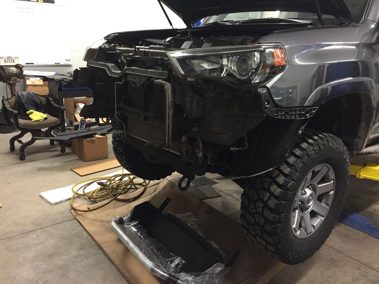

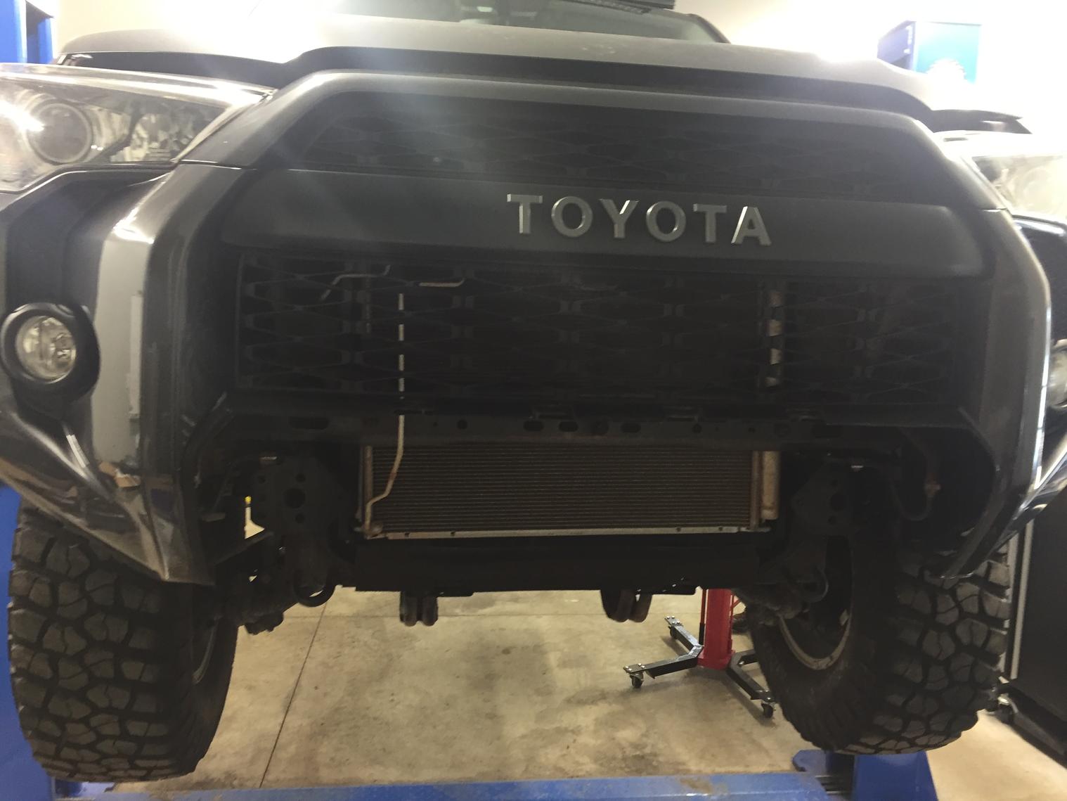

I am in the process of installing a warn Zeon 10 in my southern style bumper and there is a water line, or some sort of line, in the way. It will have to be moved. I just got online to figure out what it is and the best way to reroute it. It is going on a 2016 TRD! You did not have this problem with your install?
Got any more detail? Maybe a photo? I don't recall anything having to be relocated but sometimes the details of the installs don't hang.
There's a horizontal A/C line that interferes. I gently bent it and the brackets for it to push it further back. I did not bend it aggressively at all as I was paranoid about linking it, so my clearance still isn't ideal.
