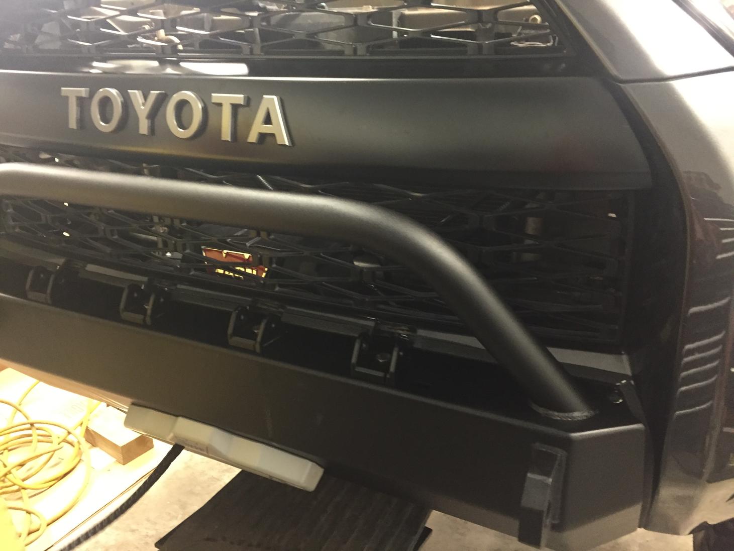

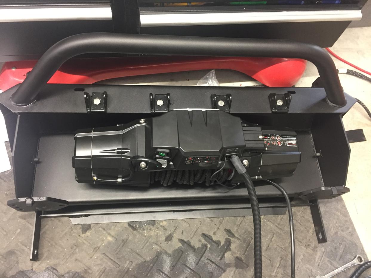

Hmmm, mine fit, same winch, same bumper.....and yes I cleaned the line routing on the winch once installed
Looks like you trimmed a bit more than normal below the grill. We are going to give it another whirl tomorrow, and if I can't get it to work, I have a relocation kit at a nearby store as backup. Thanks for the help and pics. I'll try and report back in. Happy trails!
