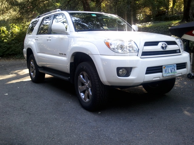

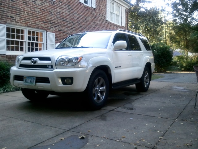

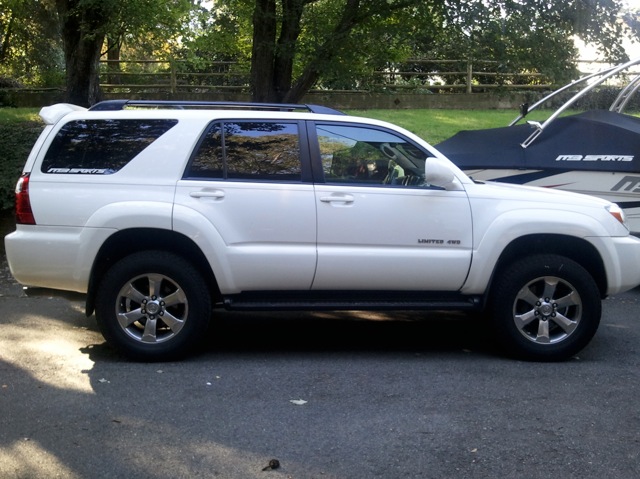

Here are the pictures. Loving the upgrade.
The first pictures are stock obviously.
Tires are new 265/65/R18 Goodyear Triple Treads.
