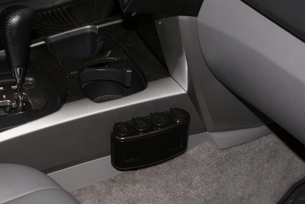

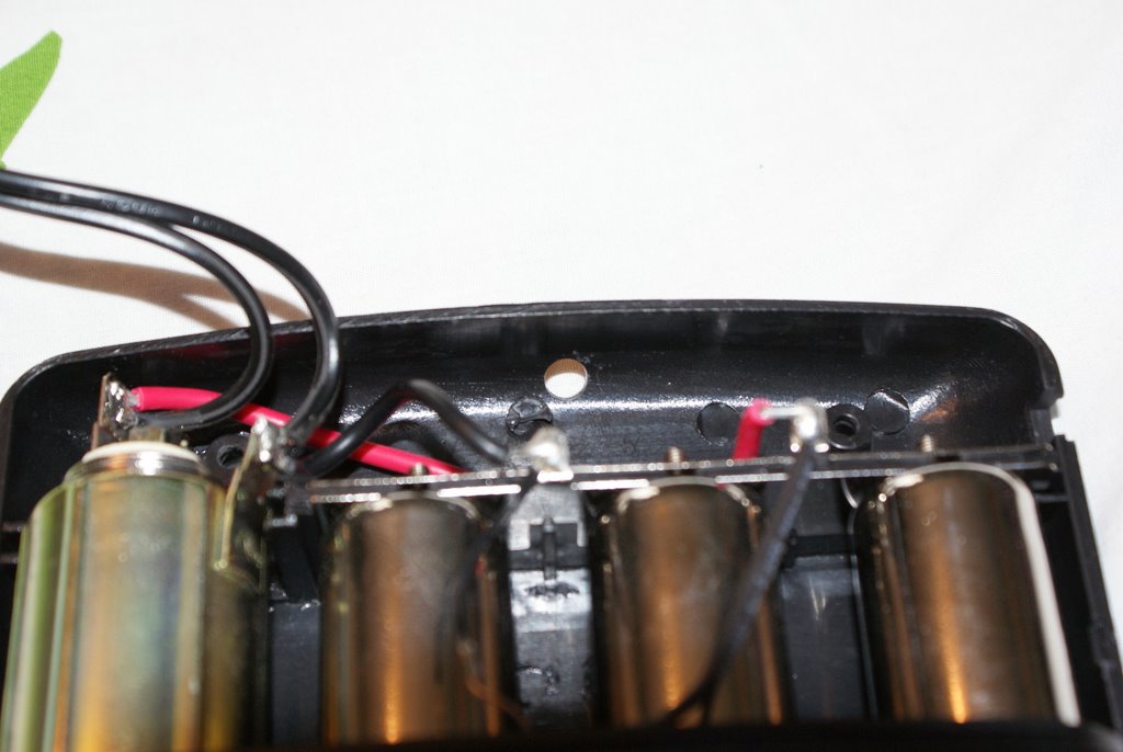

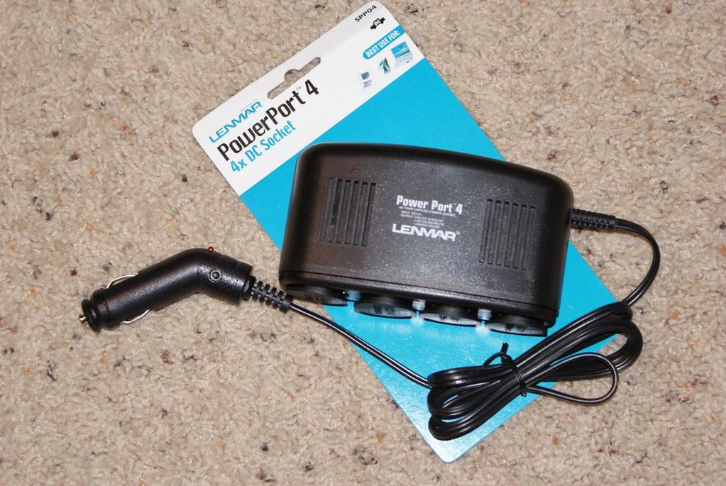

My solution.
Start with one of these.
Open up the case and drill a hole to reroute the power cord through the bottom rear of the case. Also snip off the plug since we're going to hardwire this to the cigarette lighter circuit in the console.
Paint the PowerPort to taste. I went with Rustoleum Hammered Black...works well with the "granite" trim, IMO.
Wire it to the extra cigarette lighter circuit and velcro it to the side of the console. Voila, an additional four power ports that don't draw a lot of extra attention to themselves when not in use.
-Brent
