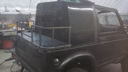

I have a 1990 samurai I put a 1.6 2 valve FI in it I use it for ice fishing it is amazing what it goes over when other vehicles sink I was going to put track on it but I didn't need to . great little truck I put a hard top and built behind the cab with 1in square and covered it with a alum skin. I am going to put a rear window this summer
You have a 8 or 16 valve? (the 8 valve is throttle body injection & the 16 is true fuel injection, better mpg, torque & HP) Exactly why you wouldnt want a heavy 3.0 or similar motor in your samurai. They can & will go anywhere because they are so small & light weight! (same for VW bugs)
1.6 8 valve 2 valve per cyl. yes the 16 valve has more peak hp but the 8 valve has more torque or feels like it has more torque and is a direct bolt in for the 1.3. quite a bit easier than a 16 valve 1.6
you still have to have the adaptor plate to mount it to the trans.... but the exhaust, intake/carb wiring, etc. is drop in.
1.6 8-valve
