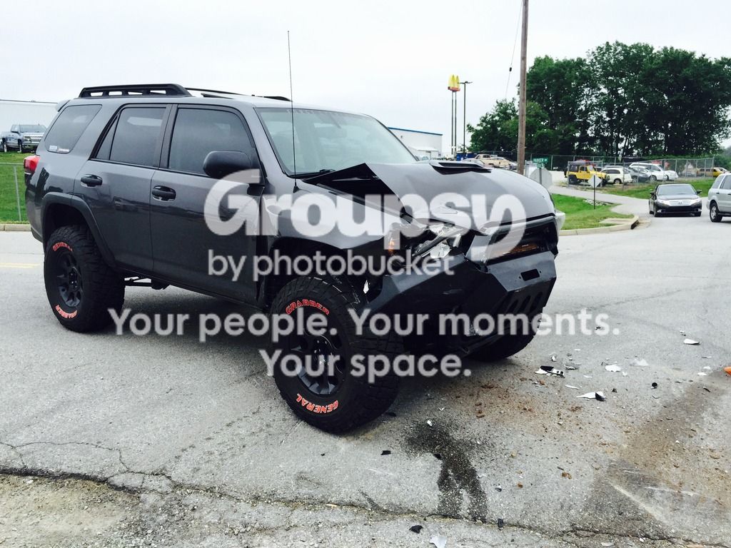

KDSS Damage

What happened to your vehicle? Did someone reek havoc on your car while I was away on vacation?

It looks sorta squish faced like the Tundras... Glad you're okay though. I think the SST is nothing more than a simple pressurizing/bleeding tool, so it might not be too hard to make your own.
so, Toyota of Oxmoor (local) says they can fix it. turns out their idea of fixing it is replacing the hose, topping of the fluid and calling it good.
everything that I've read says this is wrong, but they're insistent this is how it works because its not a 'magical' system
Lol I guess so right? It is a pressurized system so how does one go about simply adding fluid? Iirc there is no simple reservoir with a fill cap.
Regardless, still curious though keep us updated on this will ya?
i told them to have at it and fix it how they think it should be fixed. they're adamant they know what they're talking about. if its not right it will keep going to the shop till they replace the whole system. by then i should be in the position to remove it and sell it and go to anti rocks
