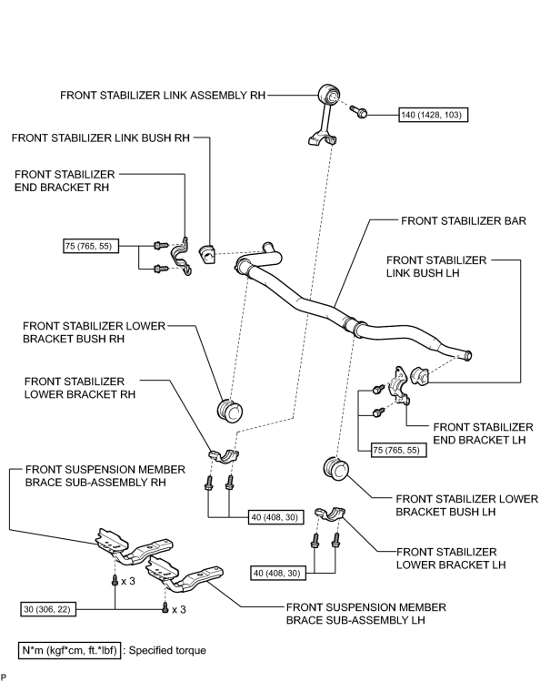

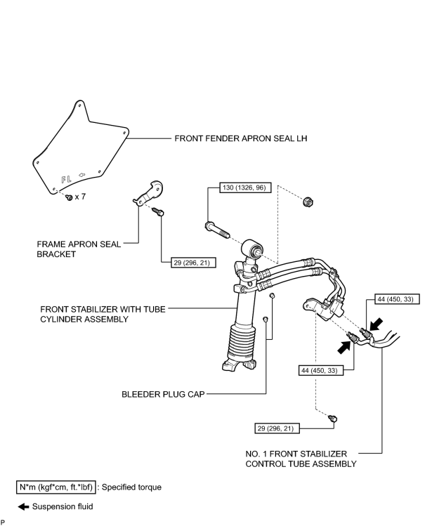

Hello, here is a link to both sides of the front wheels,
I have noticed on 1 side there is rubber under what seems to be the kdss sway bar.
And on the other side, there is nothing.
I just wanted to know if its normal, I noticed this today when I washed the truck. Thank you
Yes ,normal. Drivers side has the hydraulic actuator attached to the frame and the bar and the other side has a solid link attached to the frame and the bar. When the actuator pushes down it uses the solid link as a fulcrum to lift the opposite side and vise versa when it retracts.
On the back they work they same as the front with a link on one side and a actuator on the other side.
