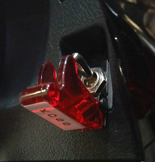

I guess I'm the next guinea pig here. When I bought my new-to-me 4Runner, I thought it didn't have KDSS (wasn't on the window sticker). After a few weeks at home I realized that KDSS was there and decided to live with it. My copilot loves dispersed camping and exploring yet hates a rough drive and that's made me consider KDSS along with other aspects in regard to creating a smoother more compliant off-road ride. Tires, psi, suspension all aside, I wanted to see if modding the KDSS system could improve the ride.
So far, after limited testing as a recent modification, I can say that yes, forcing KDSS into the 'open' mode improved the off-road ride. An example of improvement is when hitting a mild, unexpected rut, it's no longer a PTSD inducing experience. Forcing KDSS into the open mode on-road absolutely makes the ride worse when cornering with more body-roll. While I mention it's improved off-road driveability for me personally, it's not a cure-all. Tires, PSI and suspension come way way before. The subjective improvement may not be worth all the potential costs.
I'd discourage anyone from permanently setting KDSS to open unless you know what you're getting into as that body roll sucks on-road. If you modify the system and your modification fails while driving aggressively, well you can guess there. Then there's unexpected early wear or failure as the system is not operating as intended. If you botch a modification and cause an electrical issue, who knows how much that would cost to recover from. Finally if you have to ask for directions how make this kind of modification then you probably shouldn't be a pioneer here. Disclaimers aside I'll be testing over the next camping season. If something fails prematurely then I'll definitely report back.
And wouldn't leaving KDSS open on the road be like having, essentially, no sway bar?

Awesome!
Do you mind sharing if you spliced into the factory wiring or did you make a custom plug-in harness? If the latter, do you mind sharing PNs of the connectors to purchase?
