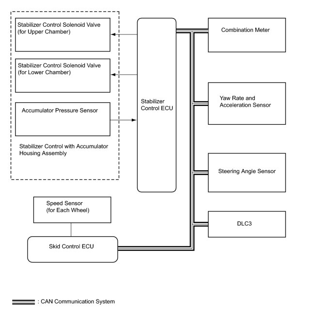

You are thinking of the XREAS portion, the KDSS does have electrical valves.

It's absolutely controlled by electronics. BTW, I'm not talking about crawl control. I'm talking about crawling as a general term (moving slow in 4LO).

It's absolutely electronically controlled. This is straight out of the 2010 4runner repair manual.... We all obviously know what craw control is... Back on topic I was talking about the behavior of the system in crawl conditions.

Looking at the manual you could derive by looking at what the ECU is reading what it is doing.
It accepts Yaw/Acceleration/steering angle/wheel spin. I would think that if you don't have multi-terrain select enabled it would be doing what it always does as it you were driving on the street.

I don't think MTS has anything to do with it. MTS is just tuning the ATRAC/traction control. Look at the diagram posted earlier in post #4. That makes perfect sense to me. It runs open at low speeds allowing the sway bars to go completely loose...

I know the system in the GX470 was stand alone, where the system in the 5th gen t4r and GX460 has electronics and input from the VSC module, I am guessing the 200 series is the same, but haven't looked into it.
