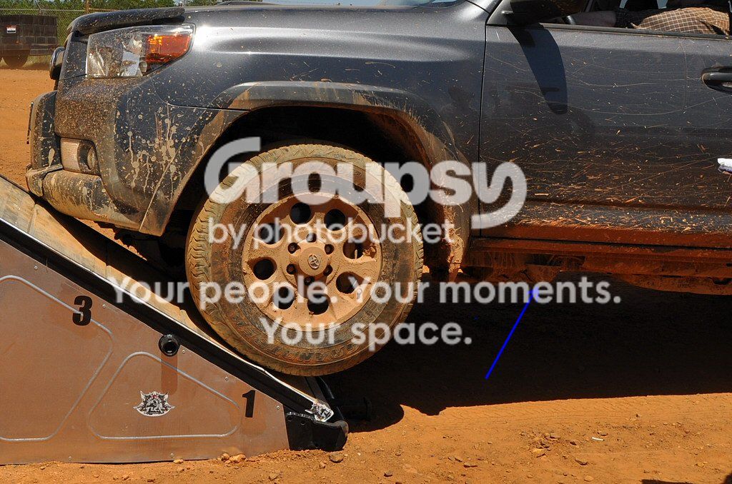

KDSS allows for the anti-roll/sway bars to be effectively disconnected off-road. Does that increase overall suspension travel? Nope. You're right. BUT, that does NOT mean that it does not help.
See the picture in the prior page in my post. Taking out the sway bar up front increases compression 3 inches. Droop likely increased too. Both front and rear suspension effectiveness increase significantly. How significant? Well, that all depends on what your expectations are. For me, a 3" increase compression is pretty significant. Now, if you were expecting long-arms travel, then yeah, you would be disappointed...but that also shows your lack of understanding of the 4runner suspension!
RTI scores reflect the more flexy suspension with KDSS. RTI score of 100 difference is significant, esp. when tested by FourWheeler under the same conditions and using the same ramp, tools, etc..
