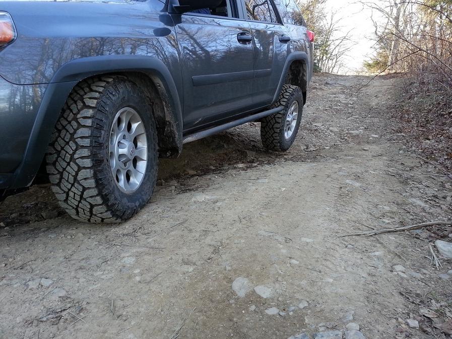

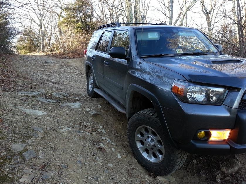

Sooo...in hopes of keeping this more relevant to what the majority of people here will be doing with their 4runners, let me try to engage you in a discussion of a more realistic example of what I think most of us would encounter off-pavement.
First and foremost, I am a complete newbie when it comes to all things off-road, and the below example is literally the first time I've ever hit a forest trail in a 4x4 vehicle.
As you can see below, on a not so wild fire road, I've managed to complete flex my 100% stock KDSS suspension to what I think appears to be just about its limits. Please note my driver's rear wheel is actually off the ground by a wee bit. Granted, maybe I didn't pick the proper line, approached this at the proper angle or whatever, but that's not the point here.
My question to you is...in this situation, how has KDSS helped me anymore than an SR5/LE if I'm still lifting one of my rear tires? Are you going to tell me well...KDSS helped me to have my tire only lift off the ground by a mere 1-2" instead of more?
Maybe I just don't understand the physics or techniques...but to me, it doesn't matter if the tire is in the air by an inch or a foot, a tire in the air is just that, a tire in the air; and well that tire in the air is certainly one tire that I can't count on helping me to drive forward right?
This is why even an amateur like me doesn't whole heartily buy into all the mythical off-road benefits that you so persistently claim is there. I don't doubt you that there's some benefits, but I also don't agree that it's as hyped up as you make it seem. Yes, I know, I know every little bit counts, I think we all get that by now.
Now if you ask me, I'd probably benefit a lot more from some longer travel more than easier articulation...I mean yeah you can articulate easily, but what about once you reached the end of the articulation limit :doh:

The reason why I posted the latest RTI ramp was because harper7 ASKED if there was a picture of a stuffed front end to compare to his RTI pic of a TE. READ HIS post again and see why I posted that. I hope that you understand instead of blatantly question me.
The rest of your question is a good one. You're right...once a tire is lifted, it is lifted. Where KDSS comes in is that it also provides more compression and droop at all 4 corners. See your front tire? It is compressed. An SR5 driver's front tire likely will not compress as much. Of course, in your situation, KDSS or not, you're gonna lift a tire. See video posted earlier comparing the suspension systems. The idea here is that KDSS provides more stability as you slowly creep/crawl over this uneven cross-axled situation. With a normal non-KDSS suspension, since you have less compression and droop, your car would head-toss more...aka more weight shifting side to side, front to rear. KDSS does NOT prevent your wheel from lifting all the time. That's nonsense to think that.
KDSS provides more effective travel off-road...is it a lot? Significant that you remain in contact with the dirt more than without it. Significant that you have less head-toss than without it.
