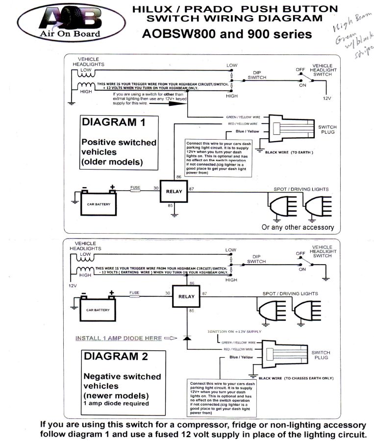

Here's something to consider.
You may need a 1 Amp diode in the 12v line going to the relay as suggested by AOB. See the second AOB diagram. A diode is safe insurance in any circuit given that the diode has a high enough rating. Use 1A as suggested.
I just installed my AOB switches and plan on diodes in each switch going to the relays even though only 1 switch will be triggered by the high beam like the second picture.
Agree or not @BajaDesigns ???

Hello,
I am using the harness Baja designs recommended and linked to earlier in this thread it comes with relay specifically for the squadron I want to wires this to Toyota push switch. The switch wires are
Black red1 red2 green
The harness has a rocker switch with only two wires red and black.
Any other harness I used after you snip their rocker switch are blue black and white and I wired the Toyota switch
Black-black
Blue-both red wires
White-green
