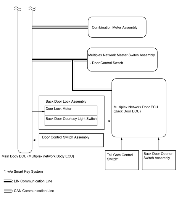

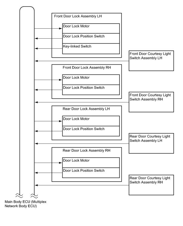

Edit: Just looked in the repair manual ,It's part of the LIN communication system and you would need Techstream to troubleshoot it.
So, off to the dealer then, right?
If battery disconnect was no help.Sometimes that will reset the computer and fix a glitch.Try you other key fob maybe to rule out simple things?
You can look in the manual ...Interior/Front door lock.... but trouble shooting is with techstream which the dealer has.

Great info Gary, I will try the other fob and disconnect the battery this weekend and see if that makes the fix.
I would guess the door switch is going bad or needs to be cleaned. Sounds like the BCM is seeing the door still open when it is closed.
Turns out it was a bad drivers door power door lock actuator, 30 minute job. $280 at Advance Auto but remanufactured versions are available on ebay for $125.
