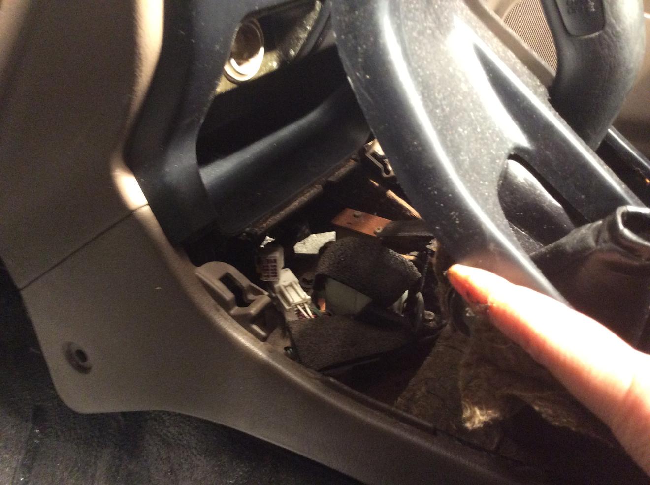

pull the shifter boot console and under there you will find a white plug with several wires(6, maybe 8) running over to the shifter assembly area unplug that connector and see if the key will come out. its the shift lock safety switch you are unplugging
-note in doing so you will now be able to move your gear selector through all gates without your foot on the break or the key in the ignition, but you will also be able to get your key out of the ignition. also you will be able to shut your truck off and pull the key without being in park.

Well, that did it. Pulled that plug (located just forward of the shift lever) and the key pulled straight out. Who knows what it was, but i took a photo in case someone else needs a reference point.

I unhooked the same white plug as in the earlier photo. I could finally get my key out of the ignition! Although, I had to charge my battery first!
2000 4R Limited: I had this problem and found this old thread; disconnected the clip as instructed and it worked! However, now my shift lever is very hard to work and doesn't always want to come out of park. Could this a consequence of disconnecting the clip or is it an unrelated issue? Thanks...
