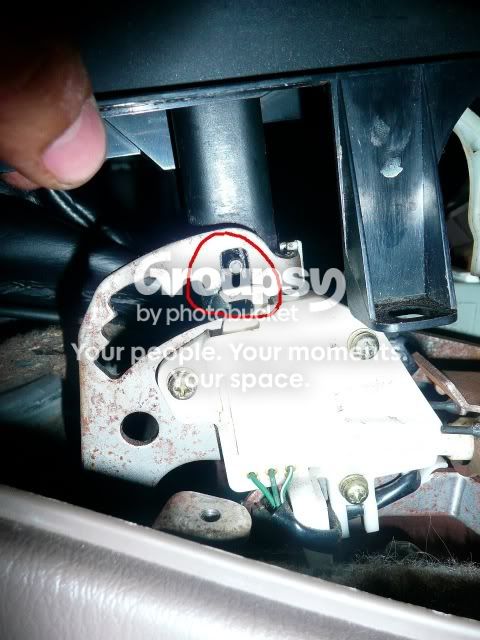

Having had enough of my key getting stuck in the ignition this past week, I opened up my shifter cover and took a look at what was causing the problem. It seems that the shifter wasnt "catching" the key lock switch properly when in Park.

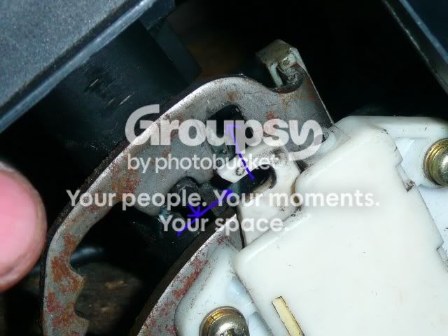

Here it is in Reverse. The little black metal stud from the shifter lever should engage the white C-shaped plastic catch on the shift. With the switch down, the car thinks the shifter is not in park and will prevent release.
shiftlockR.jpg~original

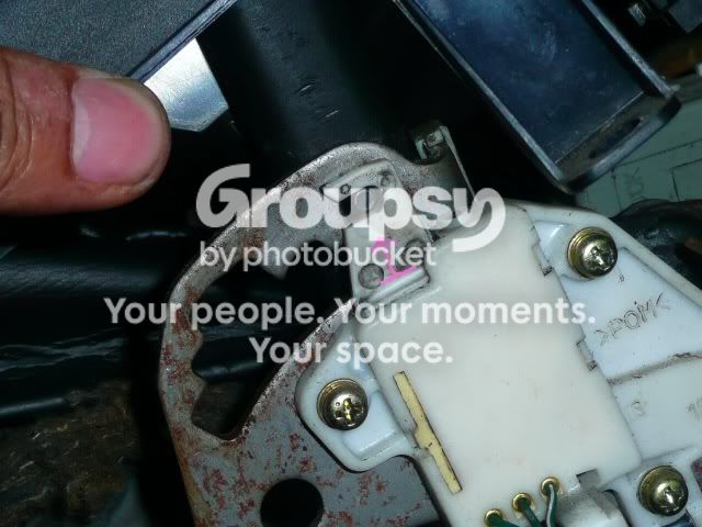

Here it is properly engaged in Park. Switch up- key releases.
shiftlockPok.jpg~original
Over time, the parts have developed looseness or wobble. My shifter cover was also missing one bolt out of three total. This allowed the shifter lever too much sideways movement, which eventually led to the stud not catching on the switch.
shiftlockmiss.jpg~original

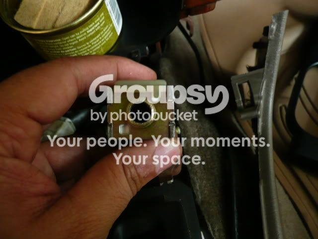

While at it, and although I had no real problems shifting, I also took out and checked the shift interlock switch. Seemed ok to me.
P1040429.jpg~original
