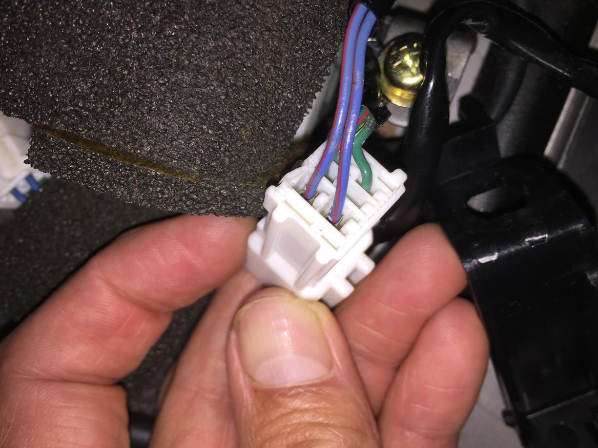

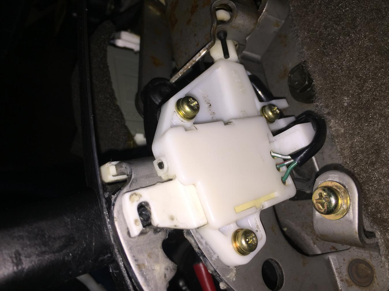

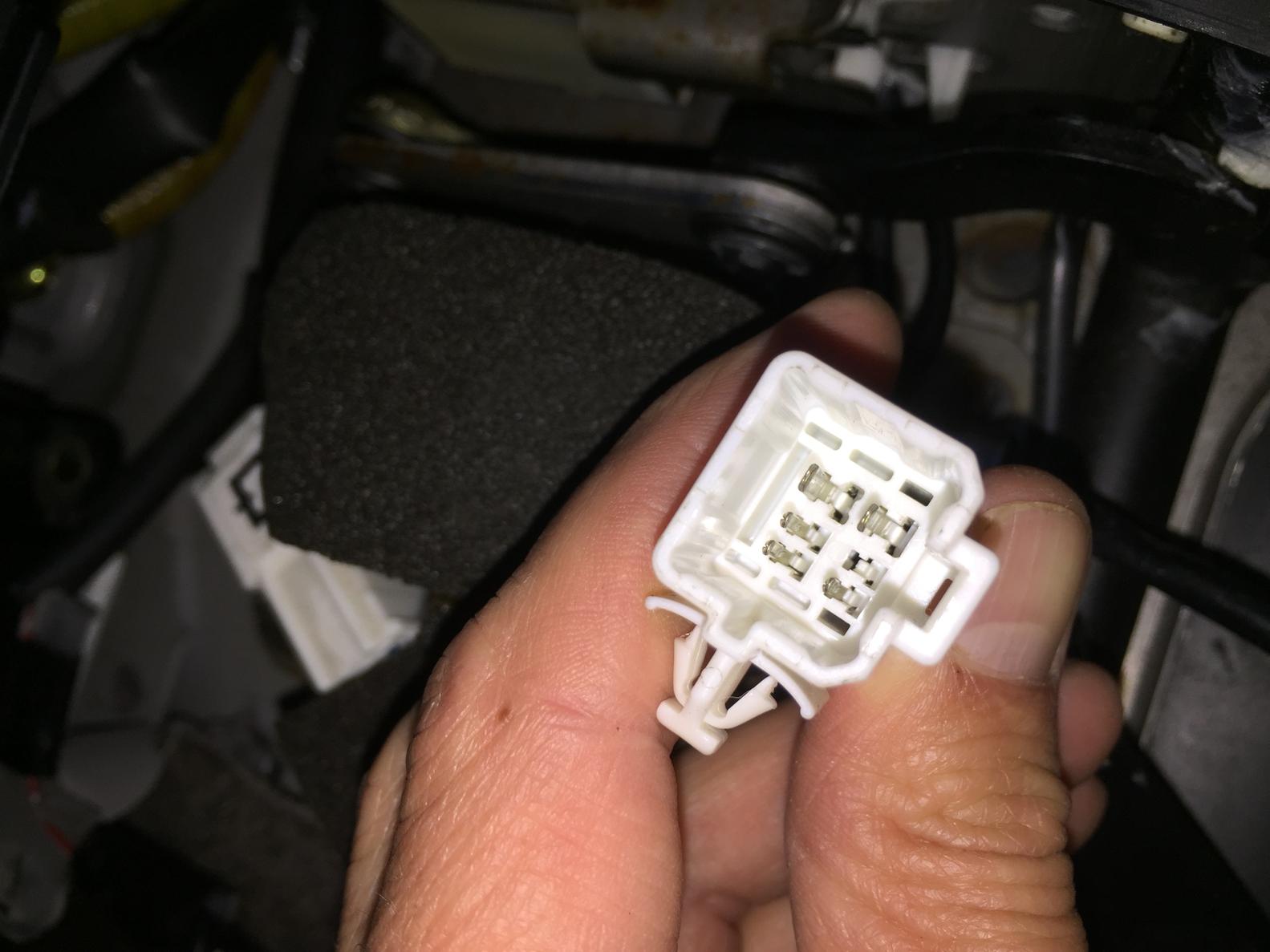

Hi guys. I have all the parts I need and was in the process of replacing the shift interlock switch. My problem should be simple. There are 2 wires that are connected to the old connector that must be removed and reinserted into the new connector. They are the blue/red wires. Normally you would use some type of extraction tool to bypass the locking tab to slide the wires out the back. I have tried and have had no luck. Is there a specific extraction tool for this connector? I can't find any help on this. Thanks. See the pictures for greater clarification.:shrug: I'd like to get this done, please help.
There's normally a secondary lock to lock the tabs down. Sometimes a pull out piece, sometimes a slide-out piece. Post up 360 degree pics or confirm you got the secondary locking mechanism removed.
Then I'd just use a large safety pin, the sharp end. Push the electrical pin INWARD and then lift the locking tab, then pull the electrical out. Should just slide right out once you get it unlatched.
