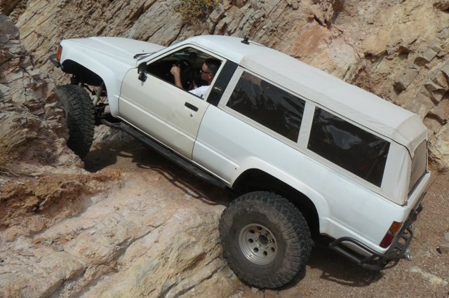

I have one of the original tops from Shawn. (I happy to also now call him a friend) When I bought mine from him it was still an "in progress". He has help me over the years to improve the top. the back window "snap rail" was junk, we just added a 1" flat alum bar and some "L" brackets to the factory screws to the top of the gate with Velcro. I drive this on the freeway at 65+ with no side or back. The top flapped badly! Shawn designed a new top for me with side hold-downs and straps. Worked good. But I still didn't like the minor flapping of the edges of the top so I use the remaining 1" flat stock put some Velcro on it and just connect it to the edge of the top and no more flapping. (works good for me) :) I also don't ever use the glass back window. ever. just the back that Shawn built. I also have the divider. works good also. I have had to re-glue the edge of the Velcro on the side of the cab. no biggie..
The only issue I have is the top must be cleaned approx. every 6 months and I STRONGLY SUGGEST USING 303 PROTECTANT TO SEAL THE TOP FROM THE RAIN. I have been in contact with the new owners just after they purchased the company, and sent them a diagram of what I think needed to be added to avoid the "raining in the truck".. The spacing of the straps and bars let the rain puddle on the top, allowing water to seep into the back. Using the 303 I was able to stop most of the issue, but when it is going to rain. I just add some supports to keep the top from drooping down and allowing a puddle to form.
I abuse my top and the Sunbrella material is good shit. I've even dragged limbs and branches across the side windows and not one puncture! (Thankfully)!! :)
My Runner is the white one on the web site.
