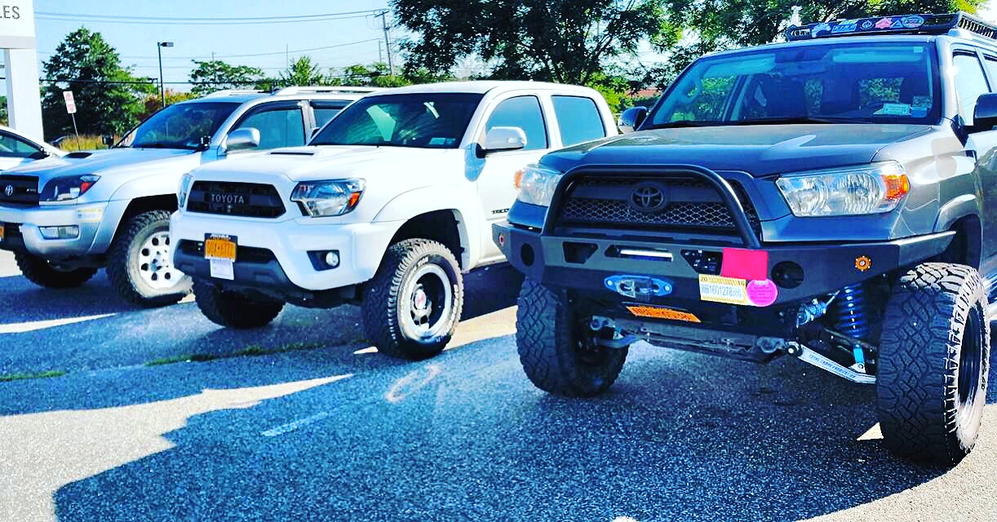

I think mine are slightly different but I have a 600 lb spring on mine. Definitely wanting to go to a 700 lb. I've adjusted mine and I don't know if it's just that I'm so used to the truck that it looks low, or if it really does keep sagging on me lol.
