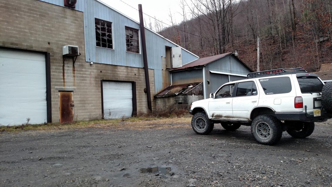

Interesting thing is I got more lift up front than I was even looking for. I didn’t touch the settings out of the box, and I assume SRQ didn’t either.
Here’s the stance now, looks like some reverse rake. I have OME 906 + 5100 on the back and carry about 100lbs+ everywhere I go. Looks like I’m at at least 2” in the front
Here’s how it looked prior
I think I will give them a week and see if the front drops any. Otherwise looks like some new rear springs are in the cards - maybe some LC 7 wraps....or I could just take the easy way out and drop the fronts a bit
