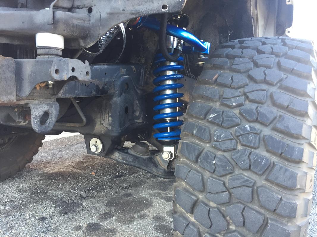

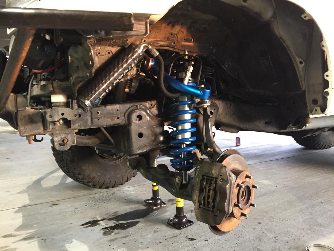

IMG_5839.jpg I believe I'm the first to run these (or at least to my knowledge) Bilstein 8125 remote Resi. The most accurate thing I can say is Holy Sh**! IMG_5949.jpg
