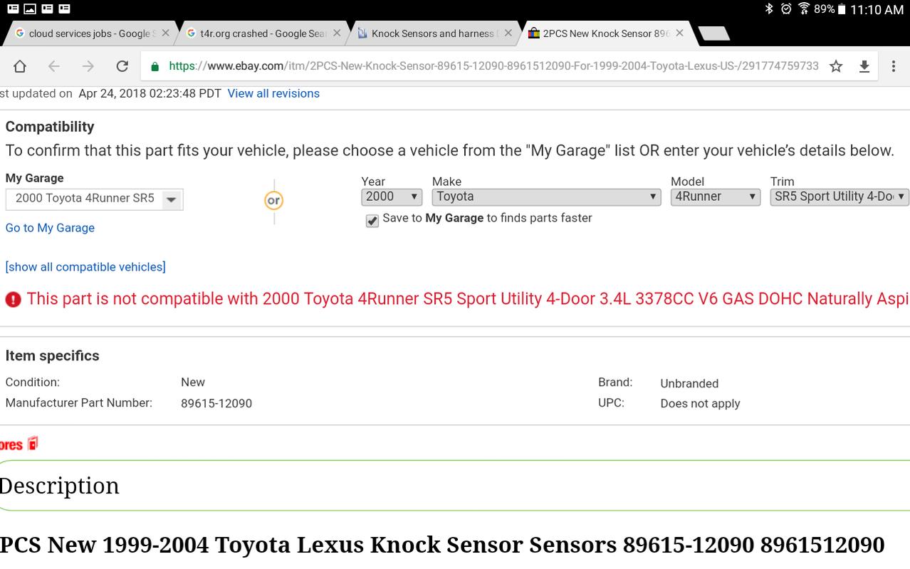

It's the same part number as what's listed on Toyota's website. It's possible that the seller didn't take the time to line up every vehicle's compatibility.
toyota pn is different
Toyota 89615-12040 SENSOR, knock
Toyota 89615-12050 SENSOR, knock I think this the one on ebay
I think you are right they are fake.
Toyota Part No.: 89615-12050
SENSOR, KNOCK CONTROL
Toyota 89615-12050 SENSOR, KNOCK CONTROL
Replaced By 89615-12090
A little late to the party. Haven't been on here much. These are compatible with our 3rd Gens. They damn sure look like the genuine sensor...but the price tells me different.
