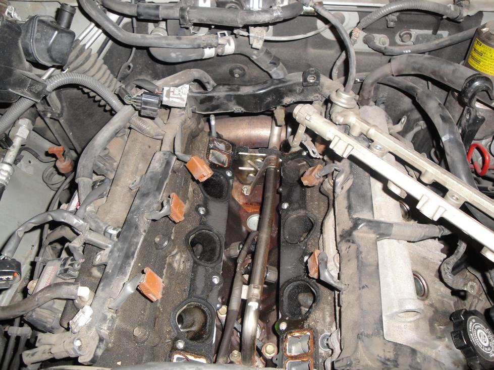

Having knock sensor issues so my second time in I took some pics to try and make a DIY for replacing these components. I may have missed a detail here or there but hopefully this can help someone see what's involved in this job. I took a picture of almost every step. I wrote as a step by step in order procedure.

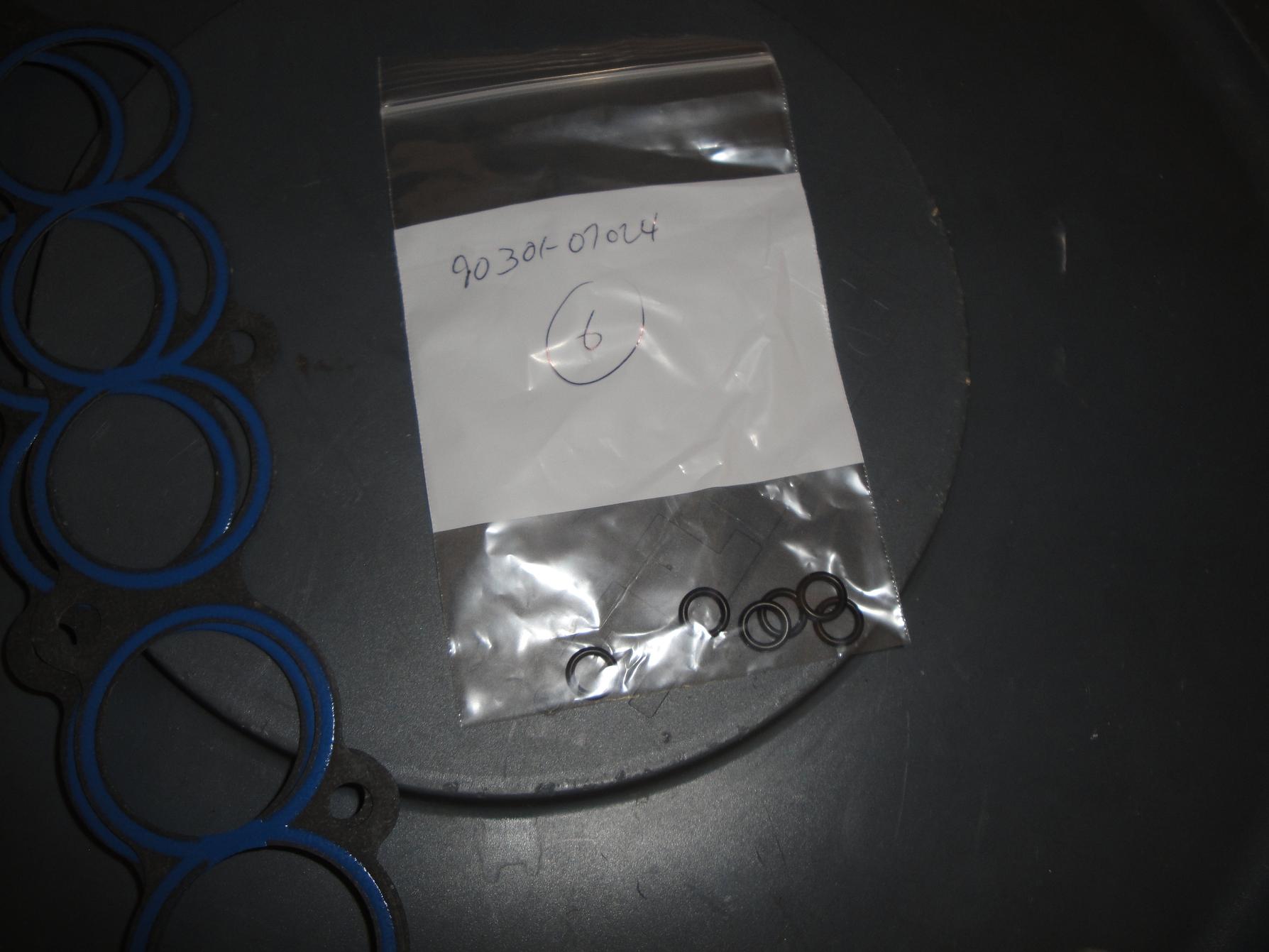

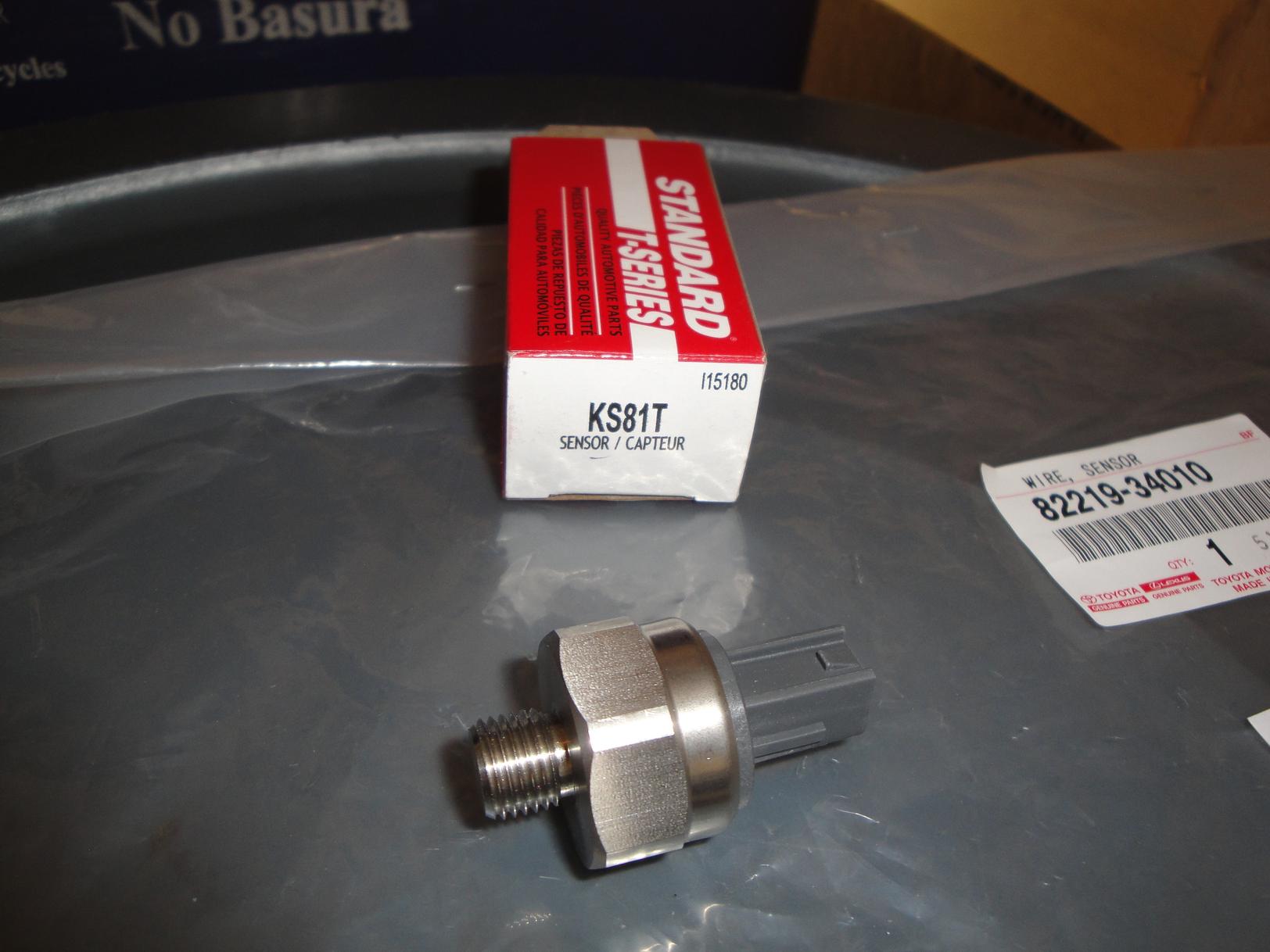

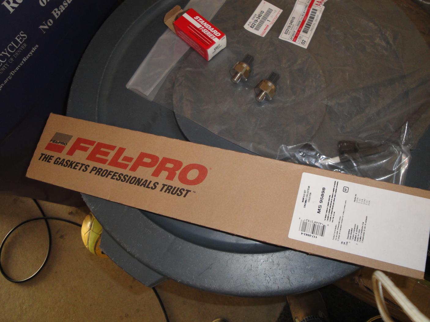

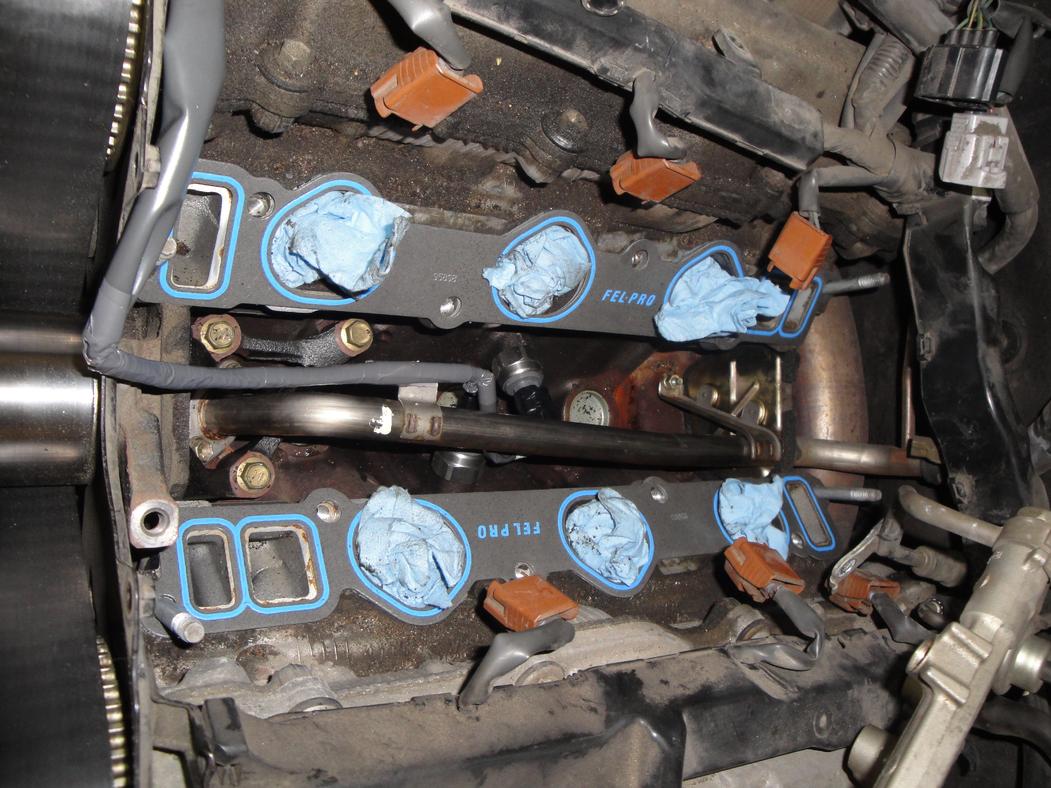

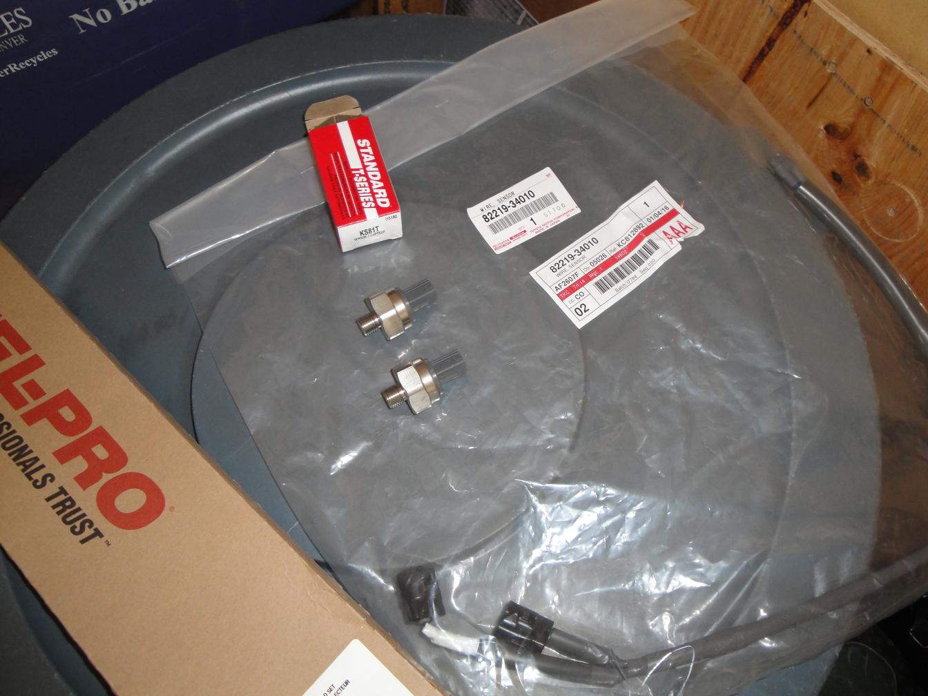

Few more relevant pics...last one is injector o-rings (OEM Toyota)

OEM ONLY on the sensors and the sub harness assembly.

I replaced both with Matsushita and now both knock sensors need replace again
Did you end up changing out the Matsushita for Denso the second time? The last we talked the code came back on. Also, did you replace the sub-harness? The wires on that harness become very brittle due to the heat and are usually the culprit in most KS issues. I hope all the info I gave you was helpful. You did a good job on this write up. I'm glad you took the time to document and share. If you can, take a photo of the Matsushita sensors and compare them to the Denso's like I did a while back with the NAPA brand. Here's the old photo...
Now I know I been searching and looking why my sensors didn't work, when they both new by Matsushita. , so I spent 400 bucks and now spend 400 more to replaced them with Densos , I even replace the harness, just to play it safe, why do they sell this if there not even working. I will try again when I get my taxes.
