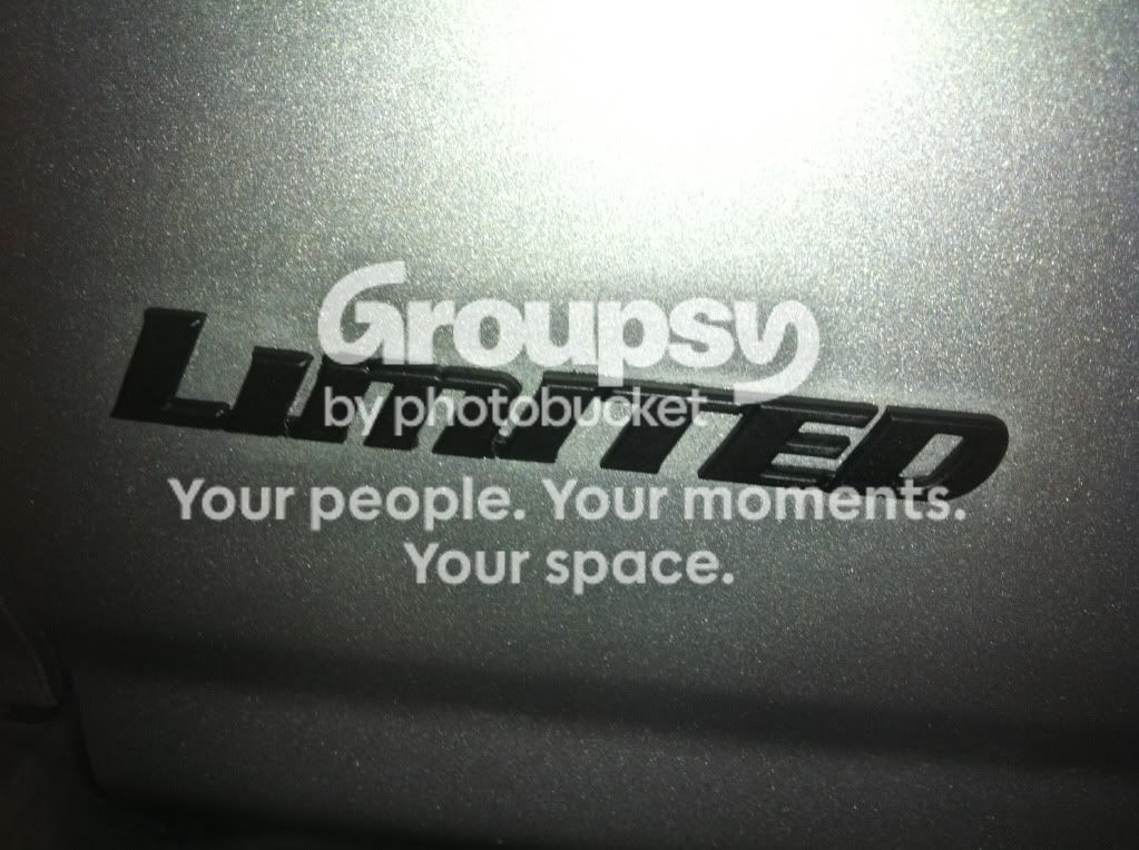

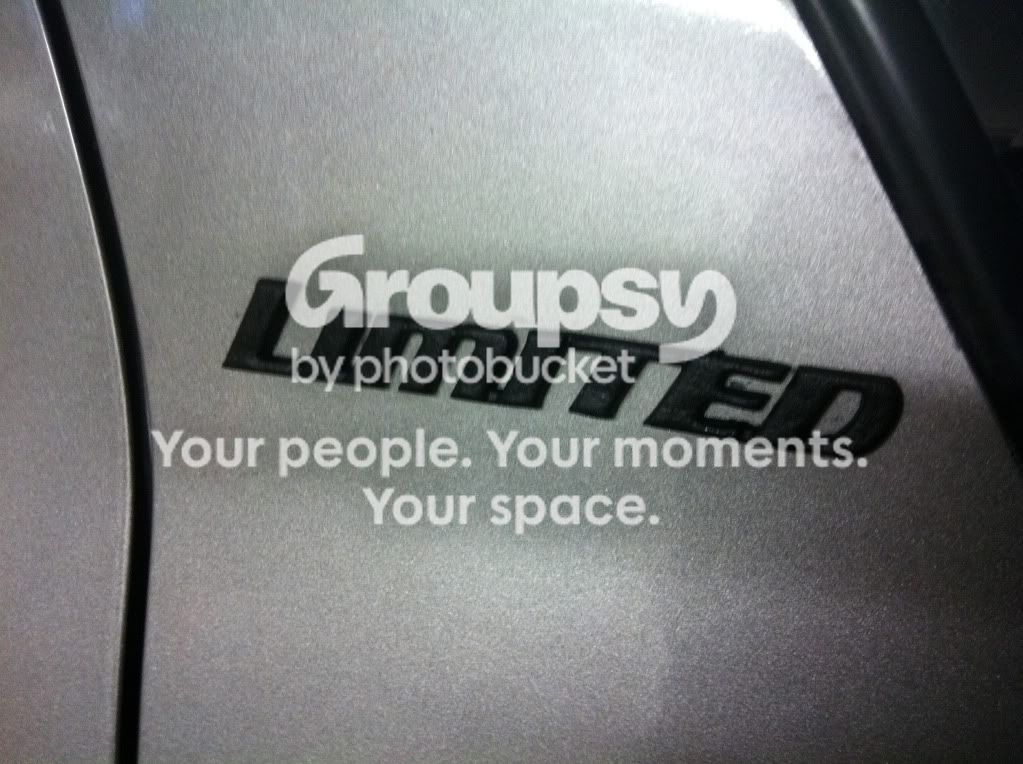

Here is a short update: A few weekends ago I bought the supplies for the deckplate mod and plasti dipping logos. I only have so far got around to plasti dipping so far but deckplate will come soon! As for the leaks, I took in my car to get the sunroof looked at do to it not working. Turns out the leaking was whoever worked on the car last had taken the rain catcher tray out and all of the water was going straight to the roof carpet. So $500 later and now I have a fully working sunroof and a leak proof car. This also appears to solve what was causing all the water build up in the rear too. Some pics -

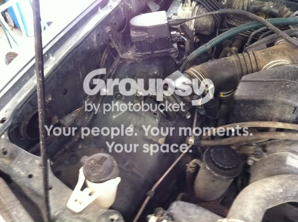

Ok now remove the EFI fuse located in, well your fuse box., now that I look some places I may not have needed to remove it but oh well.

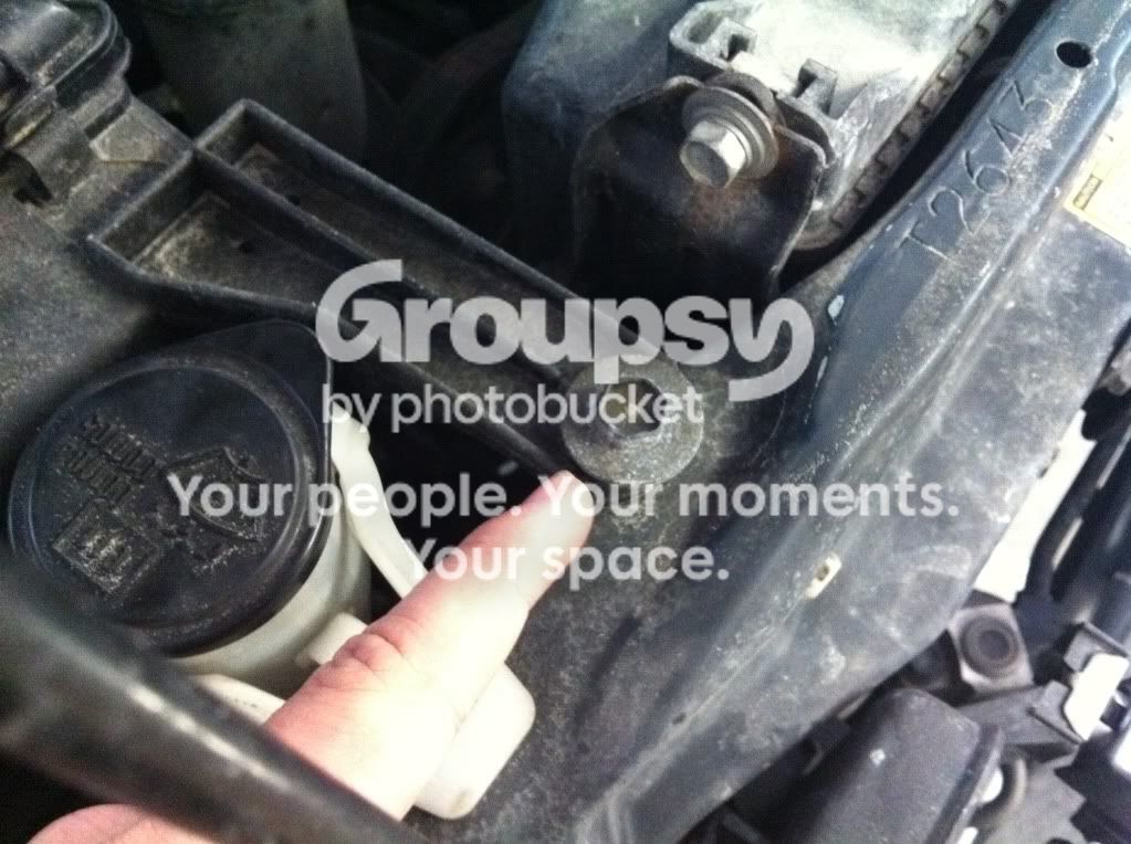

Now un-screw the three main bolts holding the airbox in-
IMG_0244-1.jpg~original
Behind the headlight
IMG_0245-1.jpg~original
And behind the airbox
IMG_0246-1.jpg~original

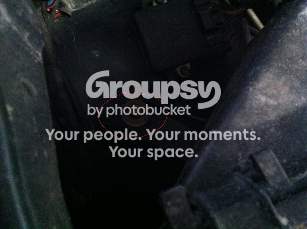

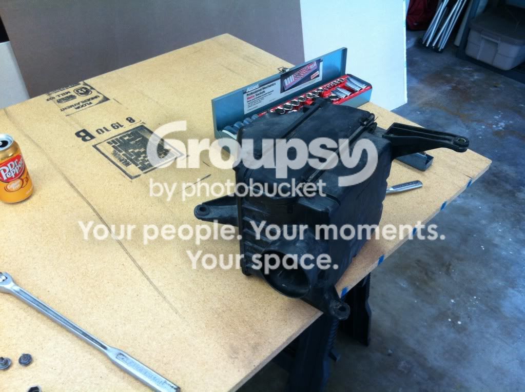

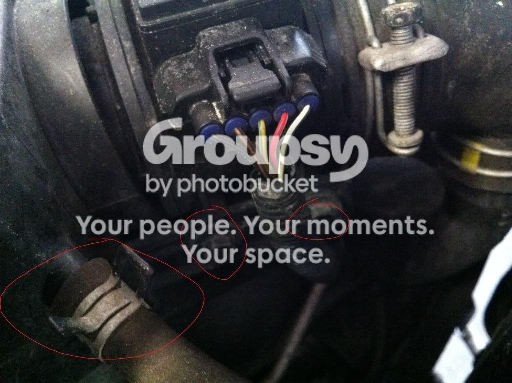

Now remove the two bolts holding the mass airflow sensor in and pinch the little hose clamp to remove it.
IMG_0247-1.jpg~original

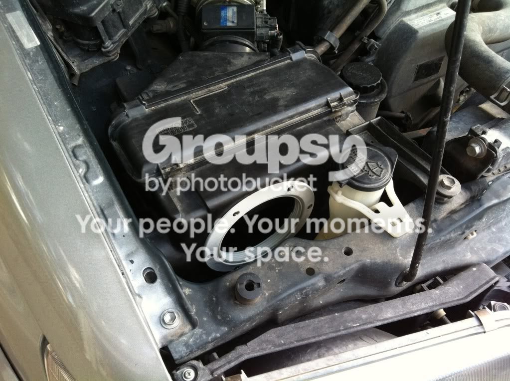

Then lift the airbox out.
IMG_0252-1.jpg~original
IMG_0253-1.jpg~original

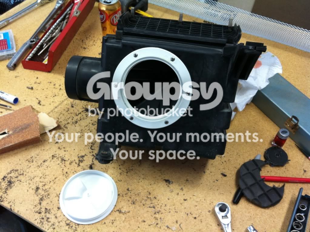

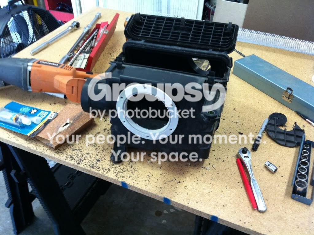

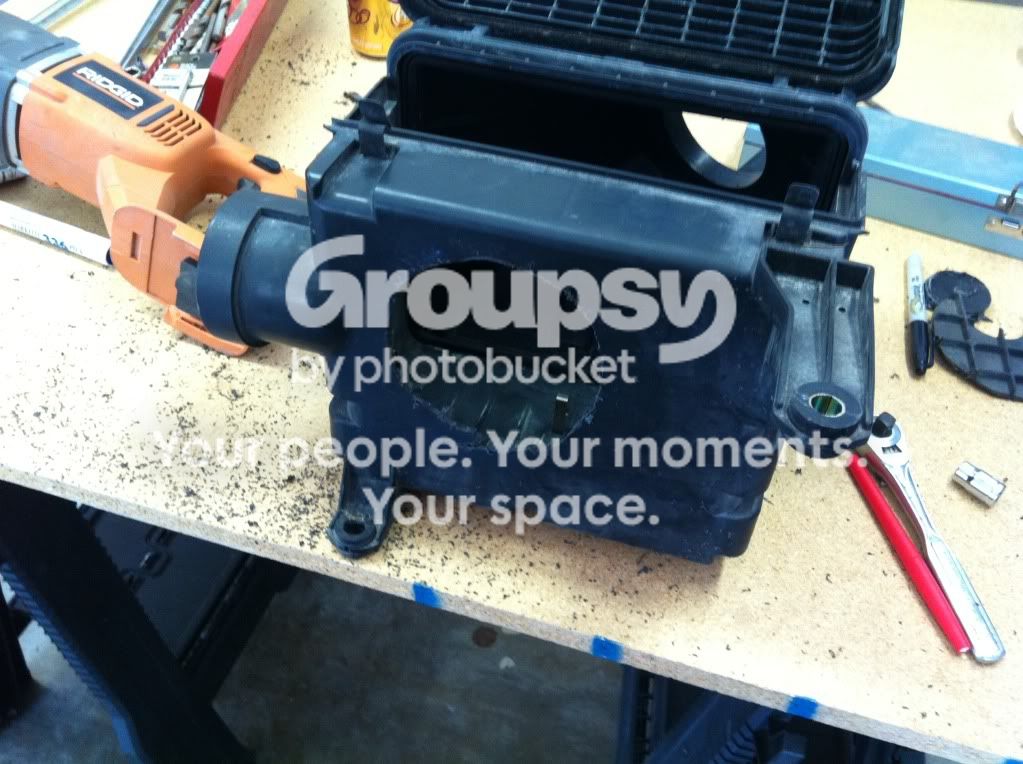

I traced the inner hole of the deckplate and cut it out, gradually trimming to make it fit. I didn't have all of my tools available so I "winged it".
IMG_0258-1.jpg~original
Put that marine adhesive around the deckplate and seat it in place.
IMG_0259-1.jpg~original
Now screw your screws in
IMG_0261.jpg~original
Now replace the airbox in the vehicle in reverse order and replace the EFI fuse.
IMG_0270-1.jpg~original
Congrats! that was the deckplate mod!
IMG_0269.jpg~original

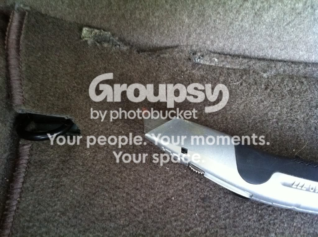

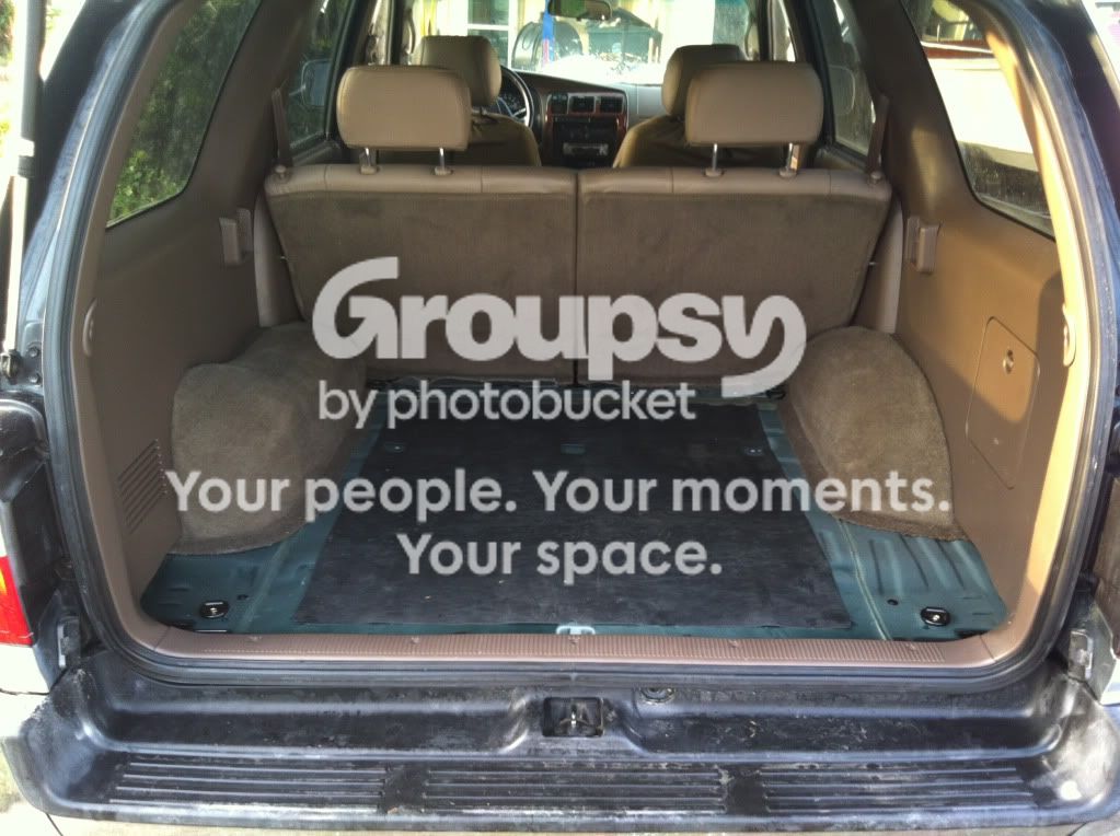

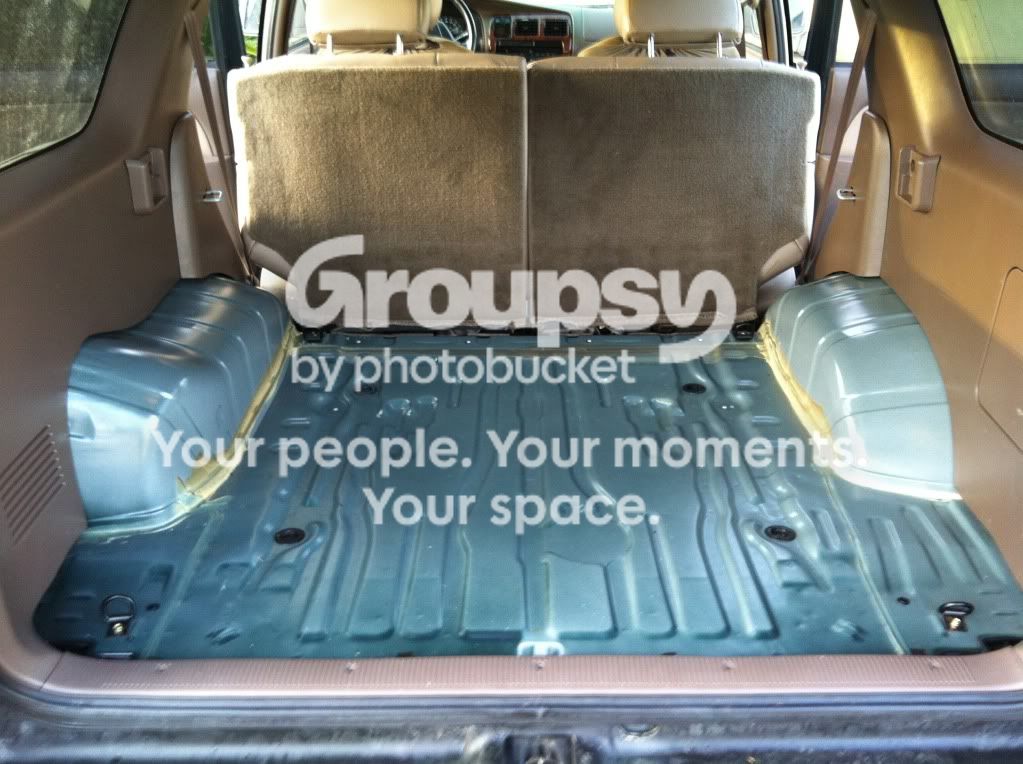

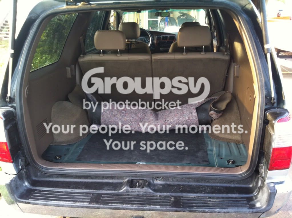

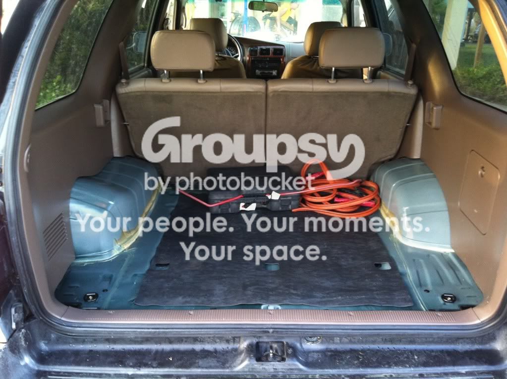

While wheeling in galveston a few weeks ago, I realized that the rear was still leaking. Fed up with it I decided ripping only the rear carpet out and then replacing it with something - thus Kolby's carpet mod? is underway!!! I'm planning on eventually building a storage area back there.
IMG_0315.jpg~original
I took a carpet knife and evenly separated the carpet from the rear seats.
IMG_0316.jpg~original
IMG_0317.jpg~original
IMG_0319.jpg~original
In the meantime I strapped down a tool box.
IMG_0321.jpg~original

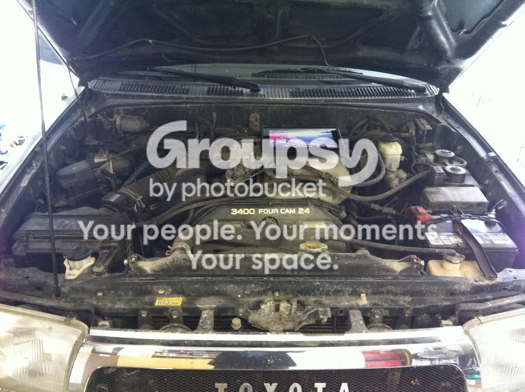

And back to the engine problems, it seems to have recovered from me flooding it and the new o2 sensor just fine. Feels stronger then before! Well maybe...
IMG_0329.jpg~original
