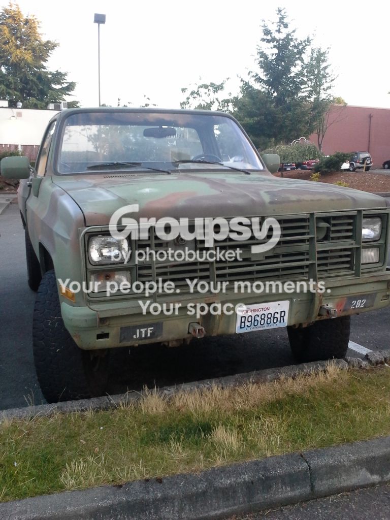

1,000 "Whose Line is it Anyway?" points goes to whoever can guess what I am going to do with this:
20140629_205153_zps14e7bbc3.jpg~original
Hell yeah, i've always wanted an old M1008, crap motor but the rest of the truck is a gold mine for a beefy crawler. Including the half a doubler bolted to that TH400.
Steal the axles off of it. Or build the bed into a trailer. Or both.
Yup, axles, D60/14B 4.56 gears. Normally a Detroit in the rear. Not this one though.
Previous owner put a 350 in it, borerd .030 over with a light cam. Needs a tune up and the carb adjusted. Not a race truck, but it does scoot pretty decent for a 6,000 lbs pig. The plan is to use the axles and sell everything else.
