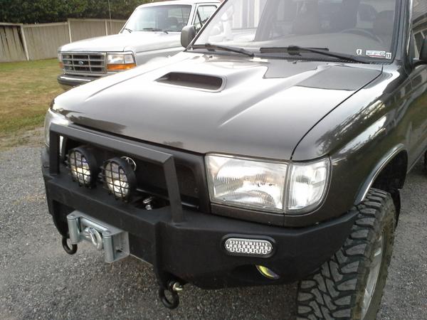

Hood is painted and looks great.

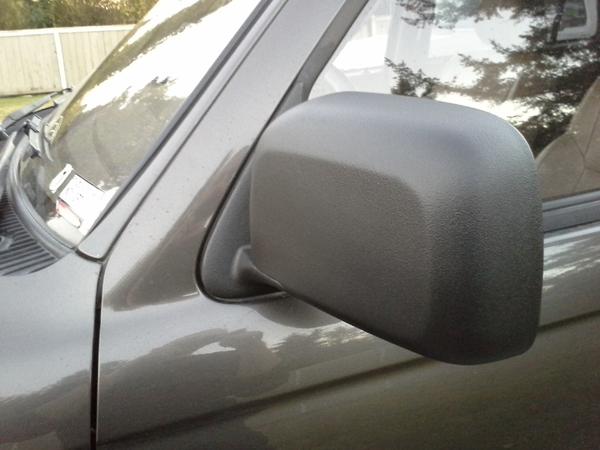

I had some extra spray on bed liner so I decided to paint my side mirrors with it since the mirrors have seen some major road dirt. I had to pull apart the door interior to get the mirrors off. But here is the result:

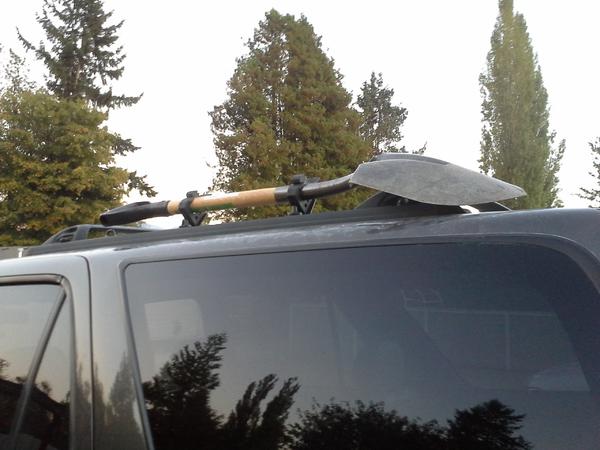

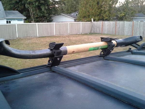

I'd had it with the shovel bouncing around in the back with no real way to secure it because I still haven't built my rear draw system. I made a couple of these little boogers:
I used a couple Quick Fist clamps that I had left over from my 3rd Gen P/U.
Holds it nice and tight. If someone decides to steal it then I guess they needed it more than me...

I got a deal on a sport hood. The hood itself was $100 then I had to buy the insert crap for around $175 then $250 for paint. I got a hook up on paint because small business body shops get screwed. Did a cash deal.

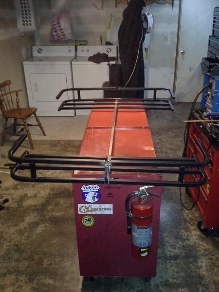

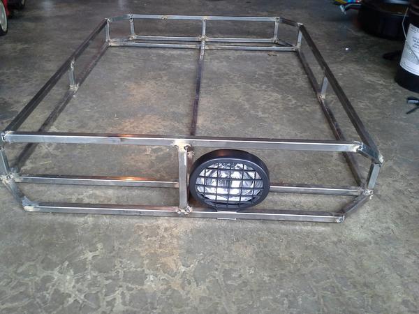

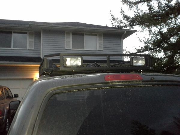

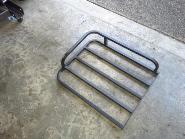

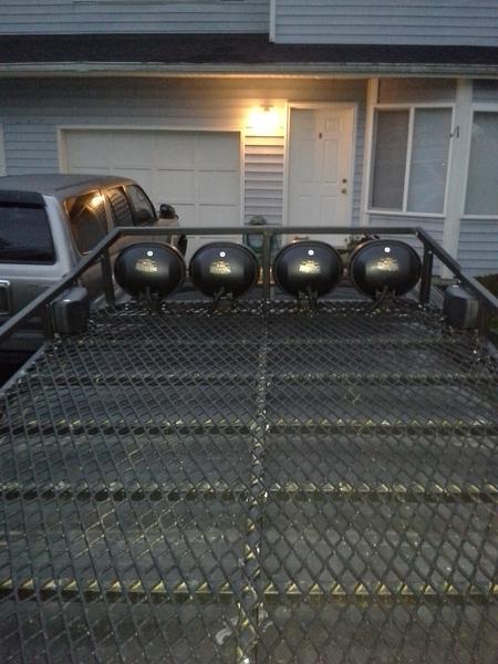

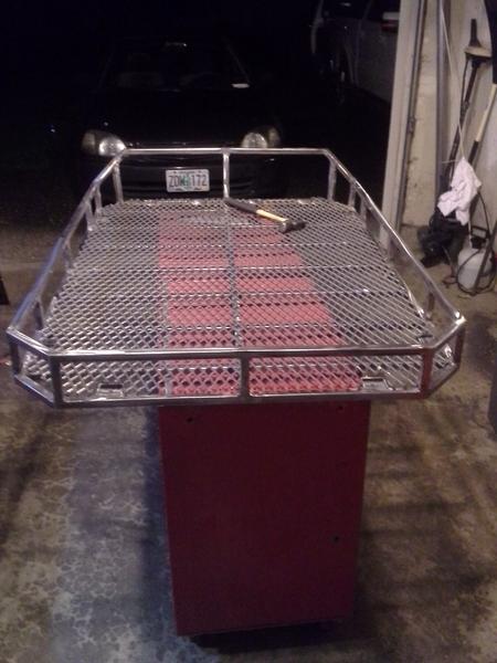

I've been working on my roof rack for about 4 days now. I started with a couple ATV Cargo Racks from Harbor Freight.
I started with this:
Then this:

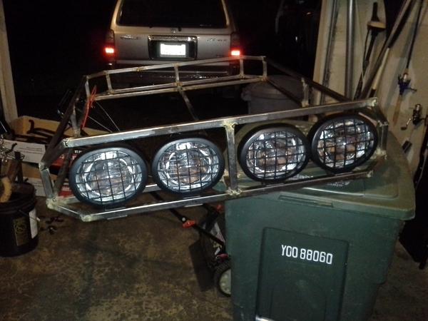

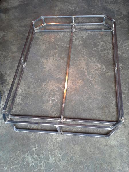

Then, I said **** it and didn't use the ATV Racks at all and started fresh.
Seriously pissing off the neighbors here.
I will need to aim them properly but the above shot shows the range of them pretty well. They lights are from Harbor Freight as well. The reason I picked them is because they actually had great reviews and I can replace all 4 lights 6 times for the price of 4 PIAA.
I still need to put expanded sheet metal on the flooring and put in the cross bracing. I will use bed liner on the whole rack. I am also planning on installing some lights for the sides and the rear.
Then this:

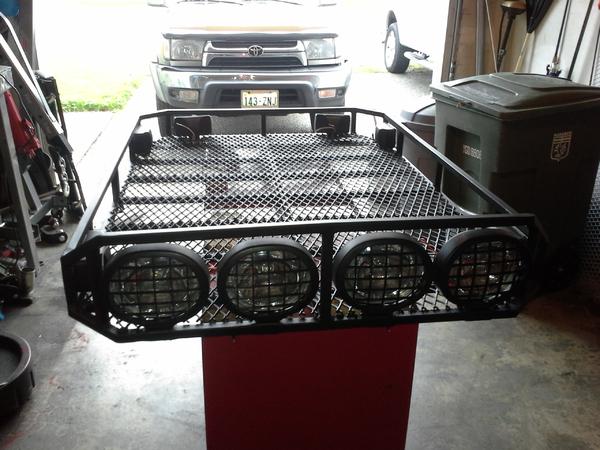

Well, I didn't leave as planned last week so I had some time to work on the roof rack. I won't be able to finish it until this next week end unless things don't go as planned.

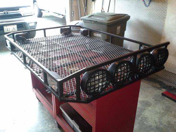

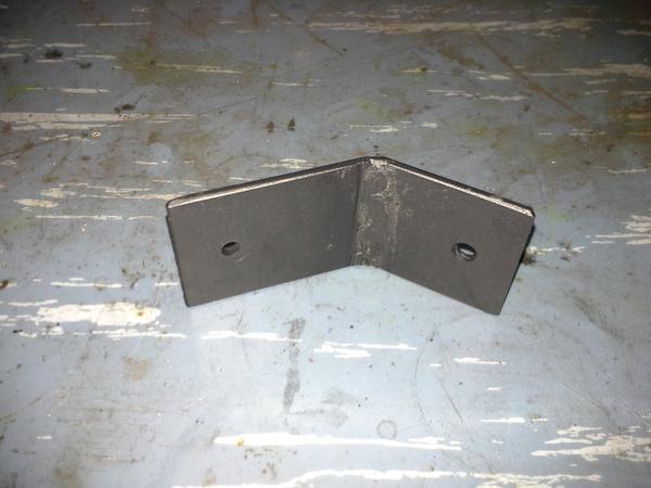

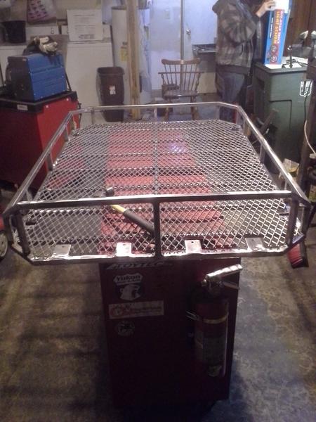

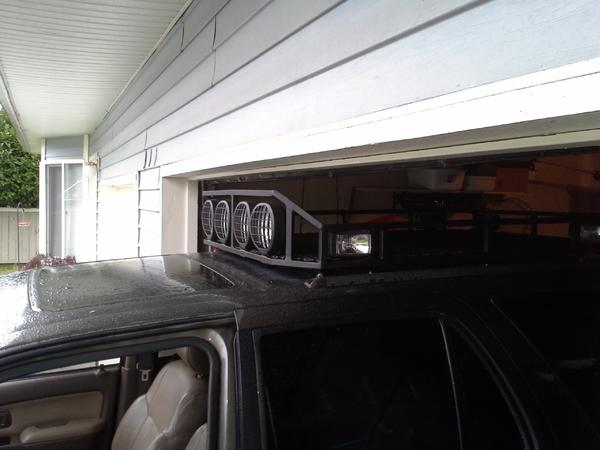

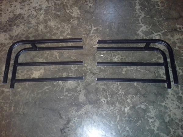

I picked up the side and rear lights and built brackets for them. I also grabbed some 3/4" 9 gauge expanded sheet metal for the floor of the rack.

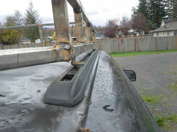

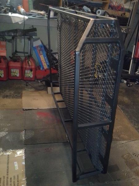

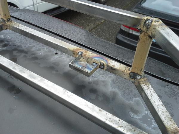

I spent most of today grinding down the welds and building the mounting feet. I chose to attach it the the factory roof rack base.
Here is the mounting feet. This was for mock up for measuring for the middle mount.

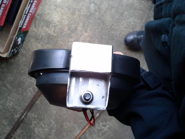

The side/rear light mounts.

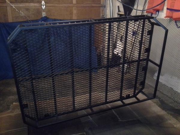

After I spent the day grinding.
2 1/2 cans of Duplicolor Spray Can Bedliner. Still need another can for touch up.
I will run conduit for the wiring and drop thru the hole in the factory roof rack base for power. Overall I am pretty satisfied with it.

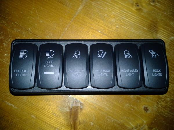

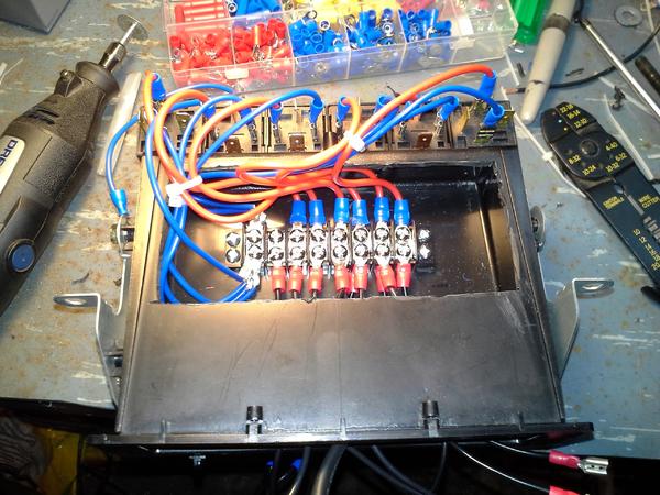

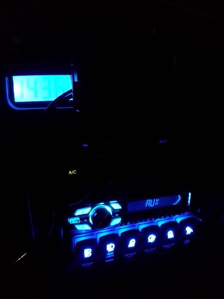

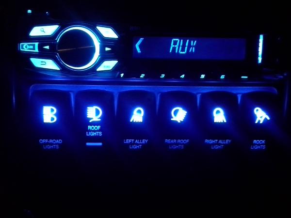

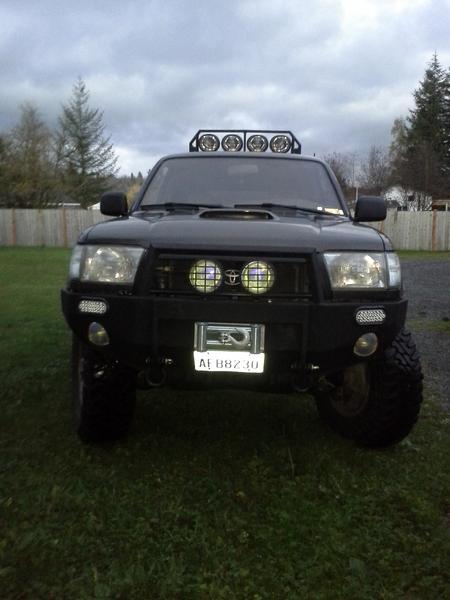

Well, it's damn close to being done. I still need to install the real Rocker switches. They should be here tomorrow. I picked out a 6 gang holder with Contura V Rockers. From these folks: OTRATTW I'll post some interior pictures when I get them installed and the dash lights come in since I also orders those along with some LED dome and cargo lights.
I don't have any good day pictures because I have been going to work and leaving work when it is dark outside. I pinky promise, as soon as I get a chance I will get some day time pictures.

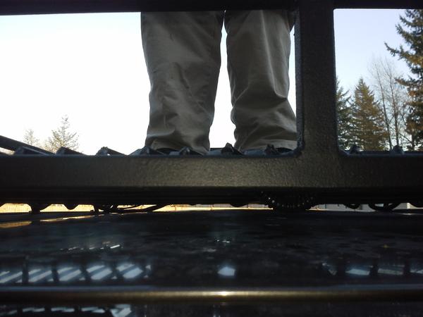

Anywho, here is some porn for you.
Yes, this is my fat ass standing on it, on the truck.
Wiring for relays and terminal board. Also wired for future mods. Still need to install a few diodes for it to work exactly how I want it. I used a DIN pocket that came with the head unit stereo kit. It will work wonders to mount the Rocker switches to. I bought a secondary fuse block and mounted it on top of the factory fuse block. I'll get some picture of it if anyone wants to see how I did it.
Barely fits in the garage still. We are moving in the next 5 months. Hopefully, (cross fingers) I will have a shop and not a closet, I mean a one car garage to work out of.
Reminds me of Jurassic Park. I am just waiting for a T-rex to come out of the dark and try to **** with my 4Runner.

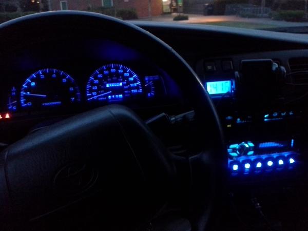

Oh, and **** everyone's clock color changing mod. I put a voltmeter in mine. It's a bad angle but it reads 13.80VDC All the dash lights are going to be blue, so this matches very well. This will go well with the dual battery setup when I get off my ass and do it. Future mods include a CS-144 Alternator for all the extra crap.

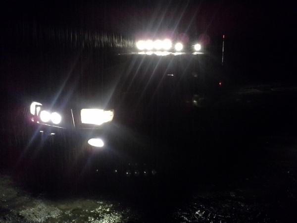

Sorry for the following ****ty pics. Same excuse as everyone elses.... 5 sec shutter, night pics, blah blah blah.
Low Beam
High Beam
4WD Daylight

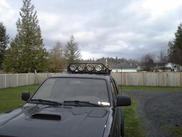

Over all I am very happy with the roof rack/basket. I need some better day time pictures. If I did it all over again I don't think I would change a thing.

I got the dash LEDs in last week.
