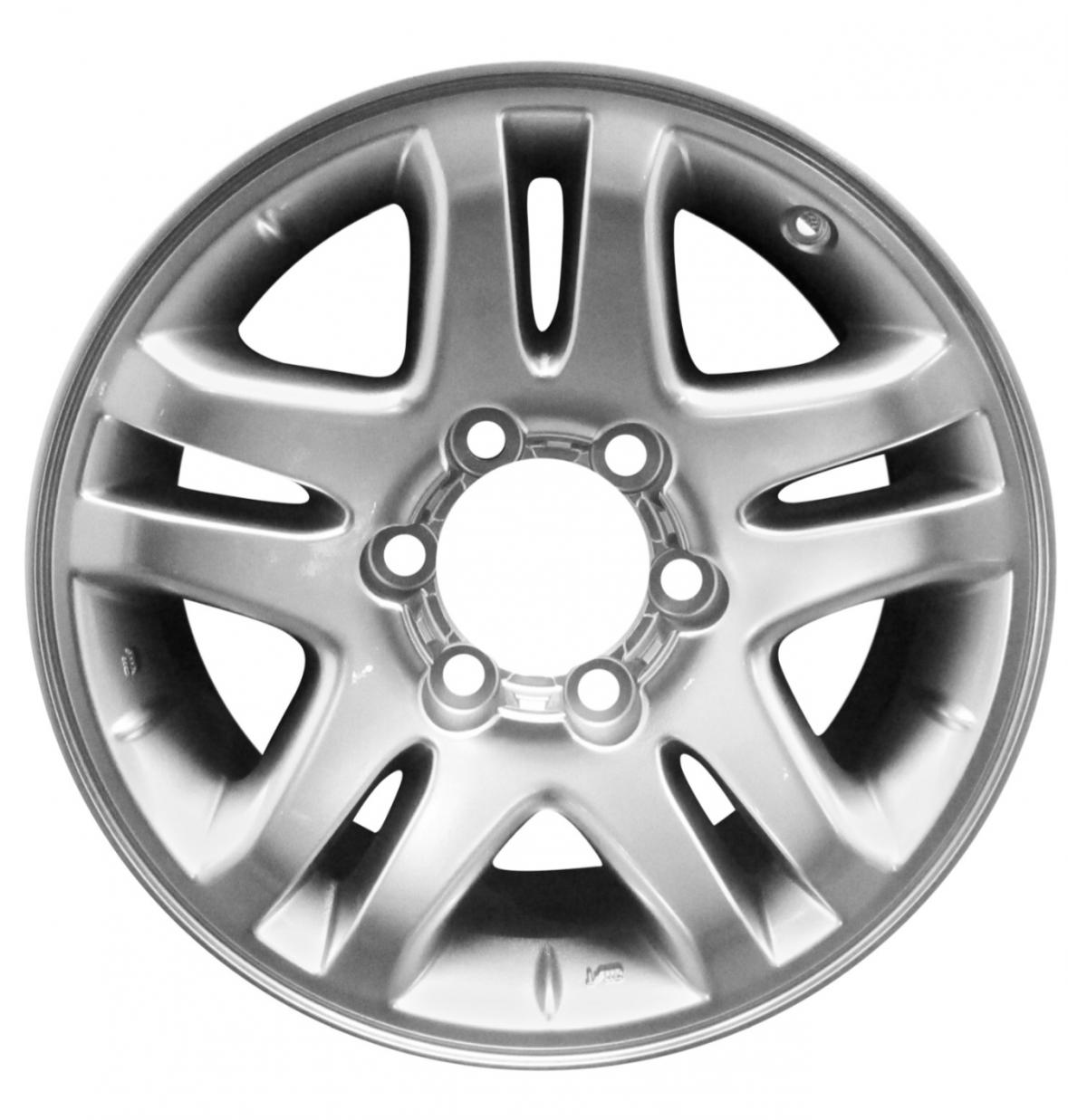

These are my first choice as they look amazing on KLFs red ‘85 extra cab (build on mud), and my second choice are the 5 (10?) spoke Tundra/Sequoia 17s. Those would let me run the 255/75-17 BFG muds that came oem on Rubiclones. These tires are all over Craigslist for about $250 for a set of 4 with 70% ish tread. I could easily buy a couple of sets and be done with tire buying for a few years. They are like a 32x10.50.

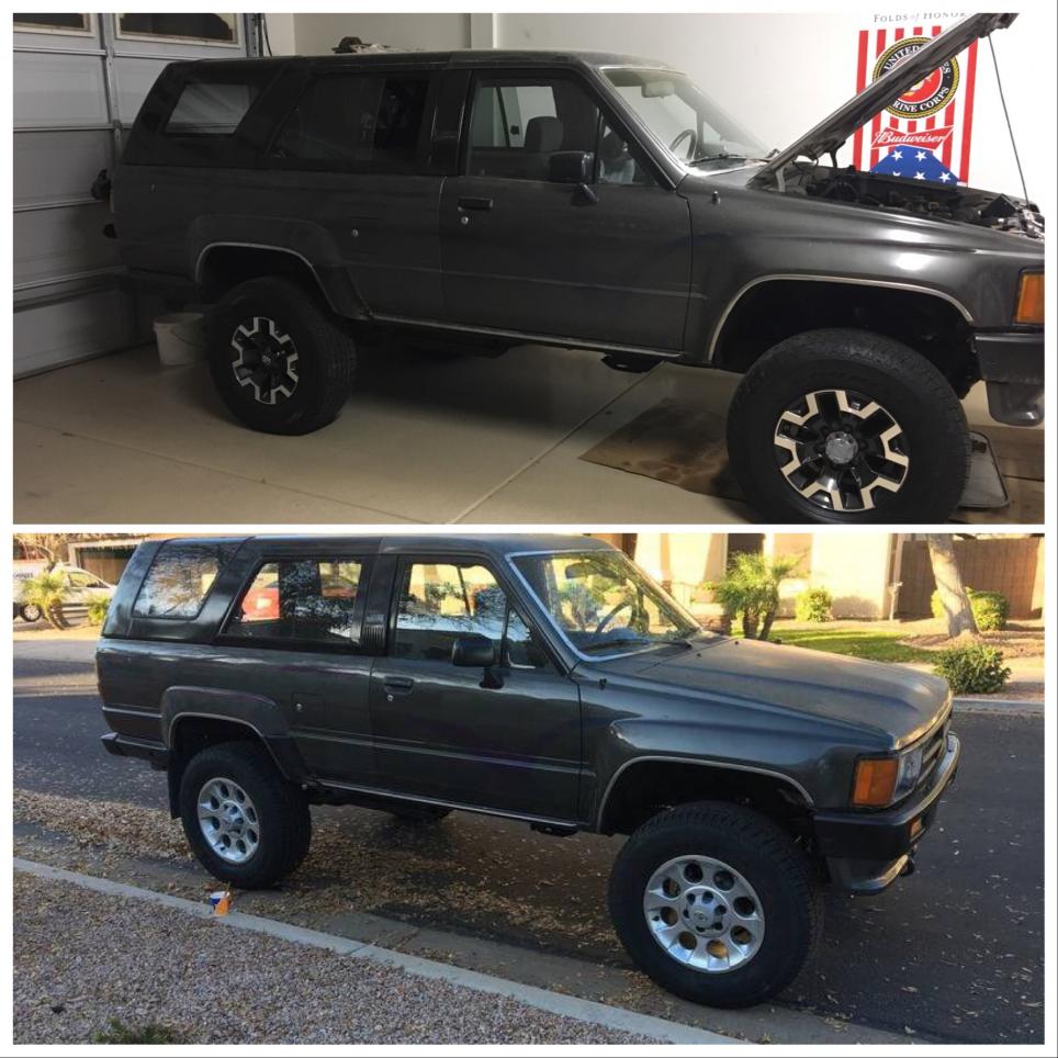

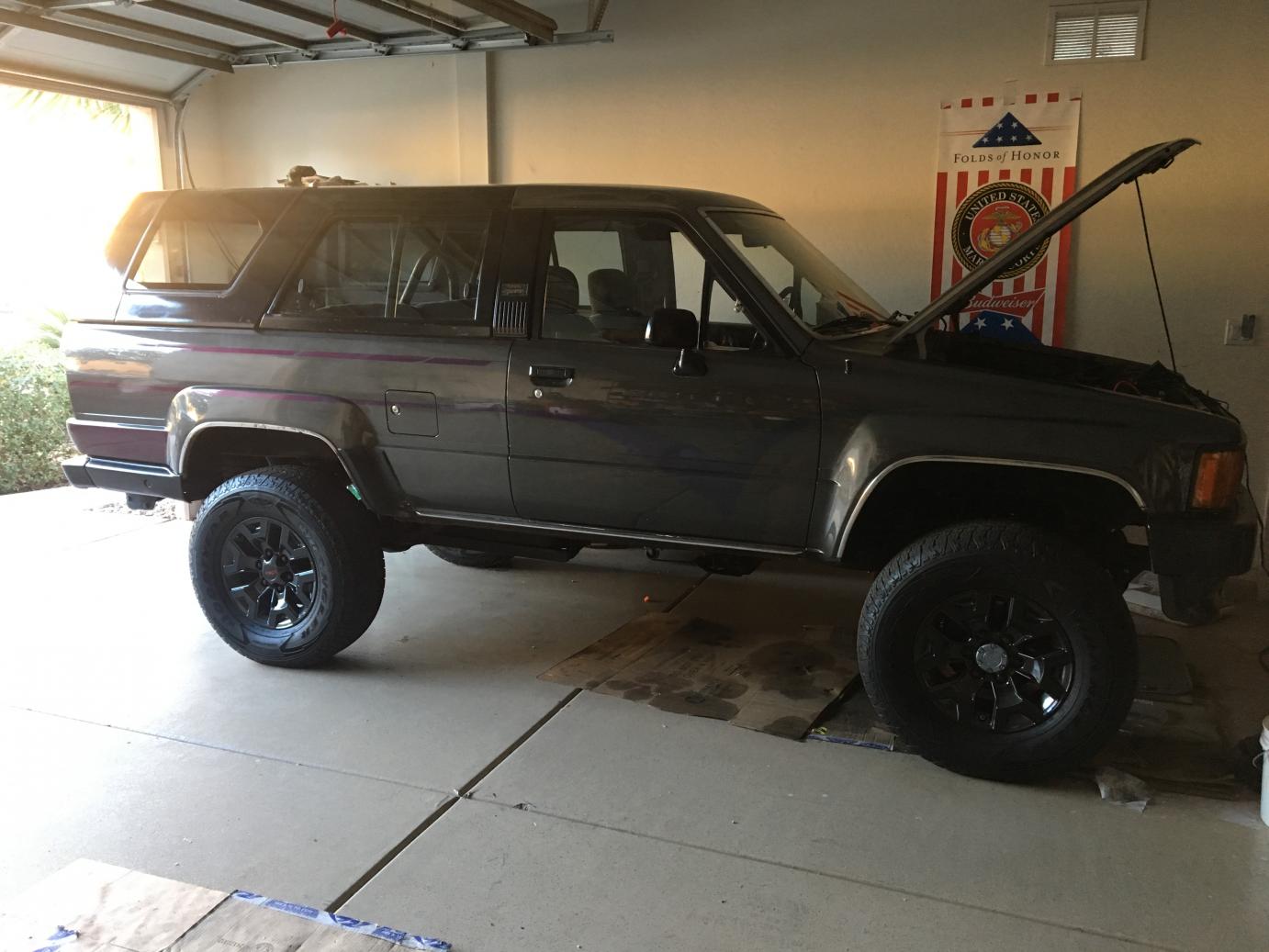

I currently am running the 16" TRD Tacoma wheels. The front passenger BARELY touched my tie rod. I put on some 1.25" spacers and no problems, i even think it looks better! I have since blacked out the machined portion on the Taco wheels and love it even more! I'll probably stay with this setup for a while.

Looks great with them blacked out! I had my Land Cruiser at the dealer the other day and noticed some brand spanking new TRD wheels with oversized KO2s on them. Would love those on the ‘Runner, but I didn’t even bother asking the price... didn’t want to throw up!

I ended up with a set of ‘05 ish Tundra double 5 spokes like I posted a pic of above. I had a shop mount 255/75-17 BFG MTs on them today. That experience reinforced why I do as much of my own work as I can... they broke 1/2 of my center caps, the trans shifter cover, and it all started out with seeing the clown undoing the nuts on my locking hubs to remove the front wheels!! What kind of idiots are allowed to work on other people’s vehicles??
